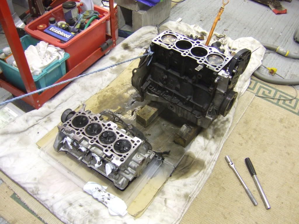

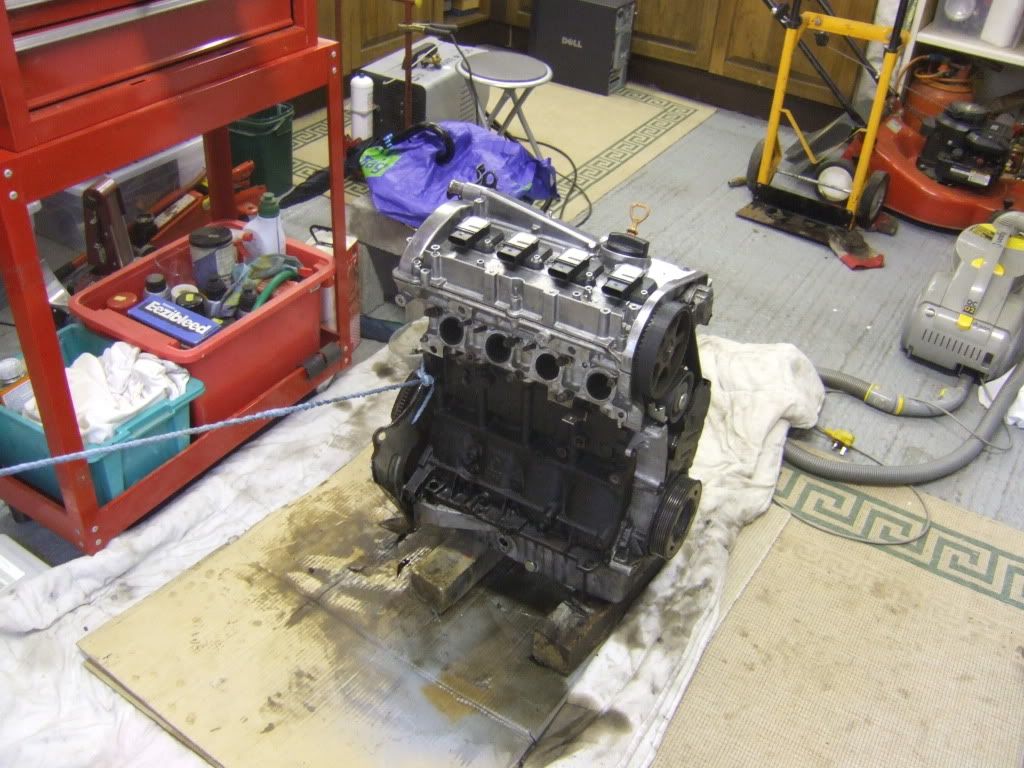

Big update I picked up a new engine today off a member on here.
Engine had covered 50,000miles before rebuild & 14,000 after.
BAM block bored out to 1.9
ADR largeport head
Large race valves
Forged crankshaft
Forged JE 1.9 pistons
Forged JE Rods
It also had recently had new cambelt and waterpump. And I also got a few bits I can sell on like G60 flywheel vr6 clutch, 225 injectors, inlet manifold.
Jul 4, 2010
2,170
Cambs

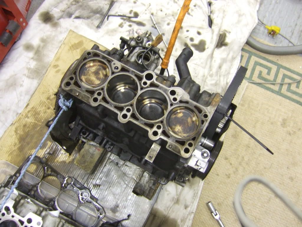

Whipped the head off to fit a new head gasket as there was a tiny oil build up on the corner. Not sure if its leaking but better to be safe than sorry!

Yeah I was just looking at yours and mine look different.. Do they look different depending on what compression ratio they are? Yours look like they are higher comp than mine therefore having bigger cutout for valve clearance.
