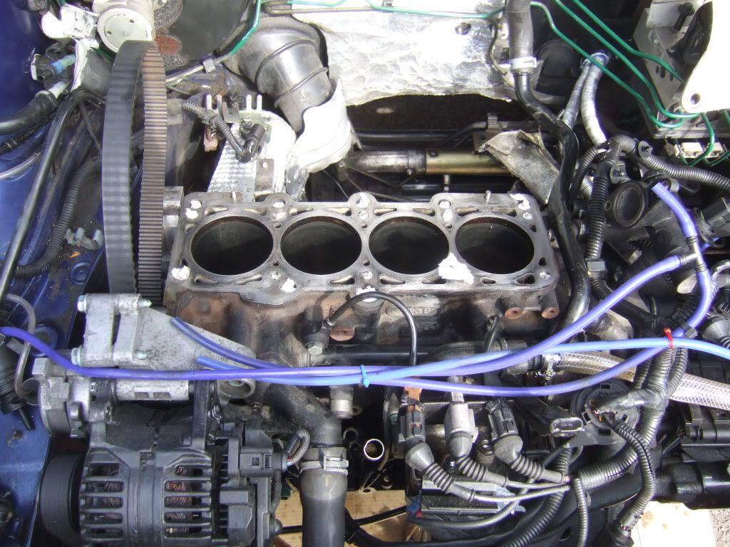

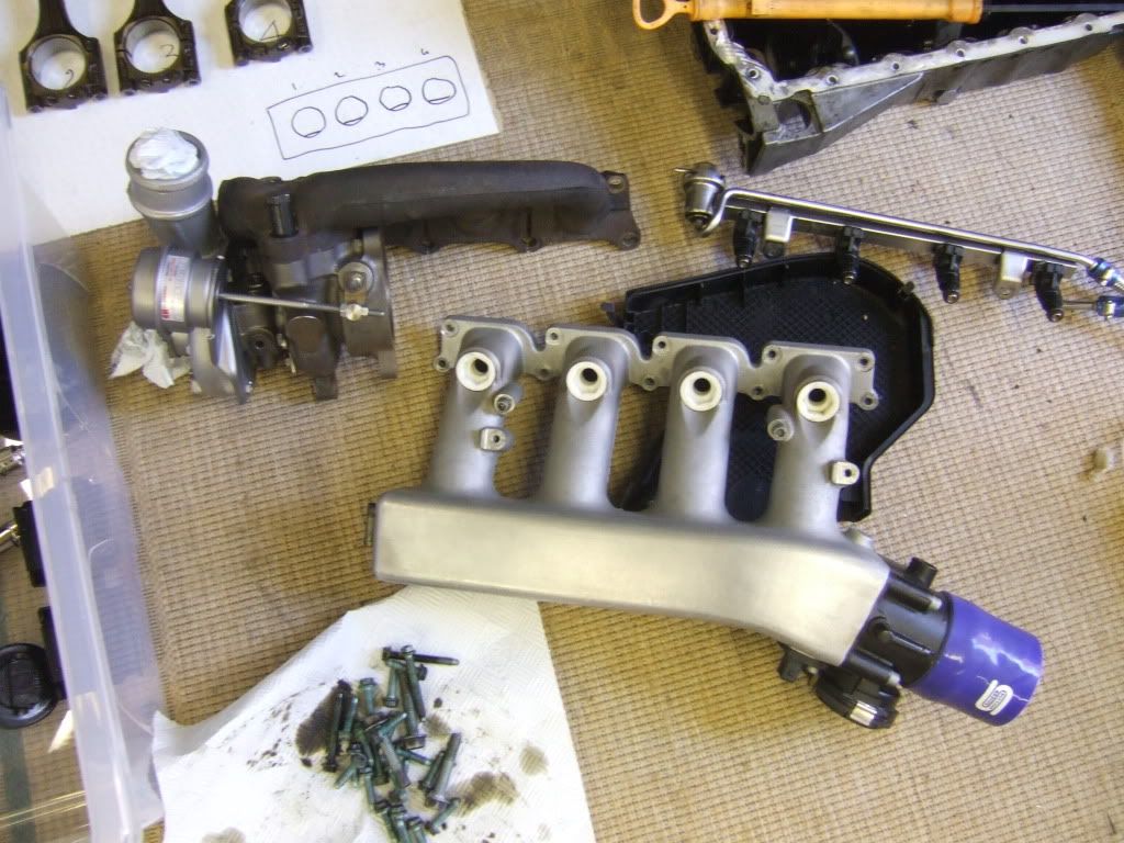

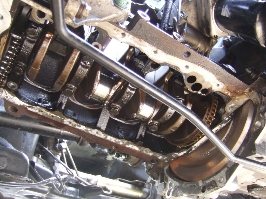

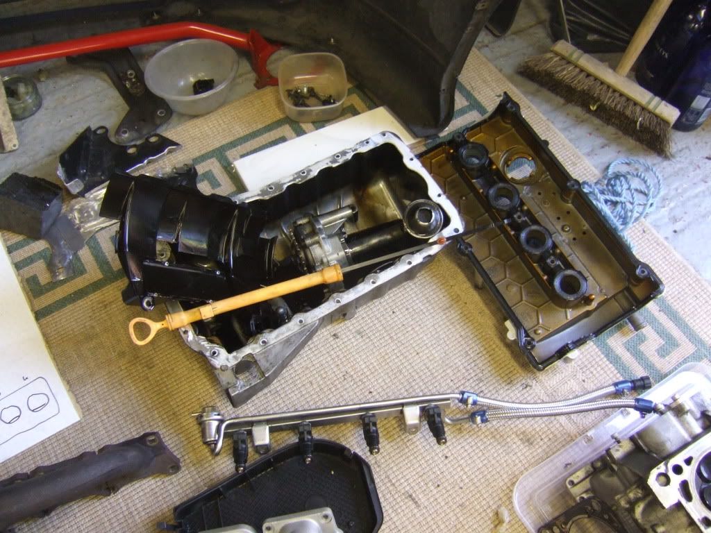

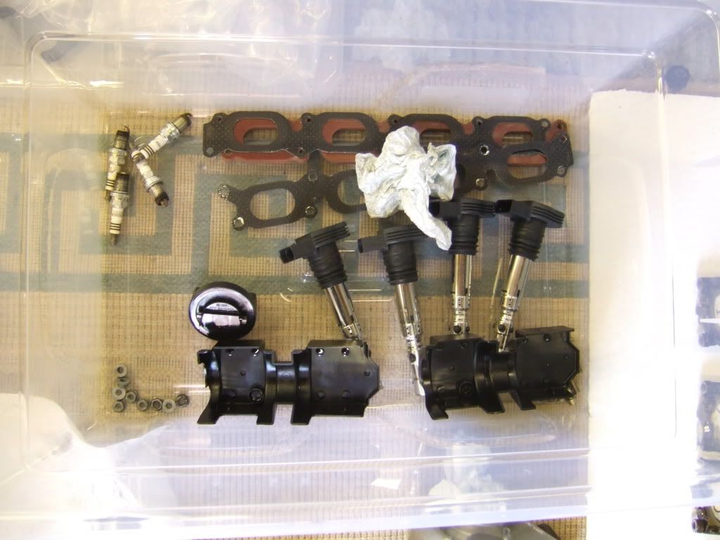

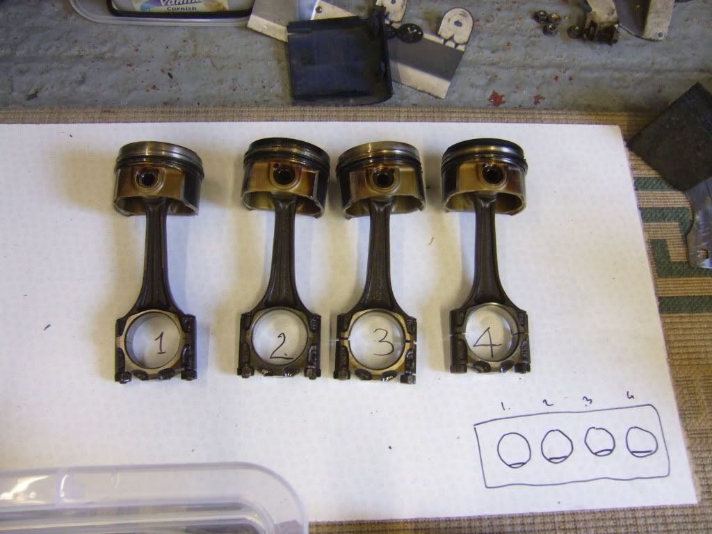

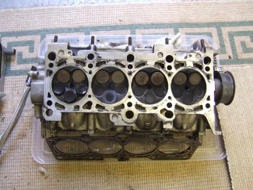

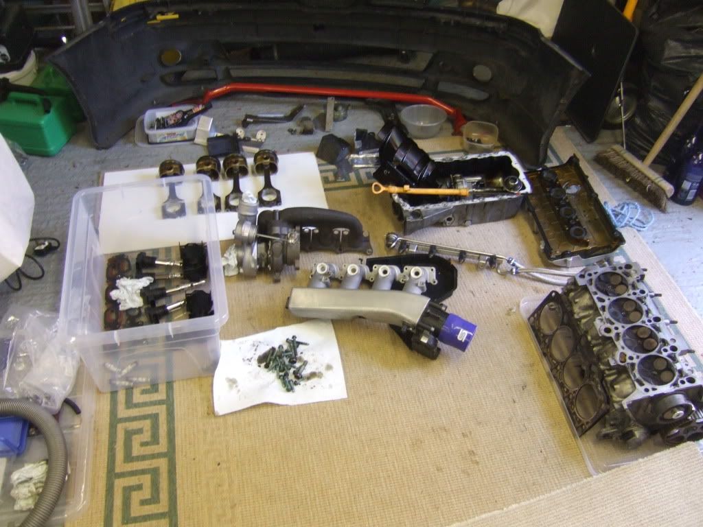

Decided im going to change the rods now to be safe! Stripped the engine down today to see if I have any other internal problems and it all looks great. Bores are great no major scratches and no lip what so ever. Pistons look fine just need a scrub.
For peace of mind I am also going to replace-
- Cambelt
- Waterpump
- All the gaskets
- Valve stem oil seals
- Deglaze the bores
- Clean up and relap the valves
- Clean up the pistons and fit new rings
I am also going to get some green 440 injectors and sell my LCR ones as I dont think they will be sufficient.
Cant think of anything else so heres a few pics!
mate fair play thats a hell of a job im not brave enough to do that myself! safty first good idea changing the rods so is it a k04 hybrid or not???
Yeah it is mate got the spec from crt the other day, K06 billet compwheel & enlarged coldside housing too fit, ported and enlarged wastegate uprated seals thrust bearing ect.
Blimey James I didn't realise you were doing all that work! I loved doing my internals. Great engines to work on too :D. Worth doing pistons at the same time?? I know it may seem OTT but you get addicted to power and it would be an arse to take it all apart again in the future to big turbo it ;)

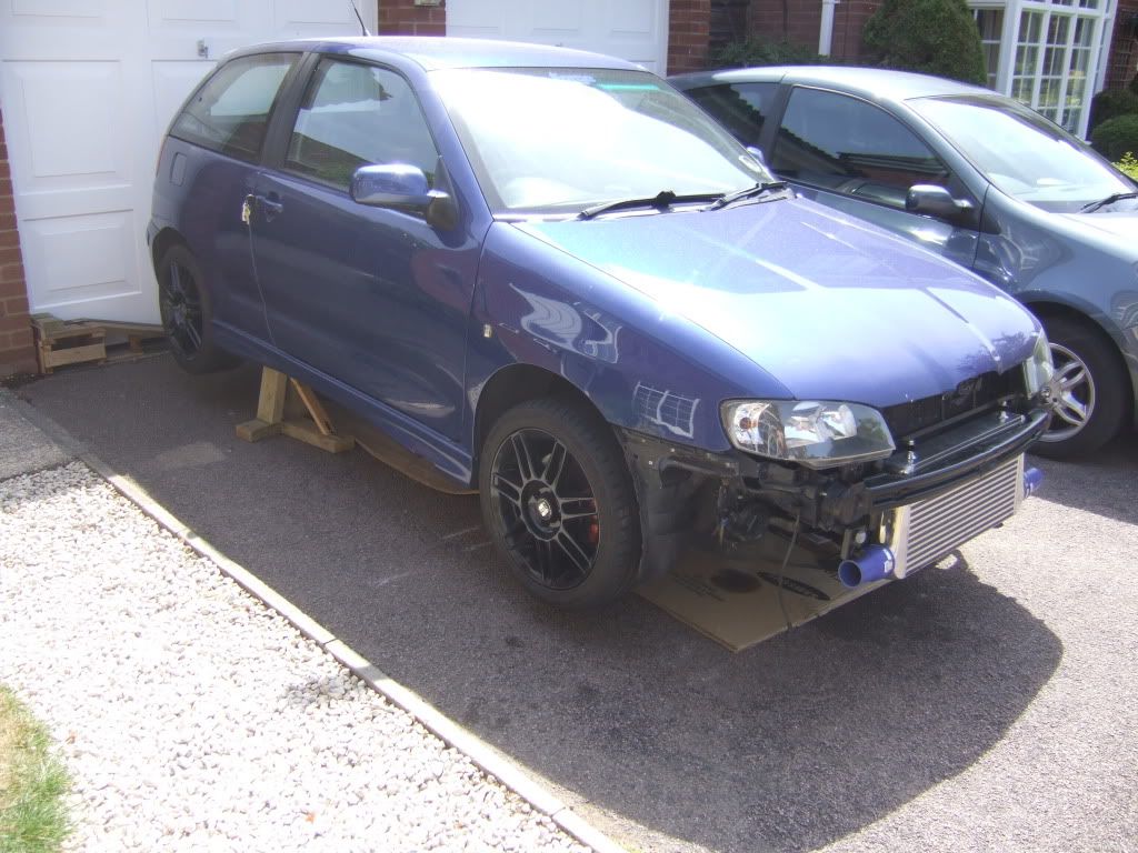

Ghetto axel stands ay! Nothing needed, just litrally unbolt it from underneth and mount it on top.. just need too drill a hole in the firewall to run the cables through, It will all make sense when you take it all off.
Yeah really easy engines too work on had it stripped in a couple of hours. I havent got the money for pistons at the moment plus mine look in really good condition & they are forged mahle piston standard and are apparently good for big bhp.
None of it was planned I asked CRT to just rebuild my turbo too standard and the sent it back hybridized.. I only payed for a standard rebuild and I got a good deal on that too so I didnt mind.
Just means I have to save up more money for the rods, injectors ect. which is going to delay it getting finished a month or so :(
