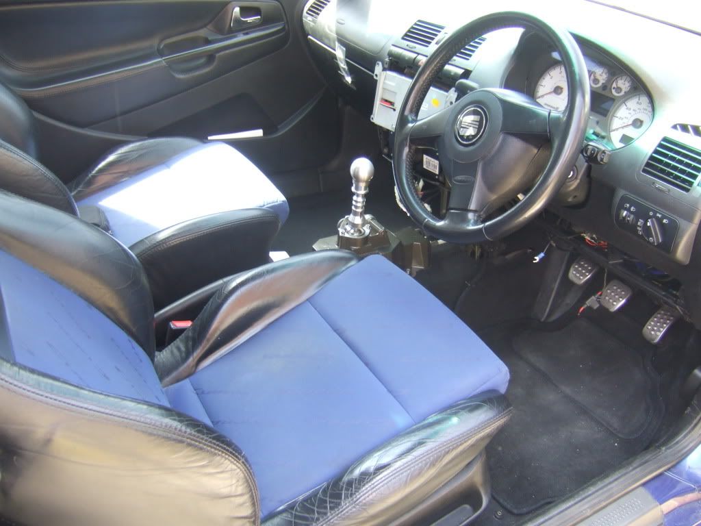

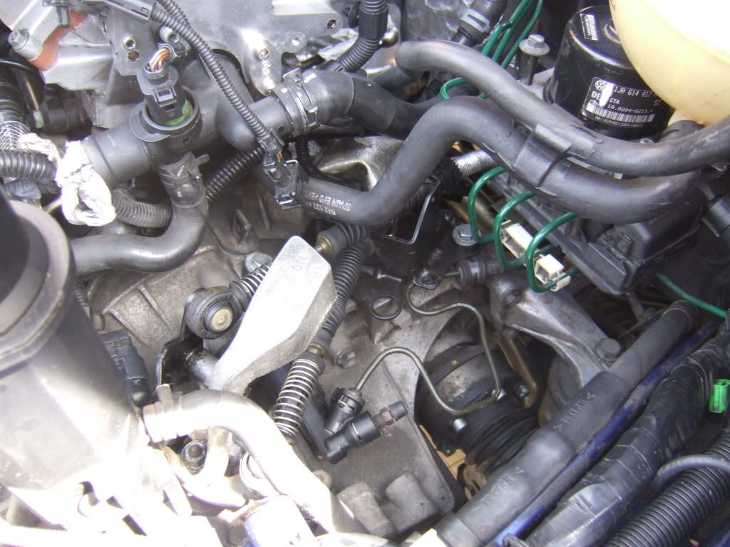

Noticed my gear cables have melted slightly so wouldnt mind seeing some pics of your top mounted shifter as i may do that too.
Did u make that bar that youve bolted your fmic to?
Cheers mate!
Yeah ill take some pics for you tonight if I get a chance, I have the cables running through the right hand side of the passanger footwell so they are well away from the the exhaust/turbo when it is all fitted.
Yeah I mocked it all up and got the old man to weld it then gave it a lick of paint come out really well. It was actually made from an old stairgate!

Also wanna see pics of the shifter
My gear cables are badly melting lol so its something to have on my to do list for sure.
where do your cables go from the passenger footwell??
me too me too.
i will have a look tonight to see if i can figure it out myself, did you just drill 2 holes in you're bulkhead?

1 big hole, easy enough too do.. did have to make up a small plate to rotate the shift cable bracket on the box.. I could of done it more central and not had too move anything but I will be fitting a 3" tip to my k04 so I needed as much space as possible

I cant actually remember 32mm sounds about right though, maybe a tad more. Just need enough room too fit the ends of the cables though.. it will all become clear when you take it appart

Few pics of the top mounted shifter
In the bay
And the sorry state she sits atm

Also with the shifter on top will the centre console fit back ok? Or will it have to be on show rally slag style !

I was gunna leave the shifter on show.. but I think the centre console could be persuaded to fit with a bit of modification.
