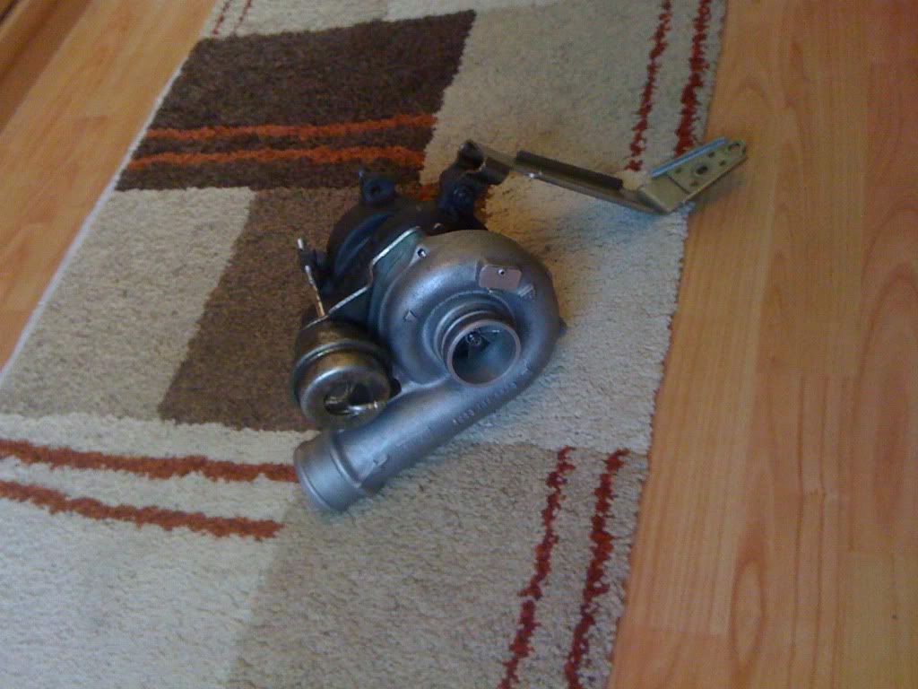

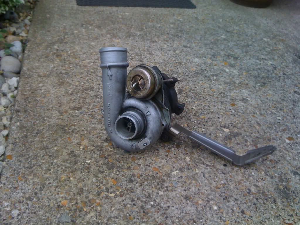

Turbo has FINALLY arrived.. looks pretty good condition only a tiny bit of shaft play but the rebuild kit and uprated thrust bearing is on order from CRT.. gunna get a forge actuator too.
Excuse the crappy iphone pics

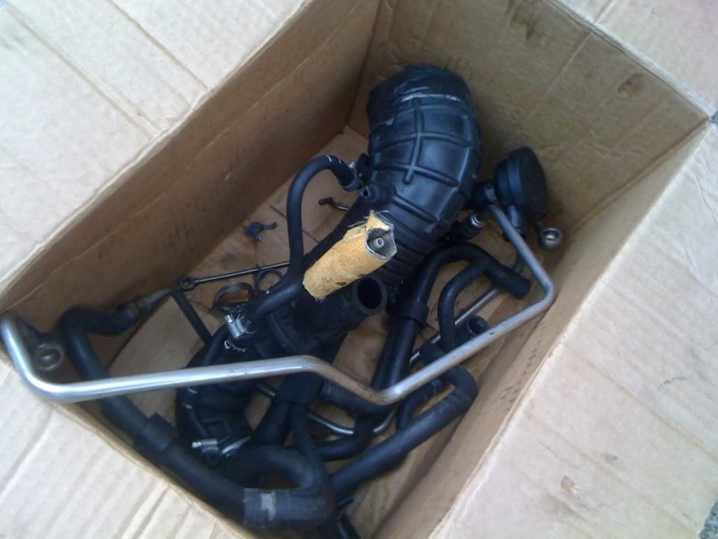

And all the bits that came with it.. oil lines ect. Dont need most of it but its nice too have everything you need rather than not enough.

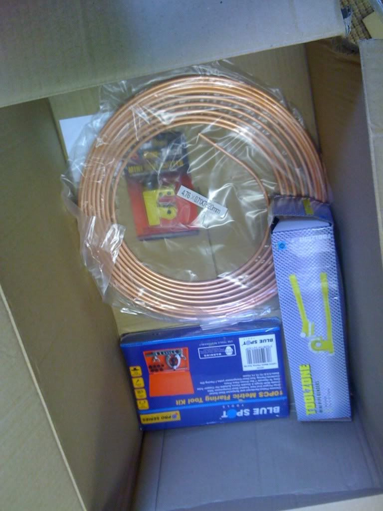

And my bits and bobs to make the new brake lines.

How are you going to do the turbo rebuild?

Mark the compressor and turbine wheel on the shaft and nuts so I can make sure it all goes back in exactly the same position.. theoretically if nothing has moved it should stay balanced..
True, unless the nut needs to tighten up more or less. :shrug:
1 way too find out! I have read 100's of bits on the net about people rebuilding there own turbos this way with no problems..
It should be tightened up to the same torque as before if it is in the same position.. I cant see anything compressing or stretching.. hmm

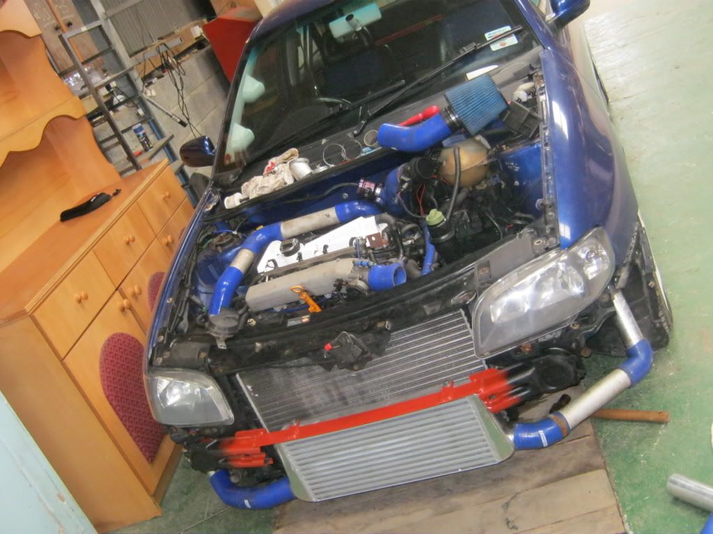

here is the modifcation i done to get my cooler on. its a little bit smaller than yours tho ha!

Yeah I was contemplating doing what you have done to allow a bit more airflow to the cooler.

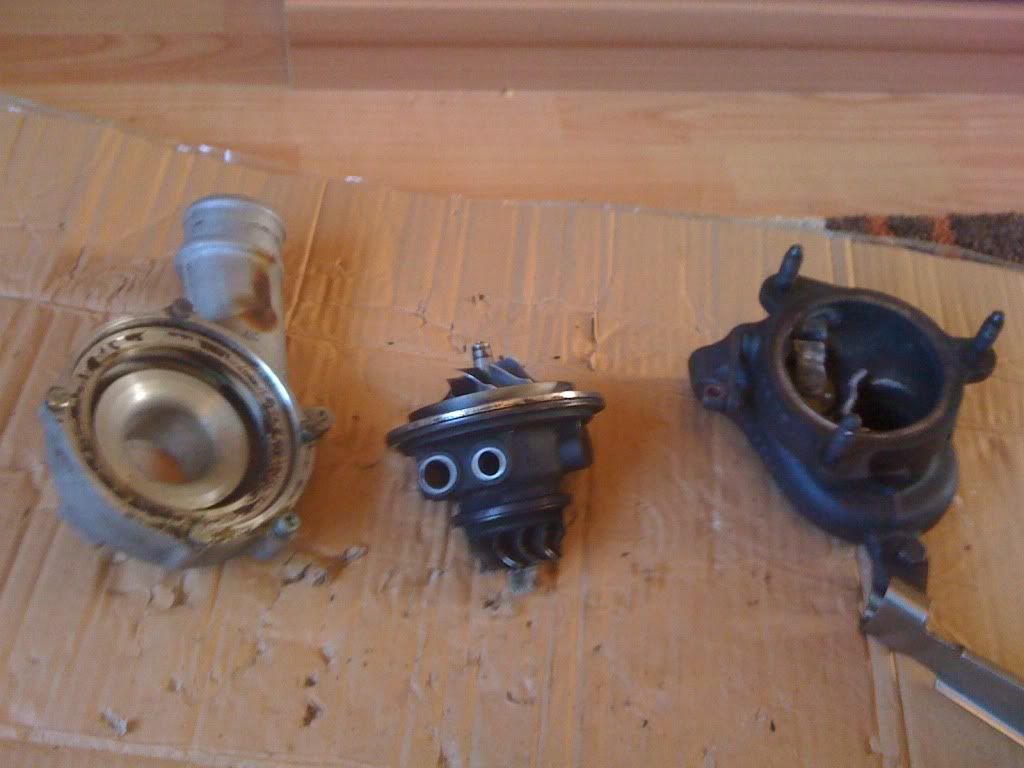

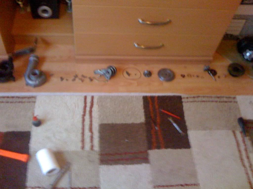

Few phone pics of the turbo rebuild.. Have decided to also fit a new compressor wheel just too be safe as well as getting it balanced..
All the new bits lined up in order to go in..

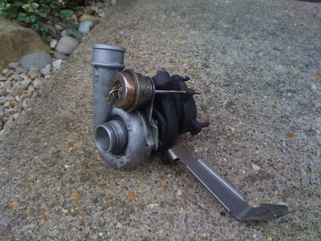

and the finished turbo feels brand new :) very happy
