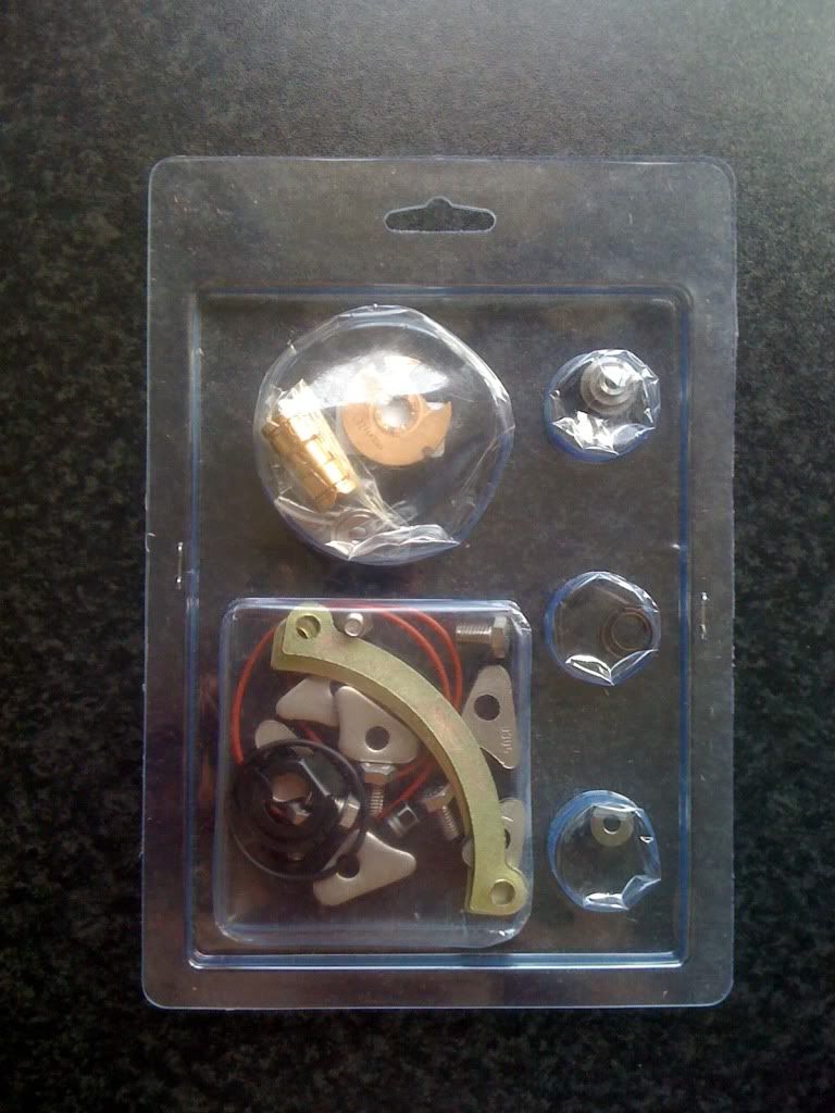

Rebuild kit with uprated thrust bearing from CRT arrived

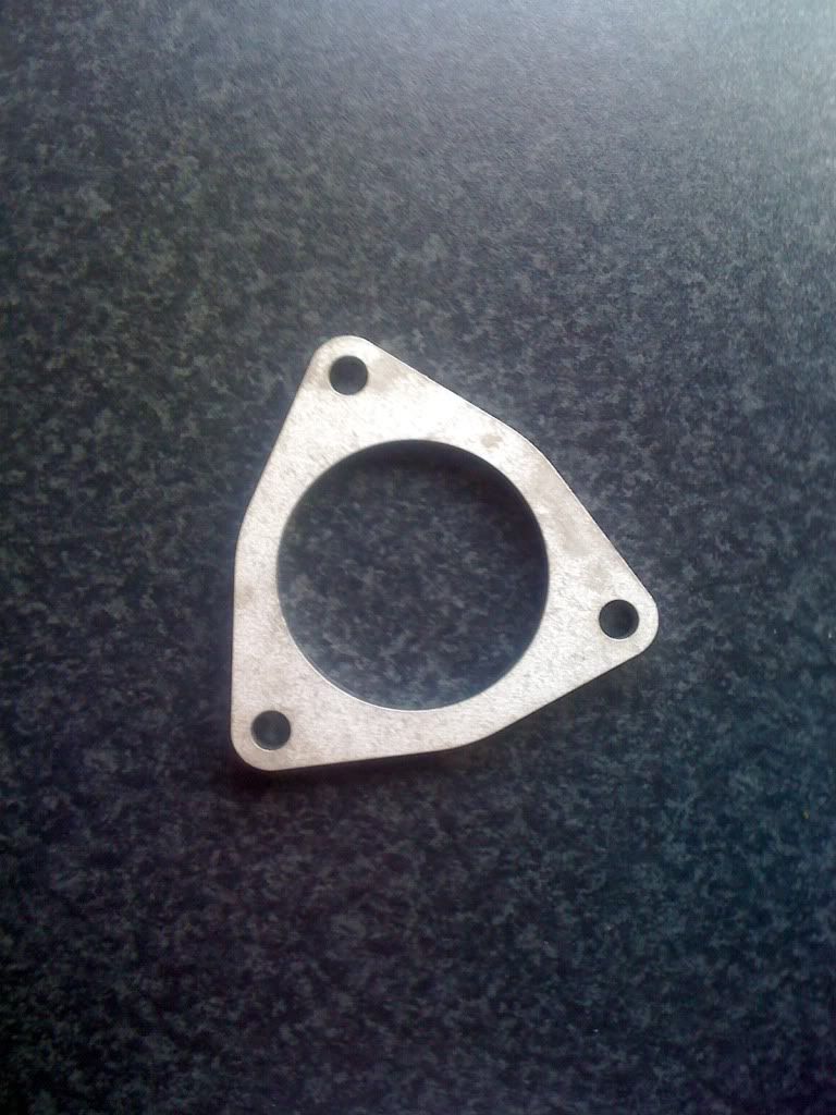

And my exhaust flange from bill
How much did u pay for thie kit if u dont mind me asking?
Called up CRT twice this week & both times they said they would get back to me in reguards the turbo rebuild kit.........hell did they, im still waiting now [:@]
Really! I never had a problem with getting hold of them, Ask for Mark Arnald he is the guy I dealt with. You can email him directly at.. [email protected]
As for the kit it was £125 with the uprated thrust collar.
You have to really know what you are looking for when rebuilding a turbo though as the tollerances are so fine.. TO ME everything seemed fine after I rebuilt mine but after sending it to CRT for balancing I found out that the turbine wheel had been scrubbing on the houseing, it was only a tiny amount but he assured me that the turbo would not function correctly being like this. There was also some other minor defects with mine.
Just something to keep in mind mate.
Hope this helps!
