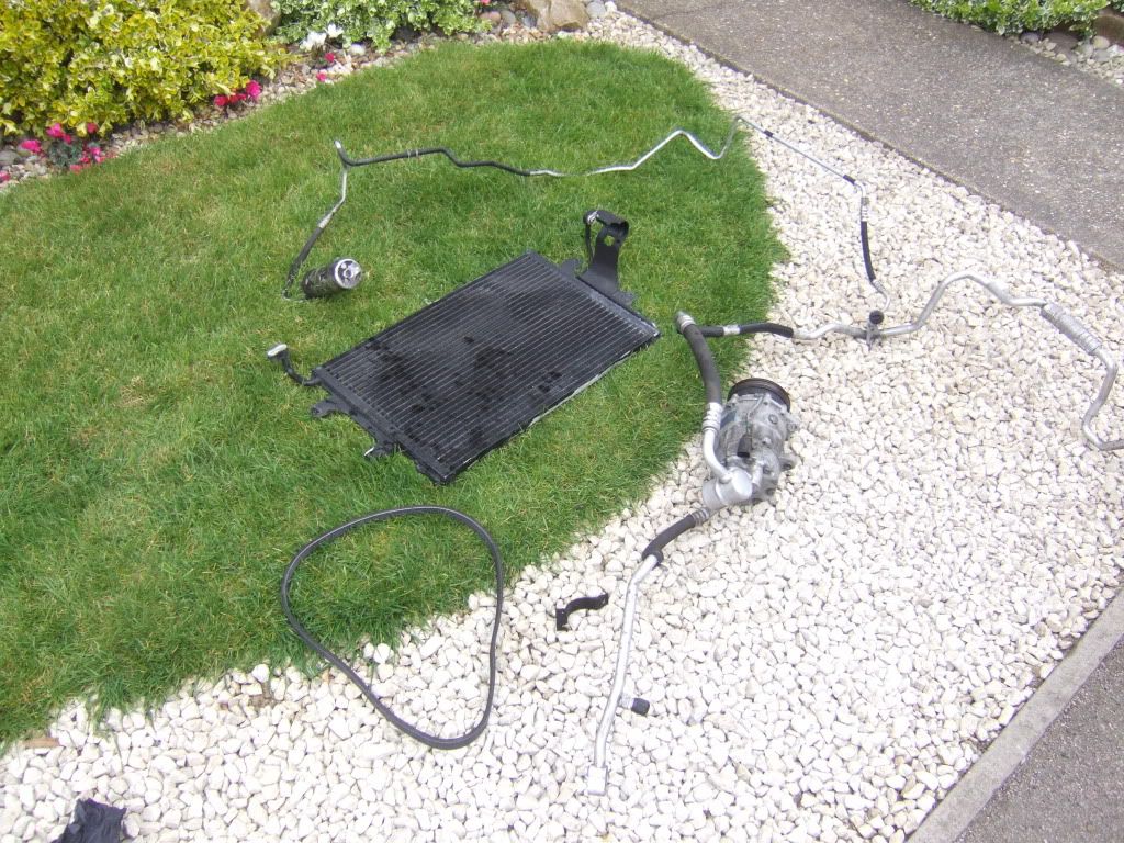

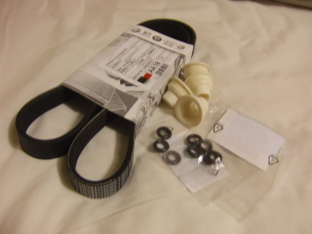

have you got the part number for the short belt as i want to get rid of my air con.
the injector seats are srewed in mate, you need a 20mm hex of some sort to fit tight and they should unscrew, they can be brittle and might snap so be careful if your doing it on the car.
part no: 06A 145 933 D
Hope that helps mate![]()

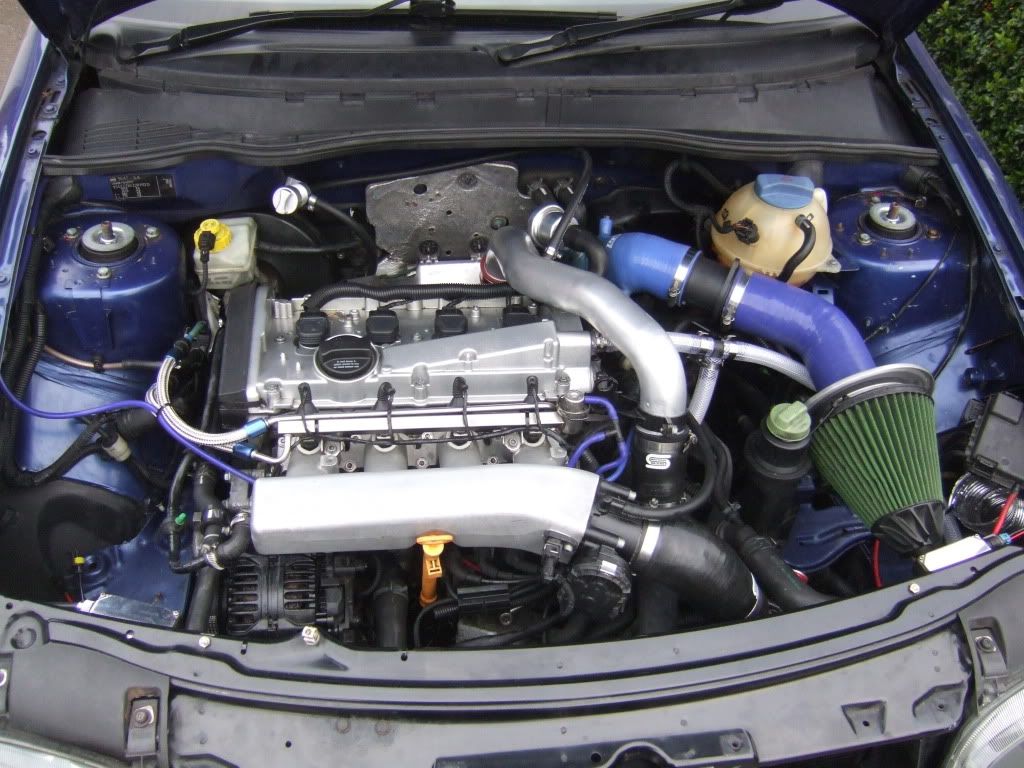

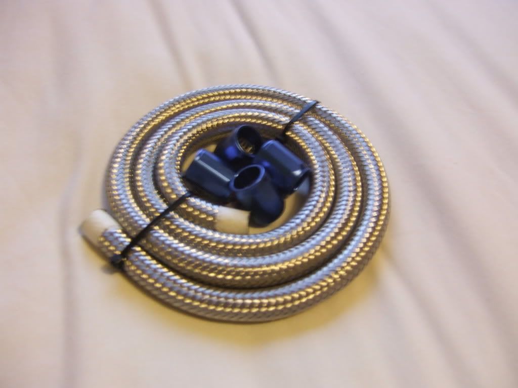

Looks good mate

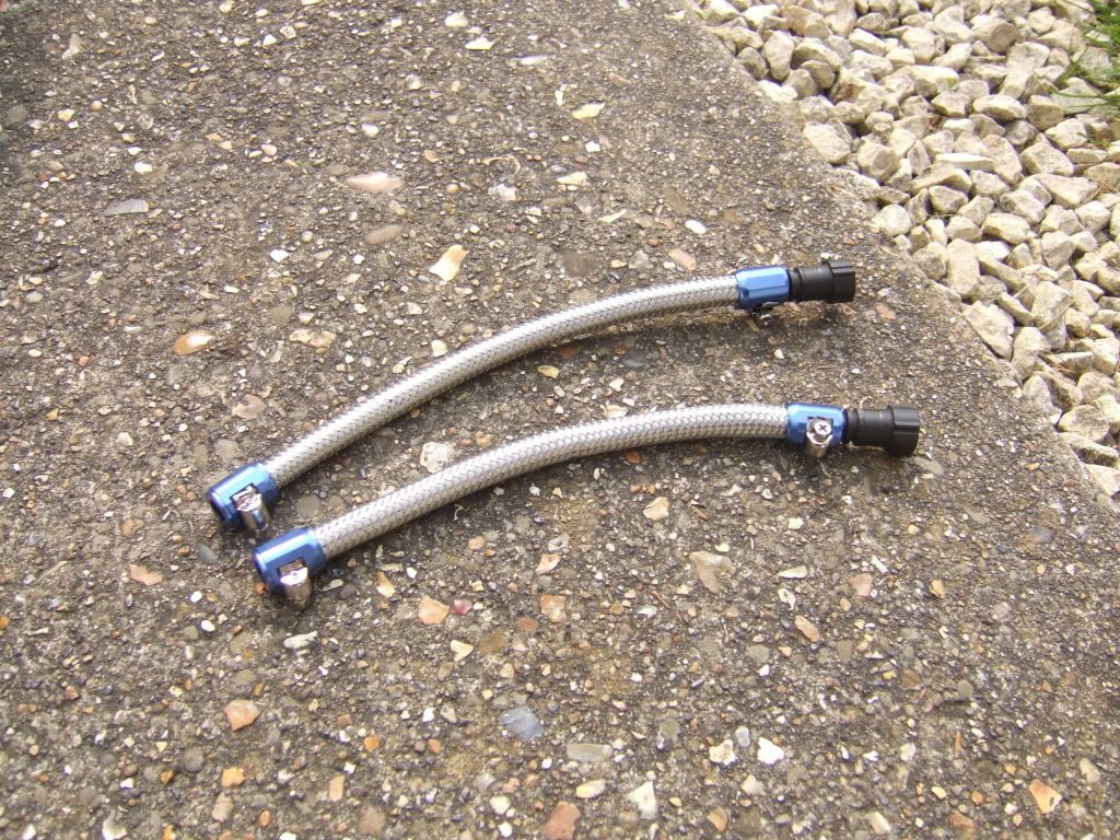

Where did you get the braided fuel lines from?
