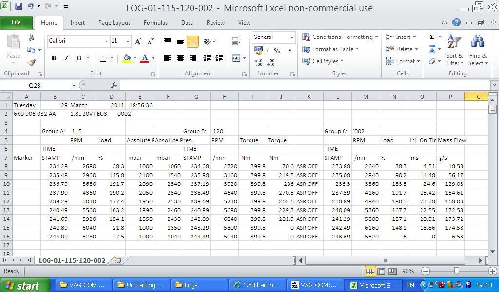

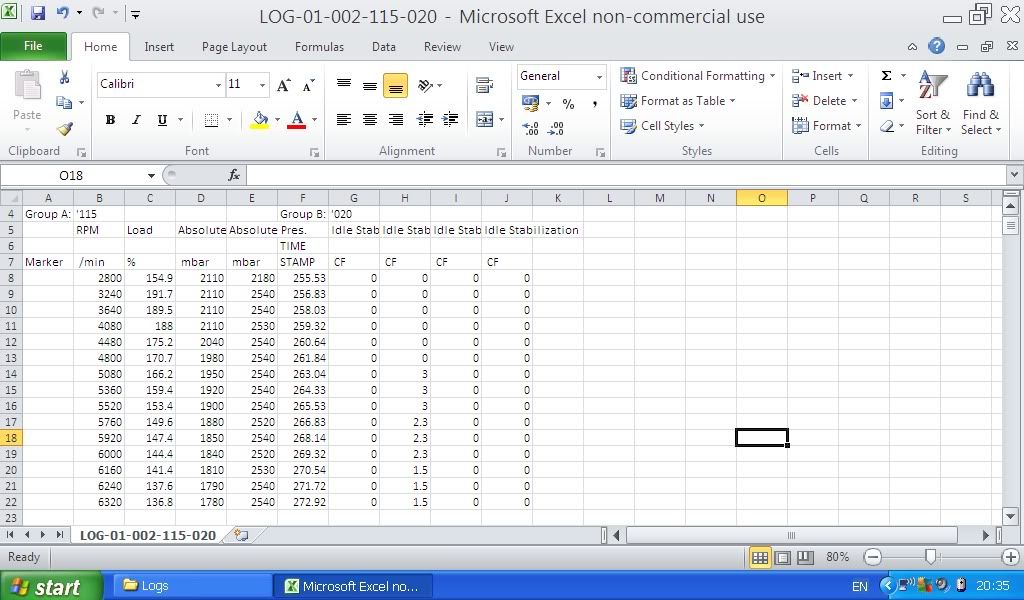

Heres a few of my crazy boost logs guys.. It is confusing the hell out of me.
1.54bar @6300rpm which is also what the boost gauge reads.
It has a brand new bosch map sensor so that should be reading correctly.
My guage has been tested to 30psi and is accurate.
Why does it hold so much boost????

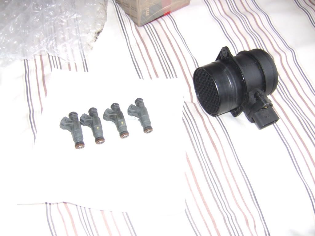

These little babys arrived today.. the 1st additions to my hybrid bits :) Next up 4bar fuelpump and maybe a k03 manifold to send to bill to port..

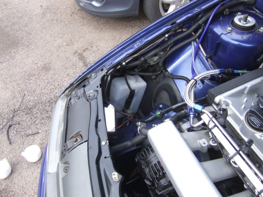

fits well there
will the oem pump fit in it ok
Yep thats the oe pump in mine, just lengthen the pipe to fit, take out a bit of polystyrine near the wing, drill a few holes to mount the bracket and give it a good push in.
Just common sense really only took 20 mins ish
