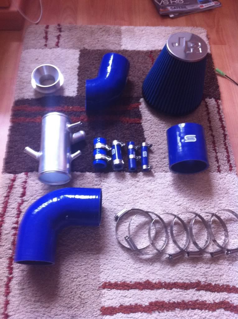

Badger 5 3" TIP arrived today, beautiful piece of kit :)
