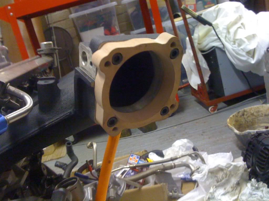

Prototype sandwich plate made, works a treat

make sure the nozzles end face is as close to flush to the ID to ensure the spray does'nt hit the edges and blob. you will need the nozzle to know how deep to tap the 1/8" npt thread
That one was more just to test the hole spacings, can be easily remodeled. Good point though!
I will be using the AEM kit, do you have one to hand? if so could you let me know the dimms of the nozzle??

bell me late tomorrow and i will look one out - the ket bit will be the taper thread and how deep you run the tap will determin the protusion
