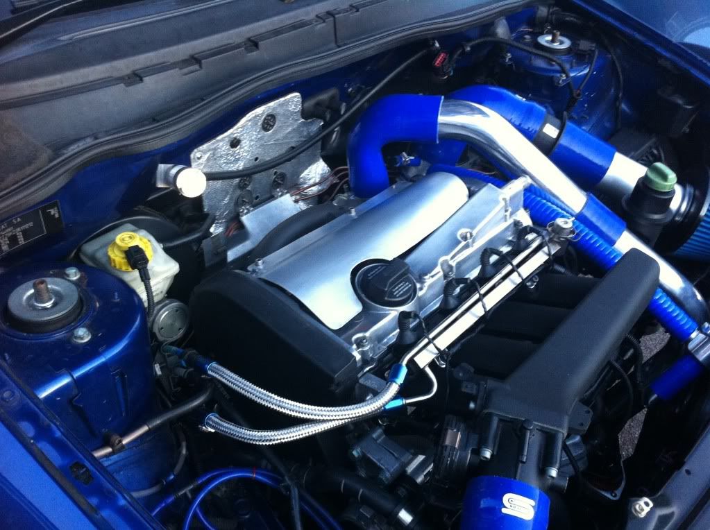

Made a bit of progress today, welded new brackets to move the rad back and just drilled the cooler bracket 3cm back to move everything back a bit more. Had a first mock-up of intercooler pipework which is coming along nicely.
One problem is that as I now have a LHS inlet manifold, 70mm TB, TB sandwich plate AND phenulic gasket the pipework connecting to the TB clashes with the slam pannel.
Should be solved by making a wedged sandwich plate or worst case im going to have to trim away some of the slam pannel.

Yeah that was going to be the last resort I think, wouldnt need too much trimmage, a 1" notch I think would do the job.
I can force a pipe onto it but the silicon collapses a bit which will hinder airflow..

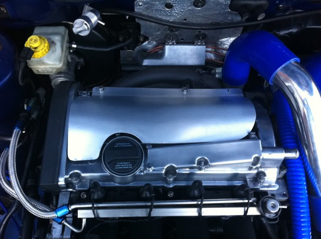

Knocked myself up a coilpack heatshield tonight, came out pretty nice :)
Make your own! :p
Yeah would be hard to produce the bends though, I suppose it could be carbon skinned after bending it up.
Carbon fibre is a bit overly used these days imo
Coming on very well James & the coilpack heat shield is spot on mate.
Im 2nd inline if you decide to take up Berg on his offer lol
Engine bay is looking pretty smart, I see you're finally getting there
The coil pack cover is a nice touch...
Cheers John. Yeah It is just a very rough mockup of pipework ect. I will be getting the chargepipe welded rather than using a silicon joiner and loads of other little things that will hopefully clean it all up. Getting there now though.
