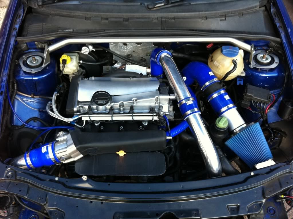

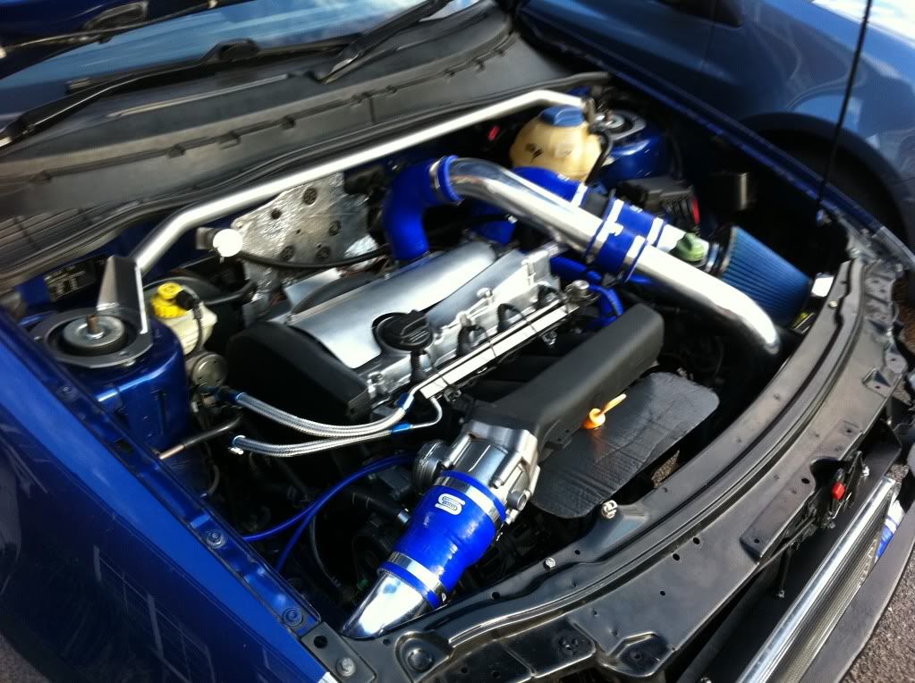

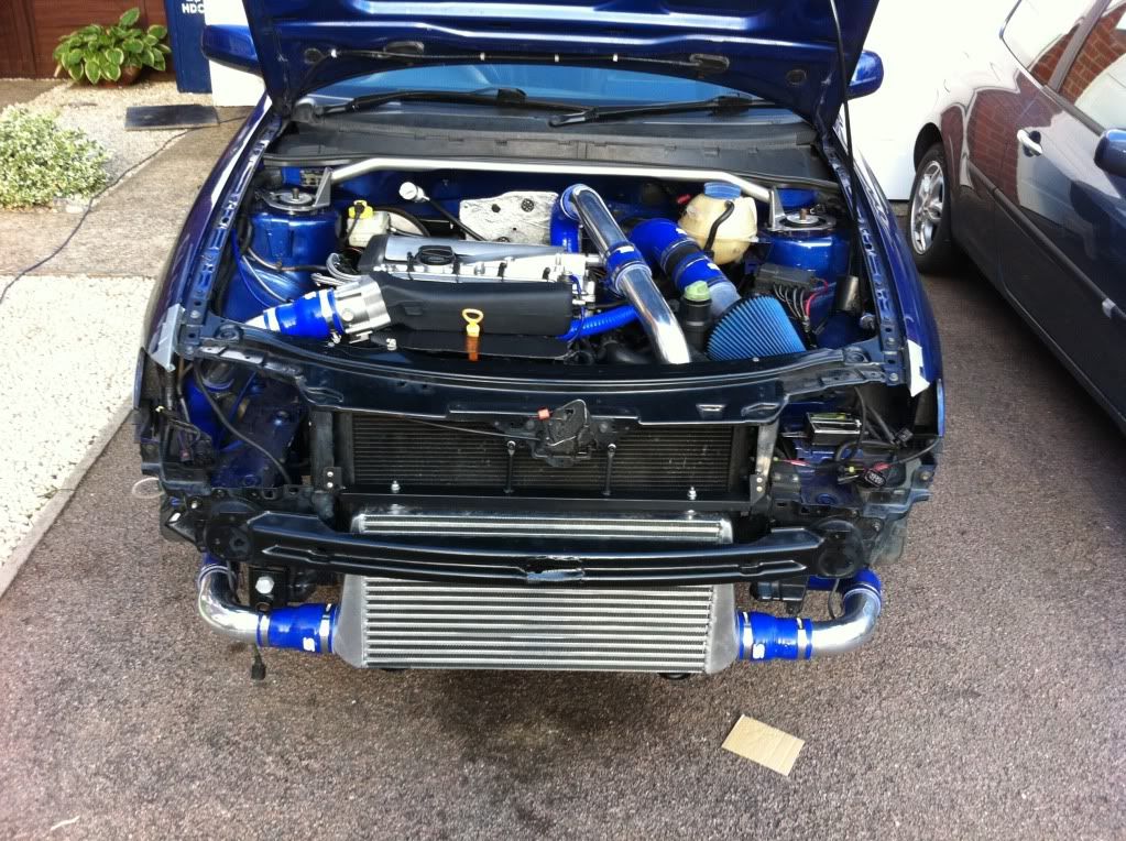

Few more pics.. Slowly coming together now :)
Dipstick cover is just sprayed cardboard, Undecided if I like it or not.. Will be made out of ally when I make my mind up.
Also going to make the rocker and crankcase breather pipes out of braided hose.
wow you have been busy this weekend mate top work fired it up yet????? very exciting
Yeah, its all good fun when you can see things start to come together though.
Nope still have loads of little jobs to do before the first fire up. 2-3 weeks im hoping :)
I dont think there is one thing left under they bay that hasnt needed modifying to fit lol!
mate really does looks sexy all that hard work will pay off. built not bought 100%. you should be very happy.
think of all that you have learnt along the way. i remember giving you the name of the site when i sold you the car. never thinking you would take it so far. cant wait to see it in action and hopefully attend a few shows.
I am very happy with how its turning out.
Tbh I didnt see myself taking it this far either, just so bloody addicting!
Cheers for your comments though Joe glad you are a fan :)

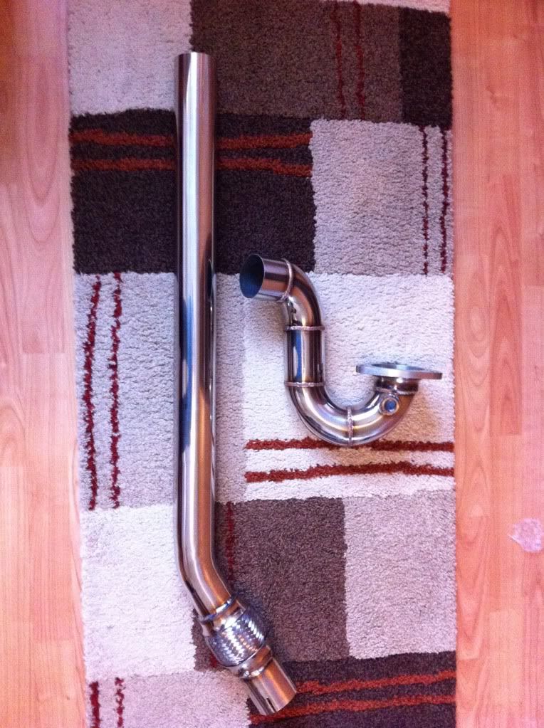

Baught a Qpeng 2.5" downpipe so I can put a few hundred miles on her before I get the custom 3" downpipe made and get it mapped.
Really nice quality actually, shame It will only be on for a few weeks!

Well the Qpeng downpipe I have baught is actually for a mk3 golf with a 1.8t K04 conversion, but I have been assure it will fit the mk3 ibiza just fine (basically the same front end as the golf)
It will require a bit of cutting to length obviously but should fit fine.
The only reason I baught it is that I have no other way of getting any miles on the car before it goes for the 3" downpipe and map. And I really dont want to drop an untested car off to be mapped!
