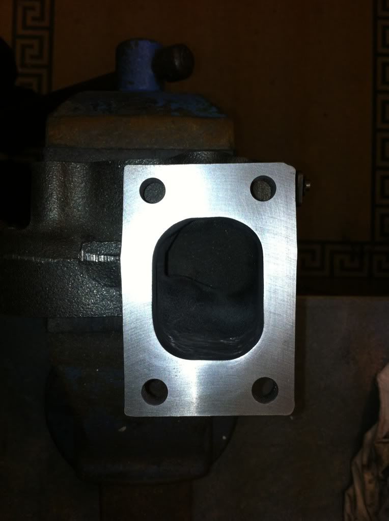

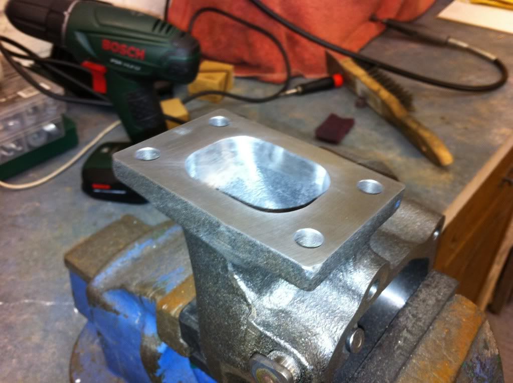

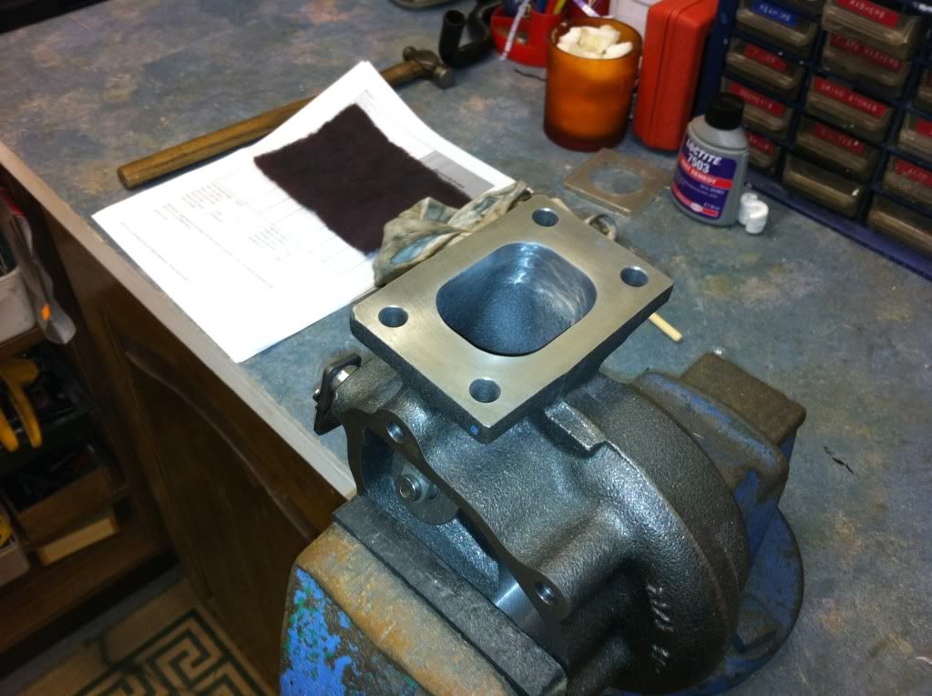

Had a bit of free time this aftenoon so I decided too gasket match the inlet to the turbine houseing..
Haha! Im going to try a gasket first and see how it goes, Issam tells me he doesnt have a problem with the gaskets he supplies.
Garrett dont seem too know what a T25 looks like, the casting was terrible
Yeah i desided to Run Gasketless On the Turbo to Manifold (Alex & John Recommended) it and its been perfectly fine But i did end up used a Gt28 Gasket on turbo to Downpipe...

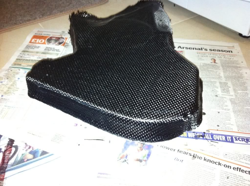

I had my first go at carbon skinning tonight, I think I have aged about 5 years in the process! what a fiasco.
After throwing a few hissy fits and ripping the carbon off several times here are the results.
this is just the first topcoat of resin. It needs flatting and then 2 or 3 more coats adding and then finally run through the grades of wet and dry and a polish.
Im rather please with it :)
