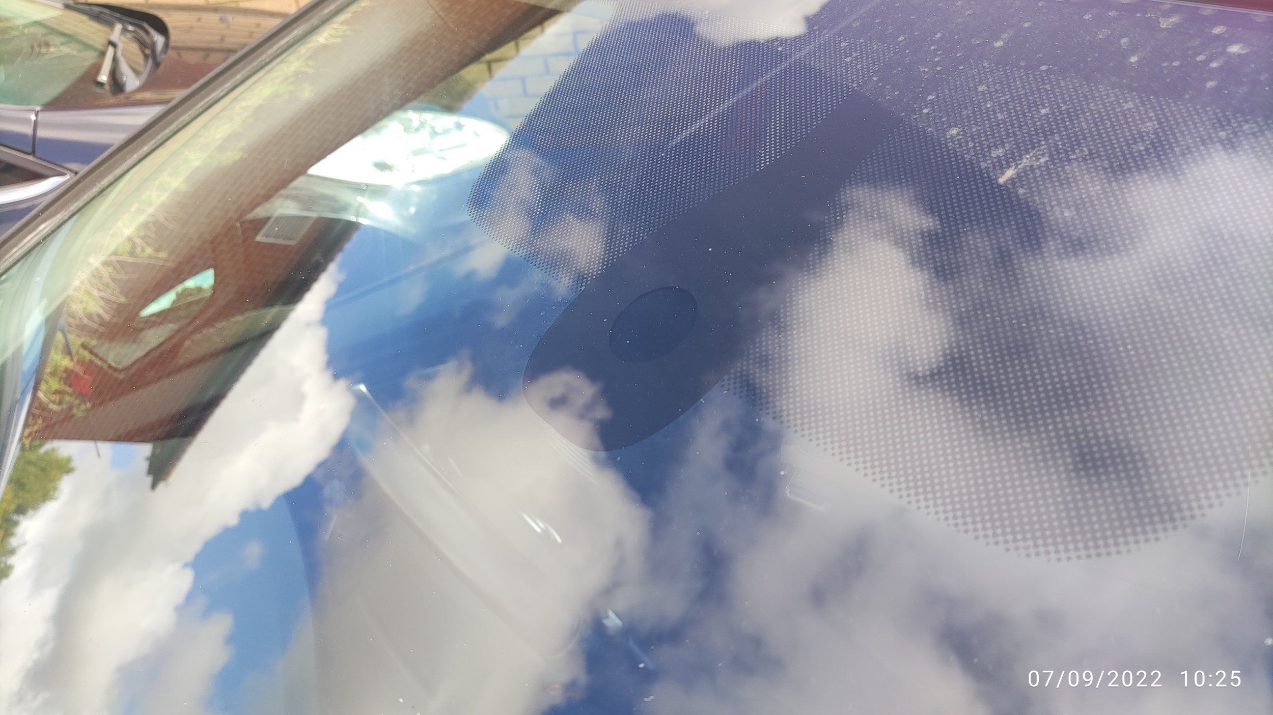

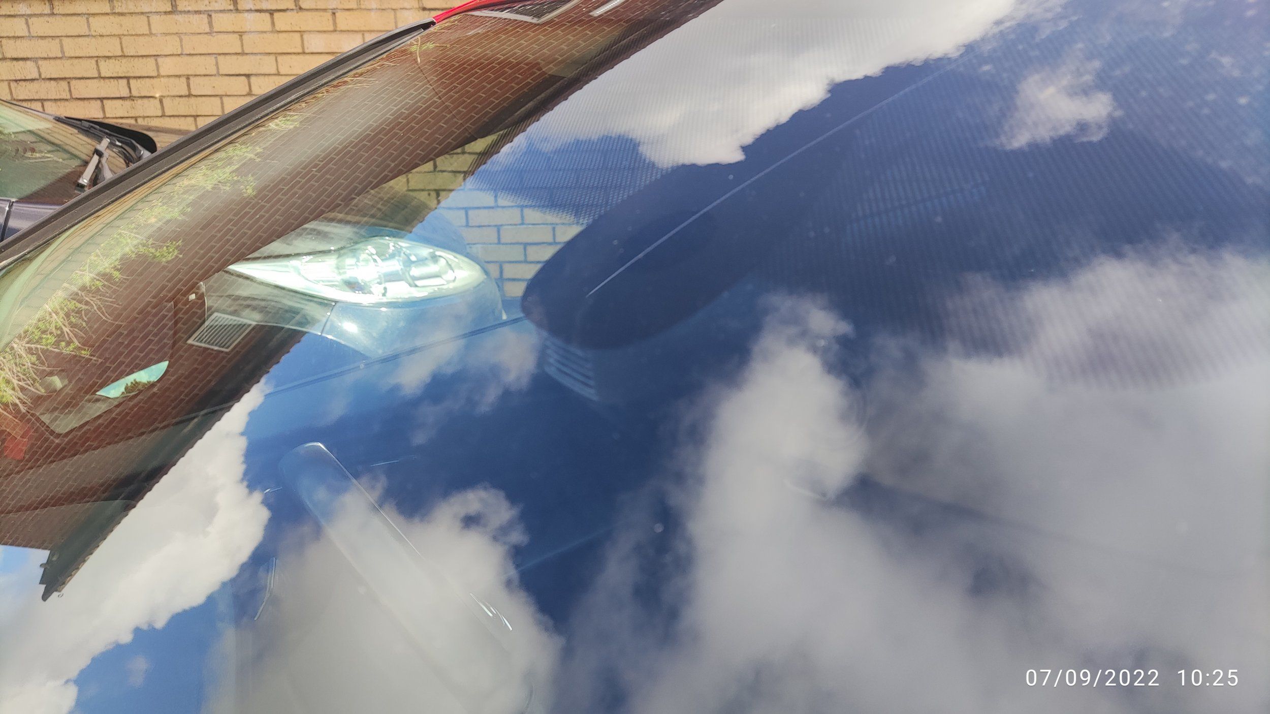

This is the type of sensor i have, any ideas on what it is ?

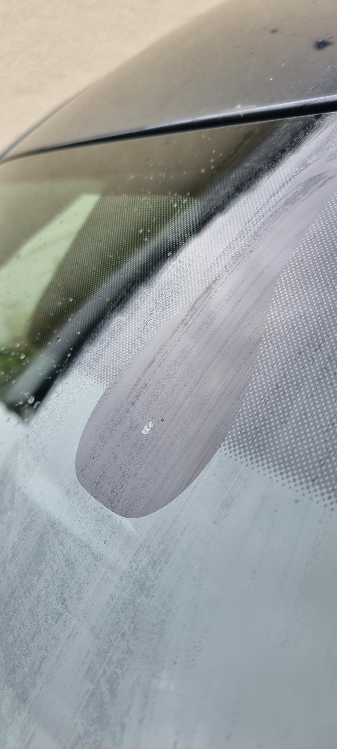

Not sure there's any sensor at all there, mate. Just took a photo of mine with the sensor in the middle. You'll have a little square if you feel the back of the mirror, that's the auto dimming sensor but that's your lot.
It looks like you are right !!! Just a blank space there ! I wonder if aftermarket light sensor can go there to keep it all looking like from factory
