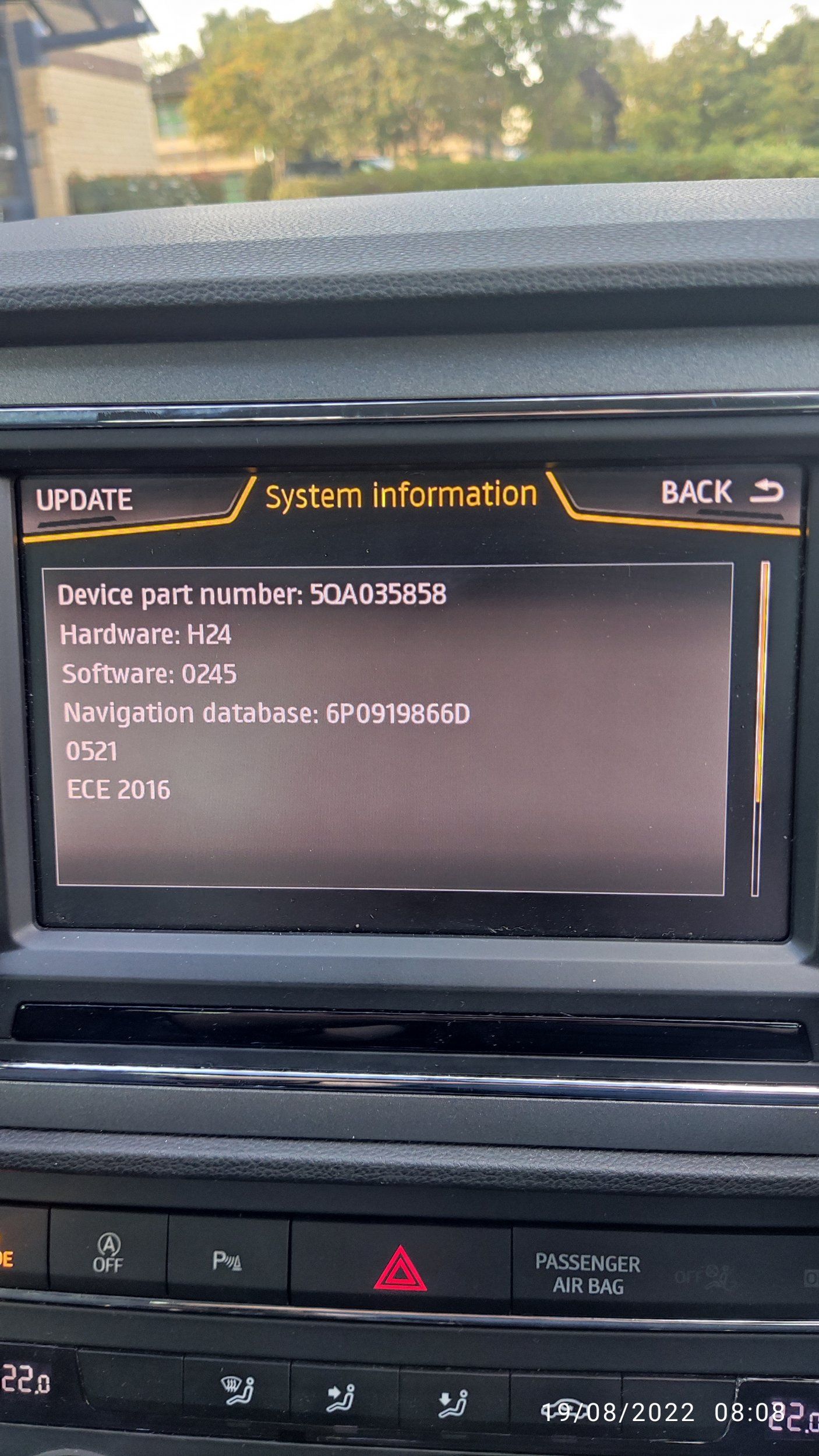

That's my current software, can that be updated ? If yes, how (dealer etc.) and how much this is outdated ?

Highest officially is 0253 but check out @East Yorkshire Retrofits to get the required
software.

How come then theres 0515 if official is 0253 ? ? Mine is a 16 plate mk3 still trying to figure out the way people mod new cars ?
It depends on the hardware as well. Think of a phone that can only go to a certain operating system officially but with a few tweaks can get the newest
0516 is the newest for units on the 05xx software train .
0253 is the newest for your unit, unless we perform a modified update.
0479 is the latest we recommend for those with the 6.5" display, 0516 for the 8" display
