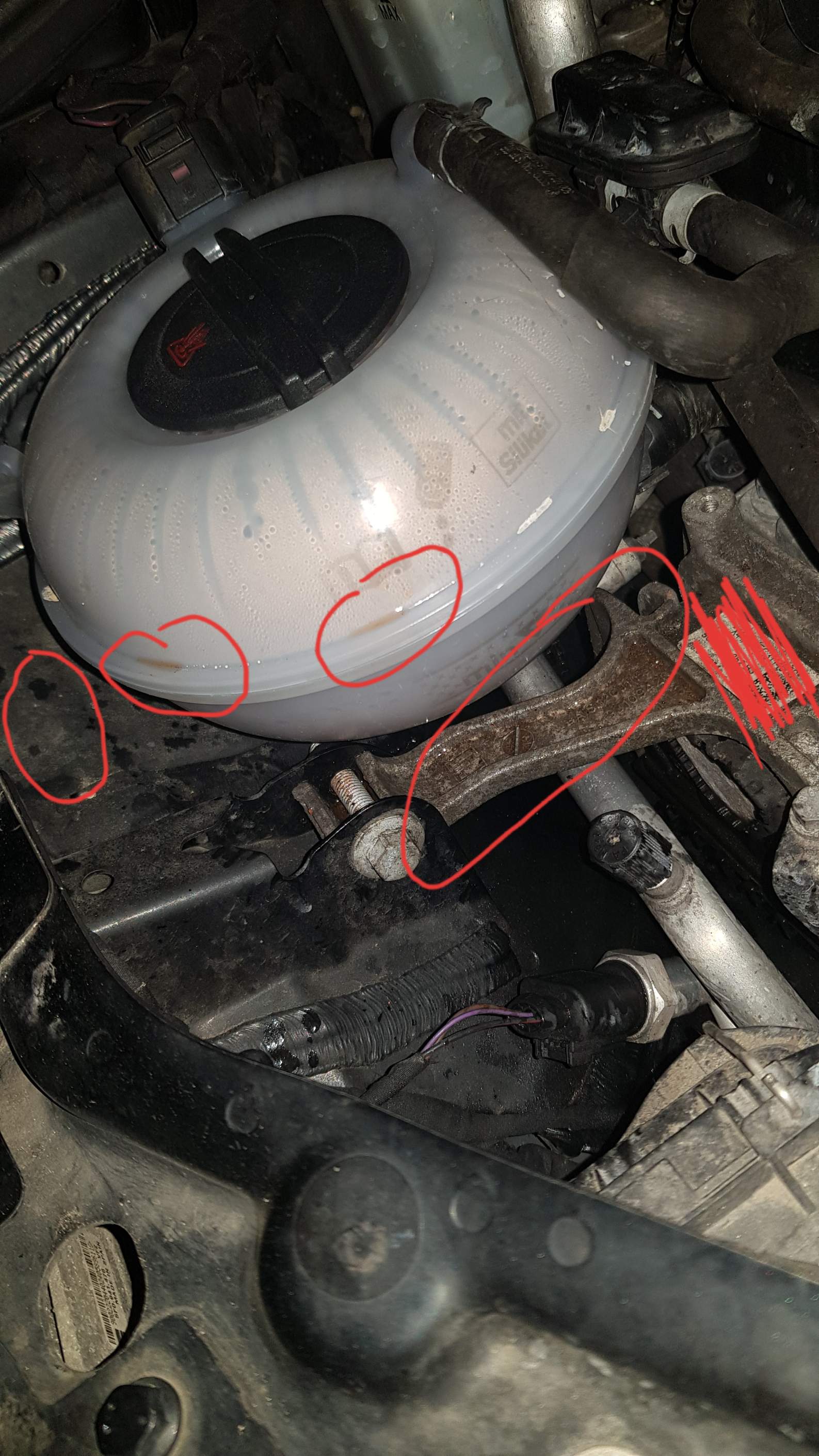

After 19 days of no coolant drop I finally got the coolant to drop...
I thought to my self lets try taking the car to high speed and checking for leaks right away. So I did exactly that, drove the car to 90+ mph and parked it up right away... And not really to my surprise the coolant bottle/tank was more than half empty.
Water/coolant was all around the bottle and under it. It was fresh and it was from the bottle...
Anyone can give me a better guess as to what this is caused by? There was no leak under the car I checked that too.
The metal part circled was really wet with coolant...

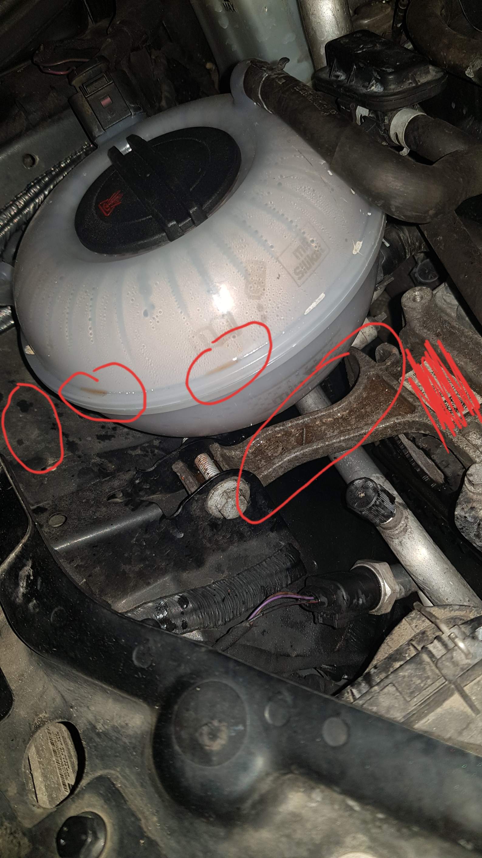

Update:
I’m more than certain to have a block somewhere. And I’m still hedging my bets on heater matrix! You’re 100% sure your heaters get up to roasting heat and are unified across all vents?

The coolant is leaking from bottle there is pressure valve

ykfr i had similar issue replaced heater matrix and done complete coolant flush and problem is gone

Yes if the coolant is leaking from the bottle then its pressure building up somewhere
