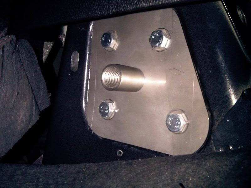

Started off with fitting the rear brace, side brackets mount solidly to the side of the car
The brace then fits in and is secured using the handles
Once tightened up its solid! And really easy to remove, comes out it about 60 secs.

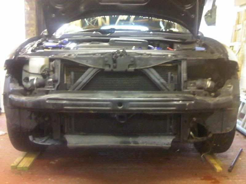

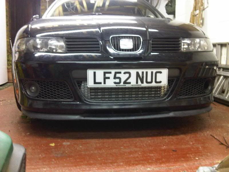

Just a quick shot of how the front of the car used to look...
Off comes the bumper. This was a bi*ch to do, really struggled getting the edges off past the lights. Took nearly an hour!!

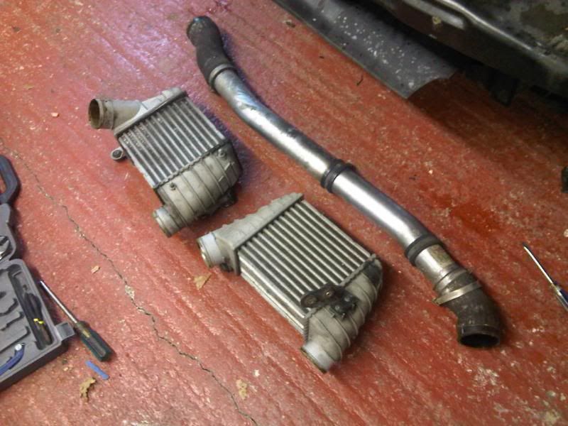

Crappy standard intercoolers and interconnecting pipe comes out...

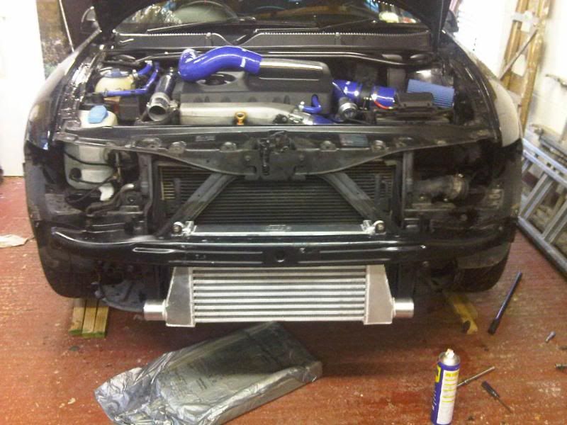

Front of the car ready for the new crash bar and intercooler
New crash bar on and forge intercooler fitted to it

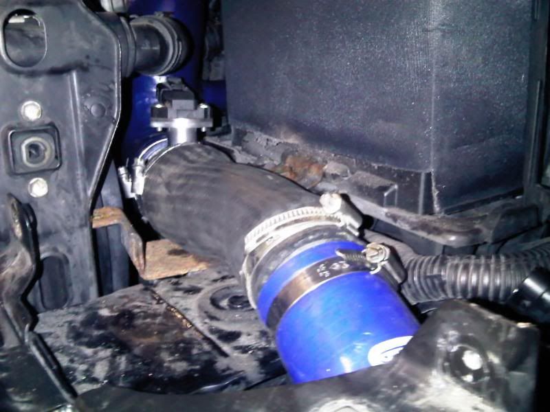

Fitted the pipe work on. Left side is perfect. But due to wanting to fit a new map pipe on the right side, the pipework had to be adjusted upwards to get it to connect to the new shorter map pipe. But after trial fitting the bumper this just wasnt an option, it fouled the bumper.

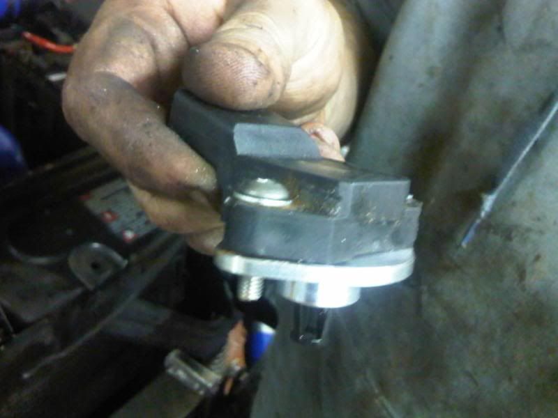

Next step was to get the map sensor out of the standard pipe, but the screws were just spinning so out came the Dremmel :D
Fitted into the adaptor to get it to fit to the new pipe
New map pipe assembly in place. Had to use some of the old standard pipe to extend the pipe to get it to join the intercooler pipework. Eventually this will be replaced by a blue silicon pipe.

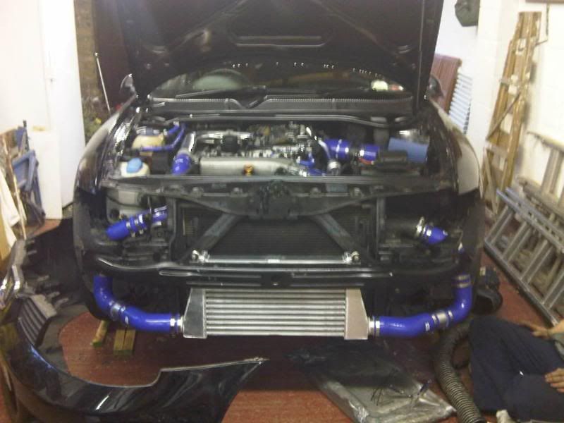

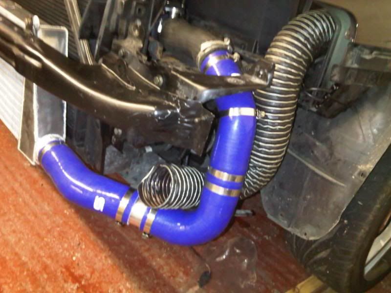

Right side pipework complete with 80mm cold air feed in place ready to be secured
Left side pipework also complete connecting to the new forge upper left boost host
Overall shot of all the pipework and cooler complete

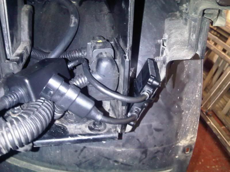

As the sticky pads supplied with the HID ballasts were crap and fell off within a few days, I took the chance to relocate the ballasts
There was a nice little ledge that the ballast fitted perfectly in. Was clear both side so this allowed a cable tie to hold it there securely
Used the same mounting point on the left side too, perfect fit!

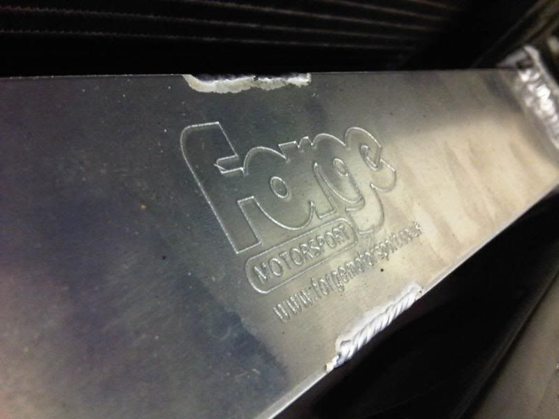

Arty shot of the forge logo :)

All done! Bumper was again a bi*ch to get back on again, stupid design is really difficult to get it past the headlights :(
Took it out for a drive and it pulls harder, sounds a bit more 'sucky' and dumps a lot louder after higher boost
Really pleased with it, the Forge kit oozed quality and was really easy to put on! Good days work :D
