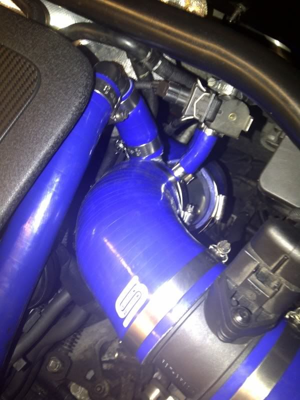

Full Custom 3" Turbo Intake arrived from Badger5 this morning
Very nicely engineered

I've heard alot about Bill's 3" TIP but had never seen any pictures until now. It looks very well made, especially the metal peace that sits into the turbo. Will you be fitting this with a de-screened MAF? Benefits over the Forge version seems to be proven?

Thanks James! I wont be de-screening the MAF, too risky in my opinion. The TIP is very well made! The machined bits are pretty damm sexy :)
Not sure about the differences from the forge version, but should hopefully find out from my logs. The benefits should show even more when I get a 3" down pipe too.

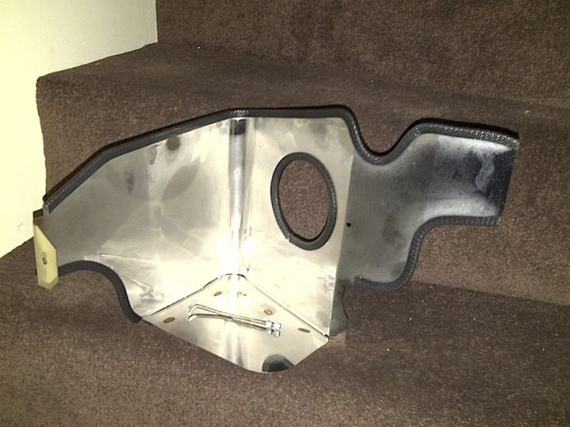

Finally got around to fitting the 3" TIP and Jabba Heat Shield now its not so cold!

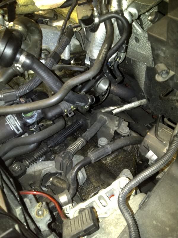

So took out the old Forge TIP

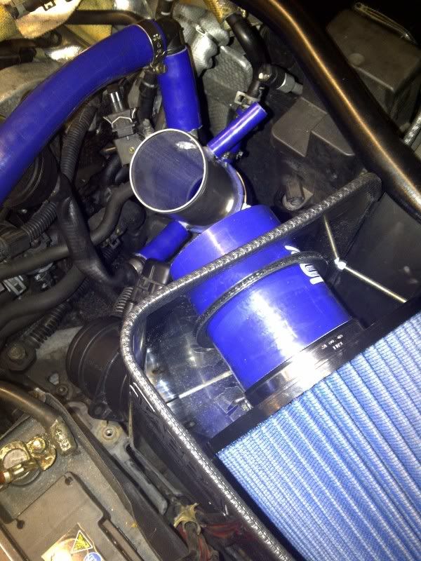

Fitted the shim onto the turbo with sealant and locktite on the grub screws
Started plumbing everything in
All nice and tight, had to take about an inch of the top 45deg silicone bend
Fitted the jabba heat shield at the same time so everything lined up nicely

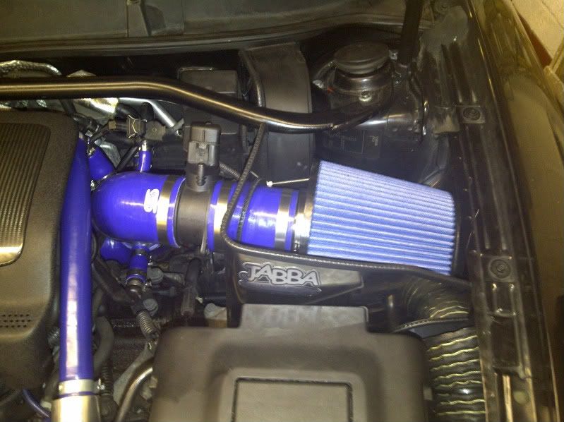

And an overall bay shot to finish. Pretty easy job really!

So thats an increase of 5g/s ! Feels more responsive and can hear the spool up more now too :)
Battery was reset during the fitting, so should get better as the ECU adapts
