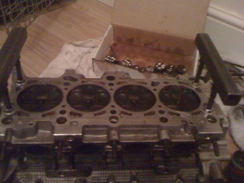

Heads all done and fully rebuilt and ferrea vavles & Inlets Lapped In nicely and everything turns over smoothly Just Need Followers to come then John can bolt it back together:D..
Well chuffed just Pistons to fit to the block and build it up thats engine done :D

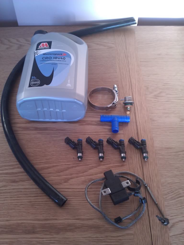

Took apart the BAM inlet and Fuel Rail...Cleaned all the Fuel out with some horrible little bits in it and also the FPR was manky....Refitted it all with my New Genesis 550cc Injetors (THANKS CARL)
And took apart the Throttle bodie and cleaned it all up with carb cleaner...Sorted the Date out with john and the engines going back together on the 9th July...:D
New Injectors Fitted
