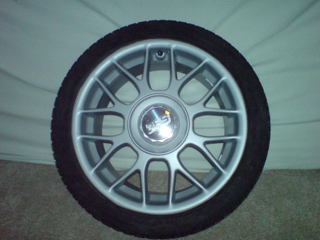

Ok so here's the update.
I raised the back by 1.5cm as it was just too low. The exhaust was hitting speedbumps. Going back to 16" inch will put it lower yet...so it had to be done
Here's the result
and where the calliper just clears the rim
But there is a problem which I don't quite understand, so hoping for some help
I bought conical bolts as these BBS rims needed those. The bolts are slightly longer than the OEM bolts, however the threaded part is just as long.
But the wheels don't turn. It seems like the brakes are on full or something?
Strange thing is that the brakes are in no way hitting the rims...but yet all 4 wheels don't spin at all anymore.
Could this be due to the bolts being too long and catching on something inside the hub?
Help please

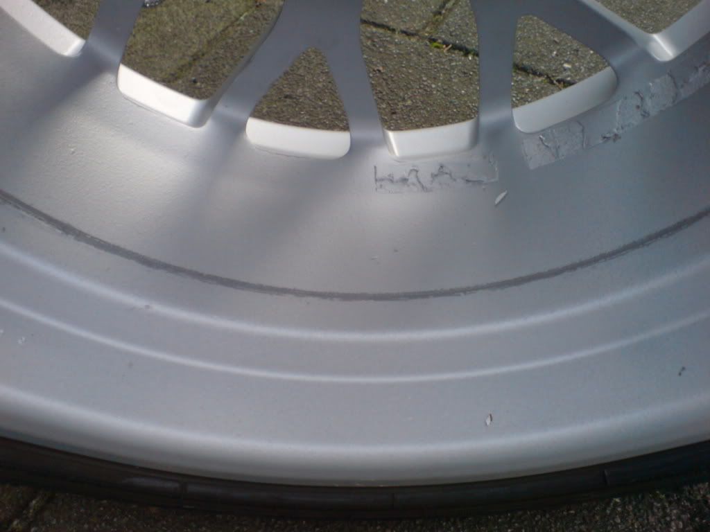

Ok a update on this. Good thing is, I wasn't hitting the ABS rings...
Bad thing is, I was hitting the front Audi TT callipers. Edit: please note that the absolute back of the calliper was already bare metal. I didn;t paint that part. Its only hitting on the 2 'bumps' on the calliper just past the piston.
That's why it wouldn't spin. And because the wheels are so closed I couldn't see the back part of the calliper hitting the inside of the rim.
Question is, can I mill part of the calliper there so that it does fit? Its there that the calliper stick out just a few MM more that the front of the calliper which does clear the rim (see picture posted few posts back)
