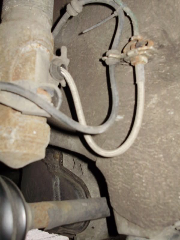

right here is what it failed on
1) Front brake hoses no place to clip in hoses (brembo 305mm setup with braided hoses)
what can i do about that?

When i done my conversion i cut the rubber gromet from the old pipe that clips on to a bracket on the shock and clipped it back to the same place to hold it out the way.

This is the best pic i can get without taking the wheel off hope it helps,
