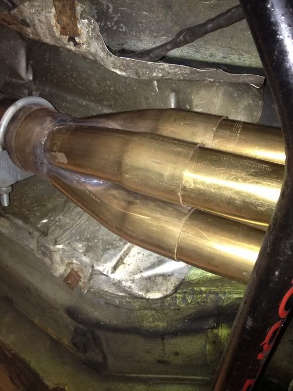

Had an email from Mark about the power run and its pulled 10% less and looking at the AFR readings the engine is running inefficiently due to poor flow of gasses through the head, would assume the bends in the manifold are spoiling the gas velocity.
So looks like we will be going back to the original design which seems to be better.

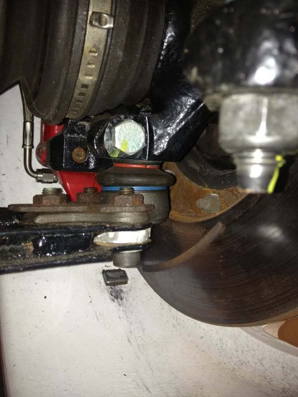

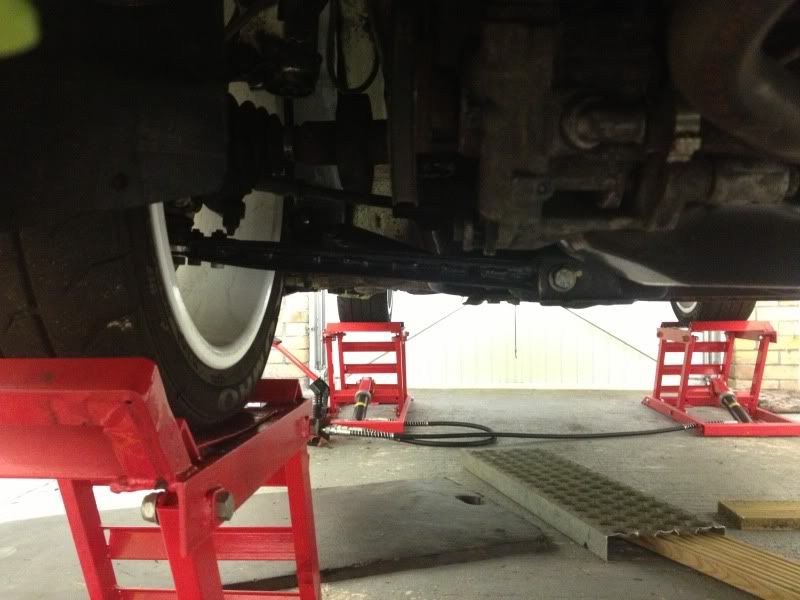

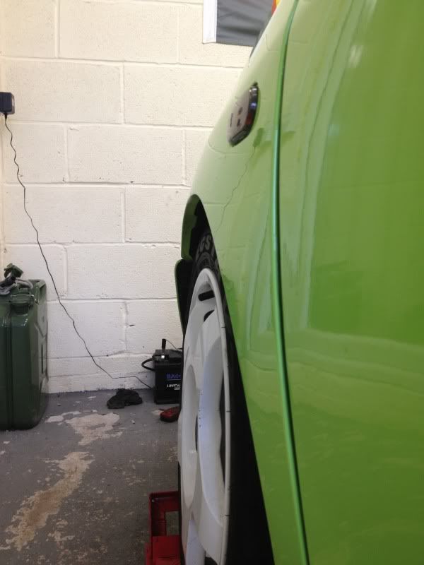

3 degrees of negative camber
Level lower arms
Because of Saxon Motorsport's ball joint extenders (simple and clever design)

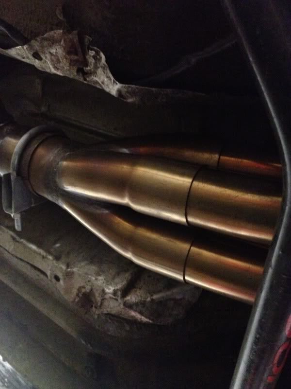

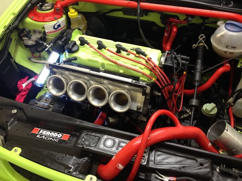

Floating collect, by Powerspeed (modification to my orginal manifold)

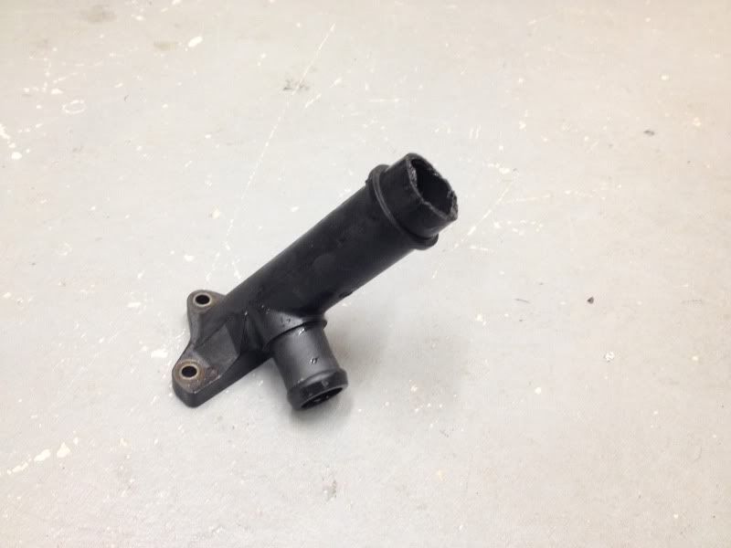

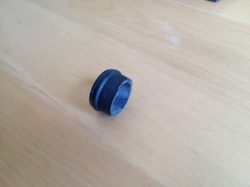

Ideally this was a last minute thing as I should now be on route to Oulton Park but when I got the car onto the trailer I rev'd the engine and next thing steam coming from the engine and coolant on the floor :cry:
Turns out the plastic housing on the engine that the top radiator hose fits to had snapped! No chance in getting one till tomorrow if I'm lucky, Saturday is probably more realistic but either way I can't do Oulton Park.

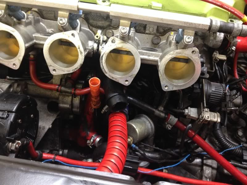

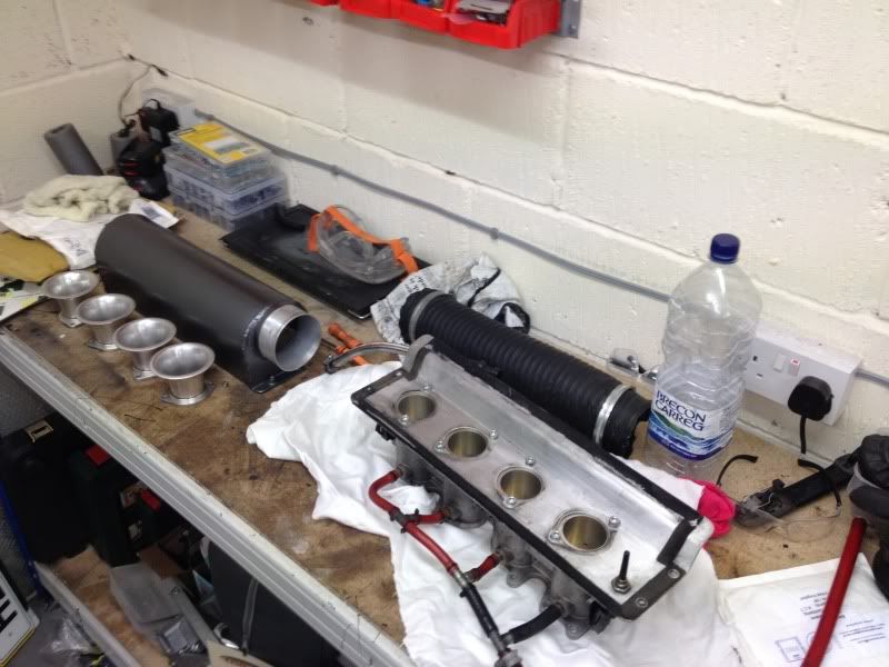

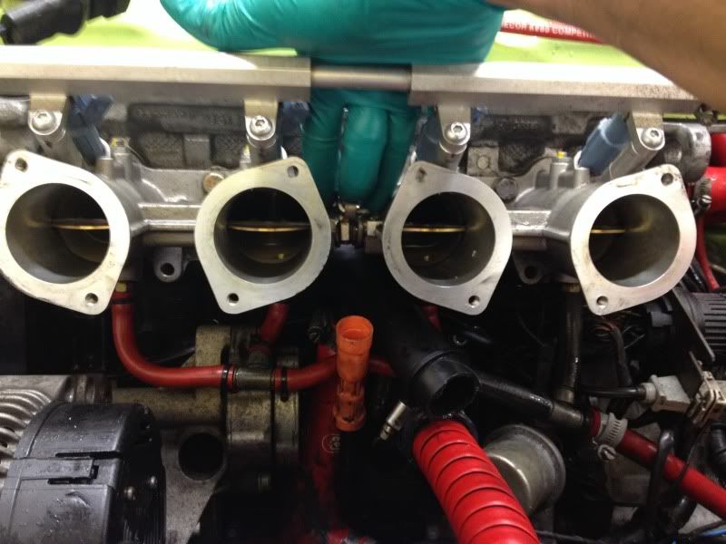

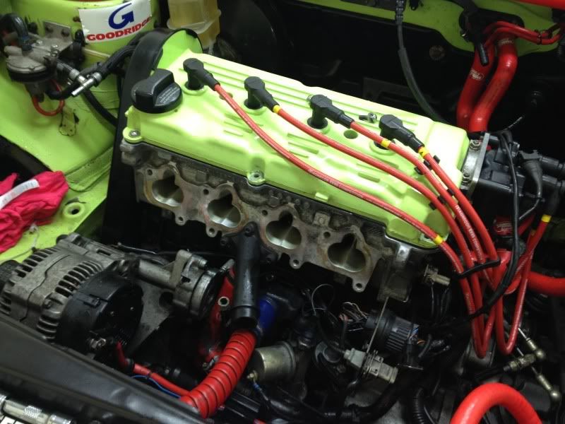

Update of the strip down I had to do to get to the plastic housing for the top radiator hose.
Open butterflies
All that had to be removed just because of one bolt on the housing!
