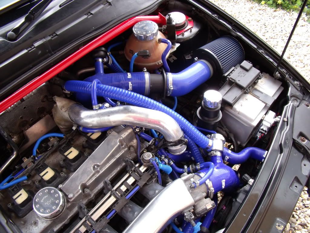

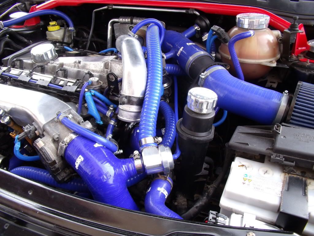

fitted the forge cold side dumpvalve relocation kit only a 5 minuite job
is that the one that is only for the LCR?
you feel any diffrence?
dos it sound any diffrent?
looks well smart mate
no buddy its the mk3 ibiza kit only just been finished
http://www.forgemotorsport.co.uk/content.asp?inc=product&cat=&product=FMRLKIB
sounds a little different but its a full recirc so not going to make it alot louder unless you have a split-r or a turbosmart
and as for do i feel the performance differance , not yet as ive only drove it 30 miles and then found a k03s
but its simple instead of hot air going back ito the intake its cold air = lower temps = more power (slightly)

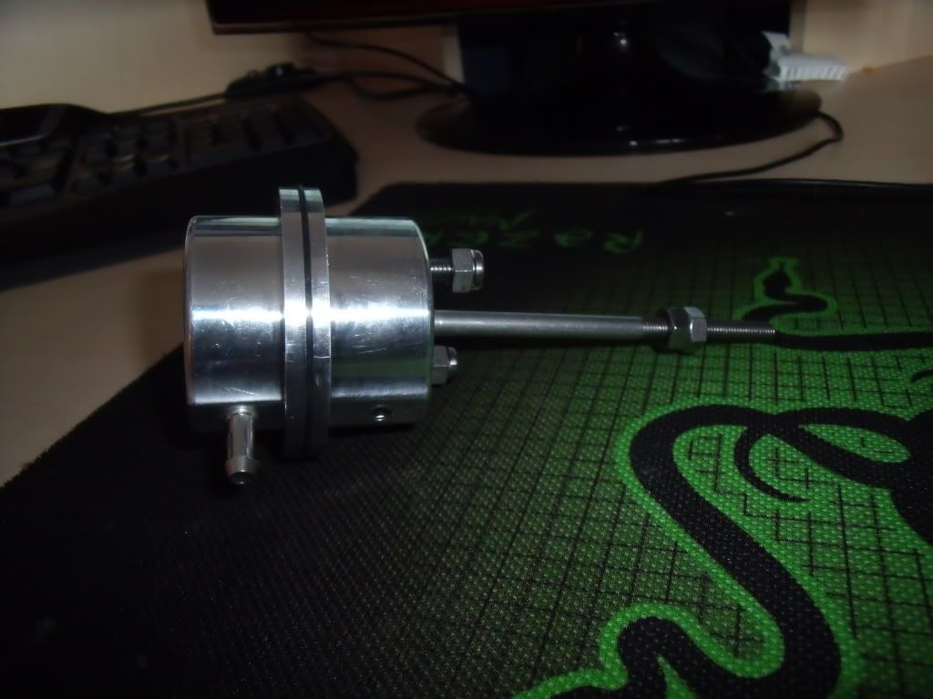

oopps my bad soz mate so you got your new actuator then does it simply fit or does it need extra parts and modding ect many thanks bud
fits perfectly manifold off then oil feet banjo bolt , 3 10mm bolts then the rod bolts and its off and replace with the forge item, with bracket etc , just needs a different spring in it as it opens to easy
the k03s one isnt on there website yet but will be soon as theyve just come out of development
Well took the acctuator off ready for new spring and what an easy job that is
2 10mm bolts holding to bracket
2 11mm bolts on the rod
and off she slides ;)
simple heres a few piccys of it off the car ill get some on the car when i fit the new spring.
its had my grubby hands all over it so needs a polish :(
