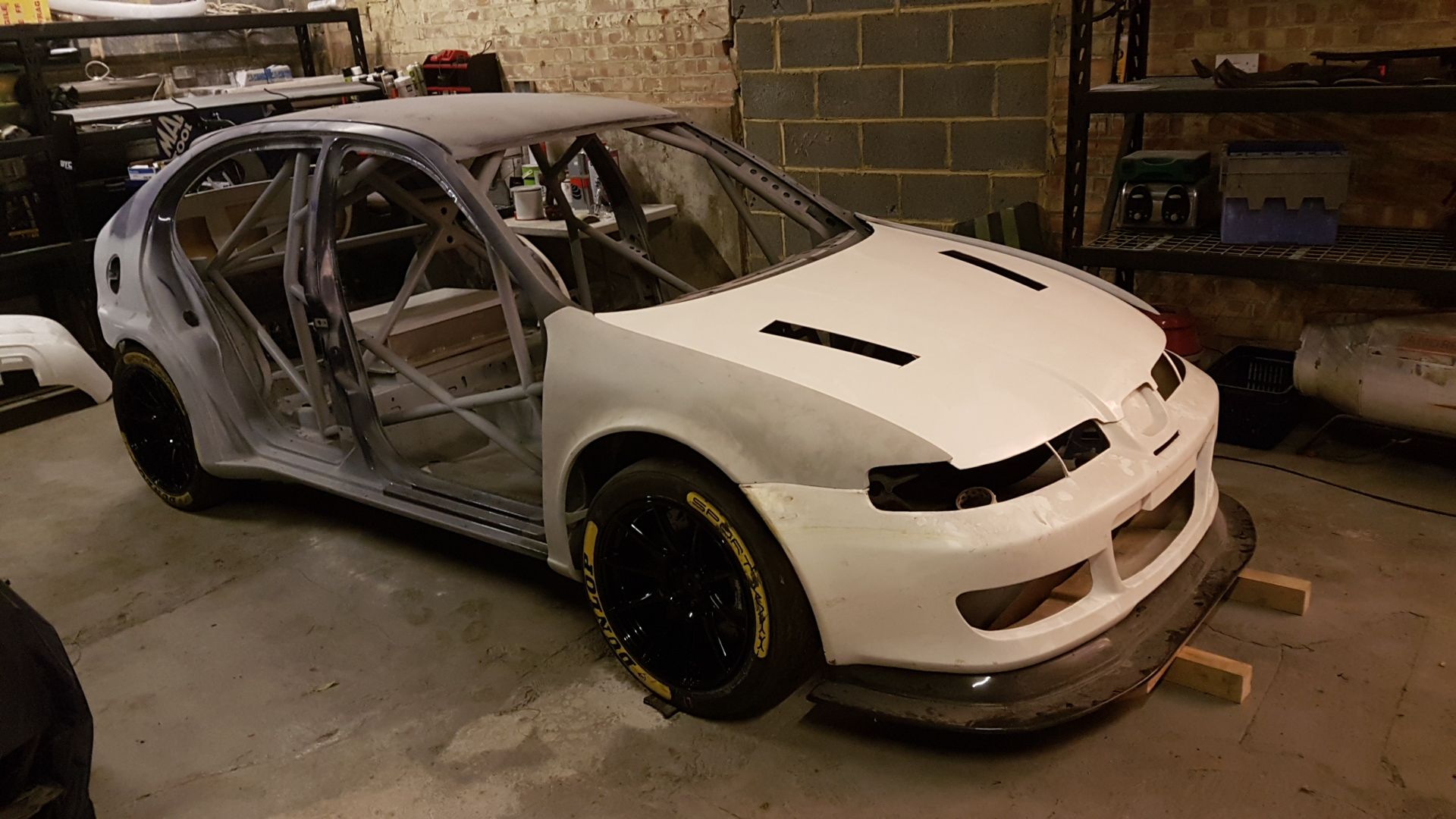

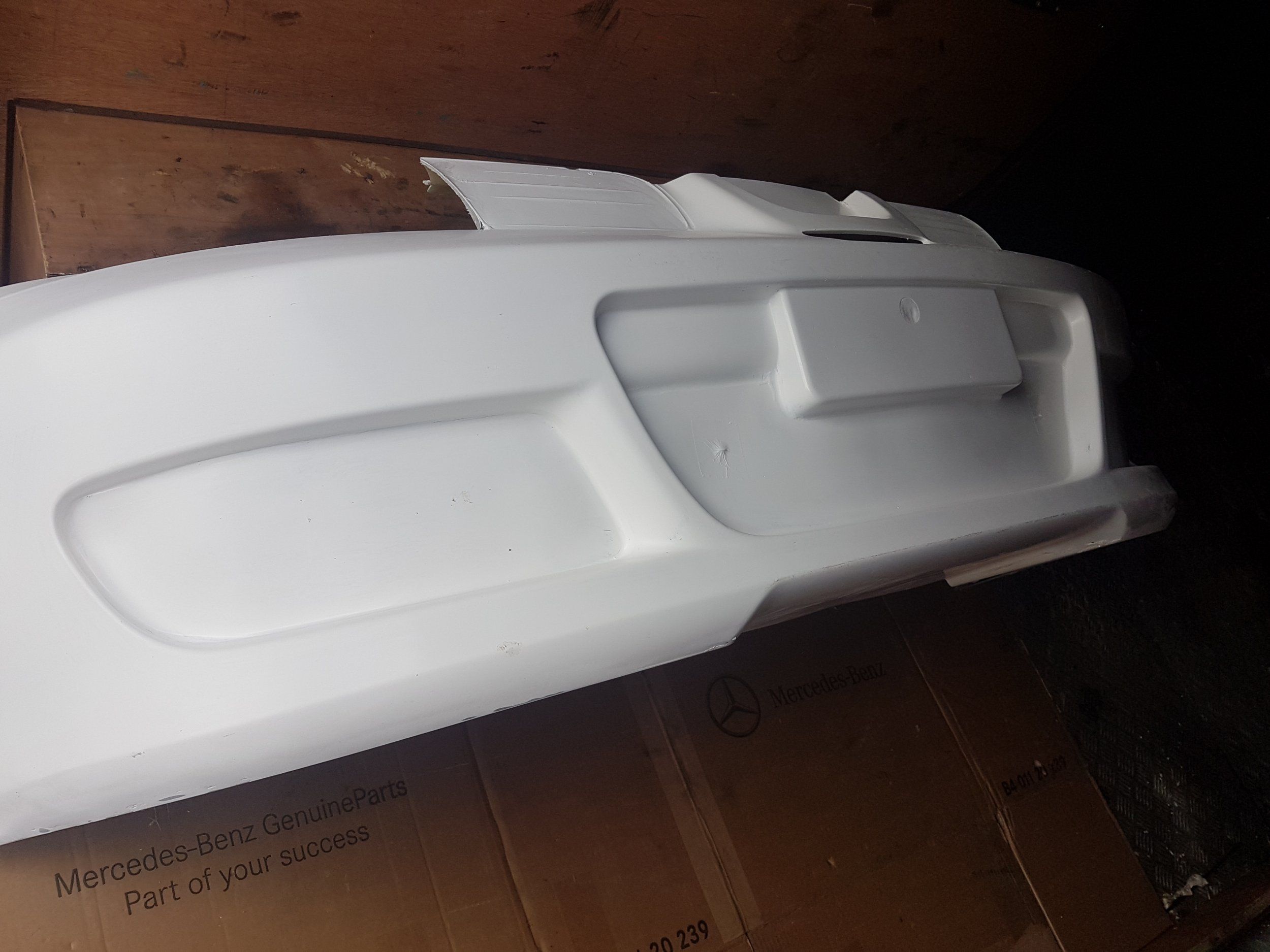

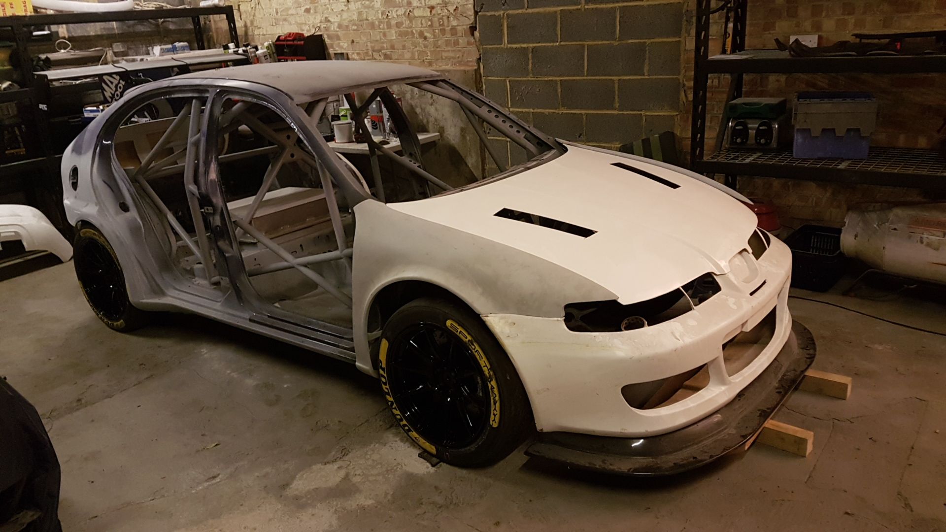

Are they a good fit?
Fibre glass race panel's aren't usually the best i thought (although happy to be proved wrong).
Cheaper than a dealer one though.

It's looks ok. It was list dumped in place and buts of wood holding it up lol. But then it needs the edges cutting and lining up. Then going to use ruvnuts in to the bottom of the wings or come sort of clips. Then going to make my own crash bar across the front then fix to that as well.

I was looking for Cupra R bumper too and google a lot between OEM ones made of ABS Plastic and the FiberGlass ones. What have I found? Fiber is much more cheaper but it doesn't have any holes or mounting edges already aligned to fit - you must do everything to fix the bumper to the car - and be careful as some don't even have the fog light support points. Another thing is the low distance to the ground, the Leon is a low ride and the front bupper (especially with the front lip) became a target to the road bumps and sidewalks. Fiberglass isn't that flexible and a small touch will break it especially on the wheel arch. OEM ones are stronger and more flexible but the price tag even on second hand is stupid high. I end up going to OEM second hand and it's perfect all these years.
