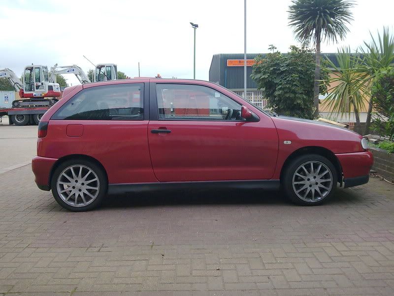

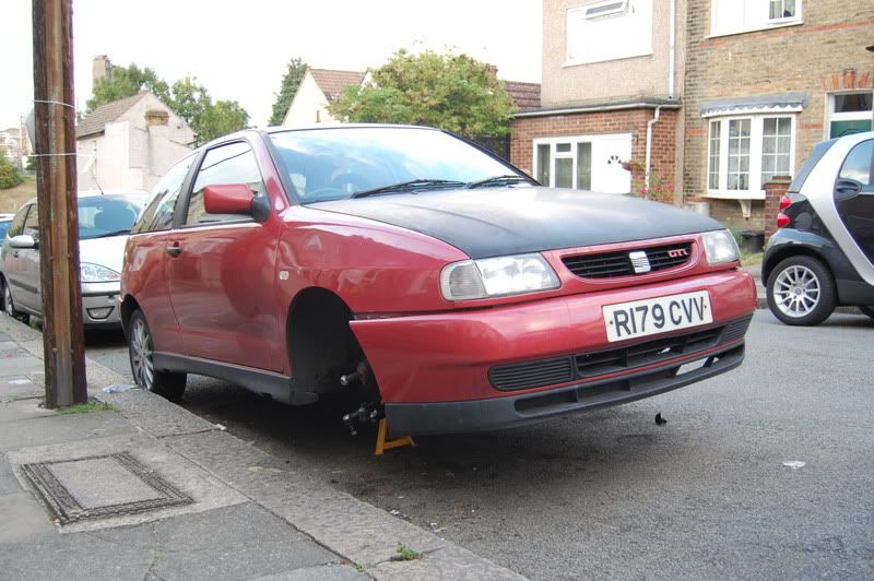

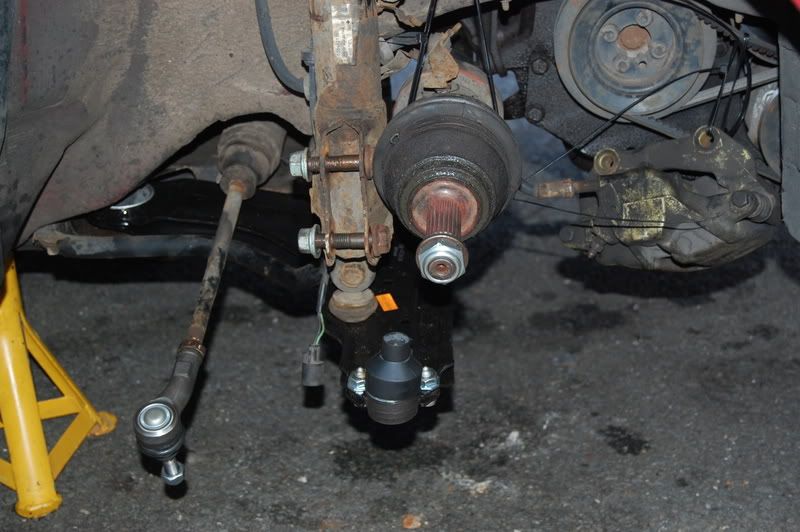

Previously I got the front end re-assembled with the replacment koni shocks that came with the car to discover the resulting stance wasn't to my liking
So after abit of deliberation I got myself a stonking deal on a SACHS Sporting kit comprising of Eibach springs and gas shocks, also fitted new discs and pads on the front as I managed to warp the old ones when they were on the golf (pics to follow) and new front tyres

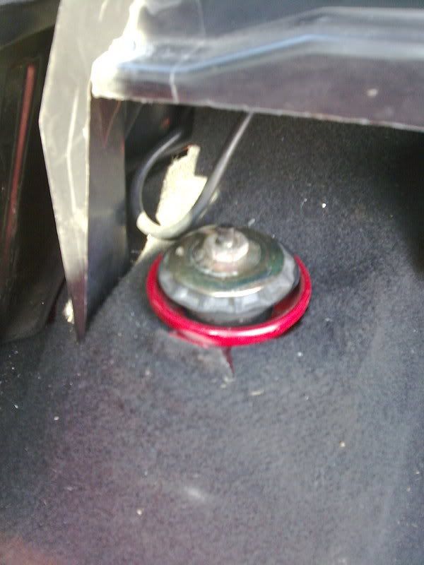

Upon replacing the suspension, this made me giggle. Anwsers on a post card too....
Had a bit of headache when it came to adjust the tracking as the threads on the track rods were heavlily corroded, ended up heatign it all up till it was cherry red to get it to budge

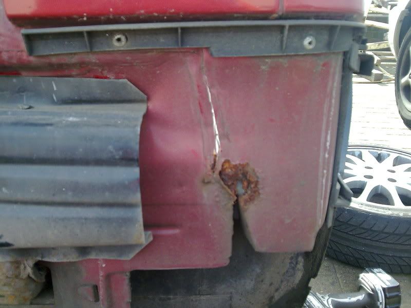

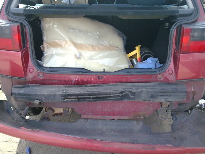

Set about repairing the back end from its prang,
Bit of a mess as you can see, prised the crashbar off with a bit of violence and carefully used a 10t toe jack to push the floor and around the tailgate shutline back straight and sourced a 2nd crash bar from a local scrappy for £10. got to replace the snap nuts and screws around the archlends as they were too corroded to undo

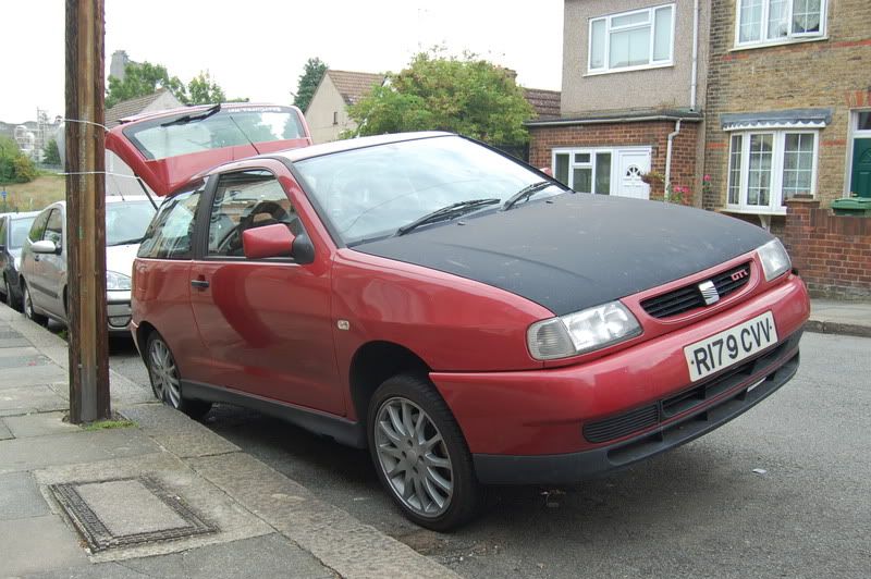

Got me hands on a 16v rear spoiler and an unmolested airbox, Its got a drilled one on it at the mo and nice as the noise its abit annoying on a long journey I must be getting old lol

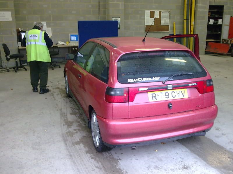

VIC check booked for the 24th so I'm hoping it passes that no
problem, then an MOT and some road tax
