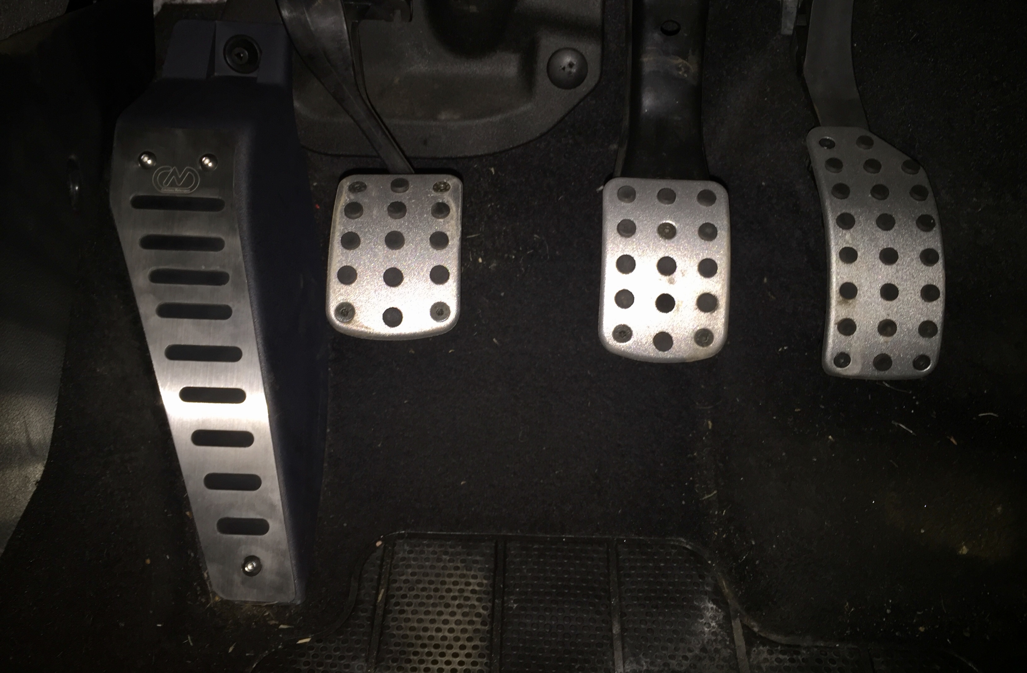

It’s a minor mod kinda day. So I actually managed to get my hands on a set of genuine Seat Sport pedal covers just before I started this forum, and also a Creation Motorsport deadpedal cover to match. I put the Seat Sport pedals on a few weeks ago but never got round to the deadpedal due to time and weather. Pedals are just a case of pulling the oem rubber covers off and following the instructions that come with them to put the new covers on. The deadpedal requires 3 holes to be drilled into it to allow the fitting of the hardware, removal of the deadpedal is just a case of one 10mm nut and it pops out.
Couple of photos:
Before
*Ignore the dirt, I promise I clean the inside too*
Overall I’m happy. Wish the CreationMotorsport cover came with flush/countersunk mounting bolts instead of convex bolts but that’s me just being picky. Found with the oem rubber pedals, and filling up at petrol stations, if you get any diesel residue on your feet, then you end up almost putting your foot through the firewall they slip off that fast so I’m glad the Seat Sport pedals do a good job of stopping that with the extra surface area.

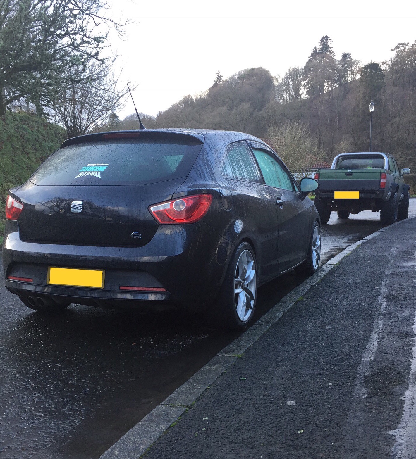

In love with the overall stance now (doesn’t beat my mate’s pickup though haha). The lack of rear spoiler is killing the whole back end look in my opinion butttt tomorrow morning the car is going for a full 4 wheel alignment to double check everything on the car. This was my budgeted money for the spoiler being painted while I’m on holiday so will have to wait a little longer. Will also be making a start on the front door speakers tomorrow afternoon and HOPING it is finished by the evening, but I doubt it.

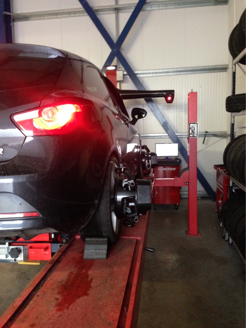

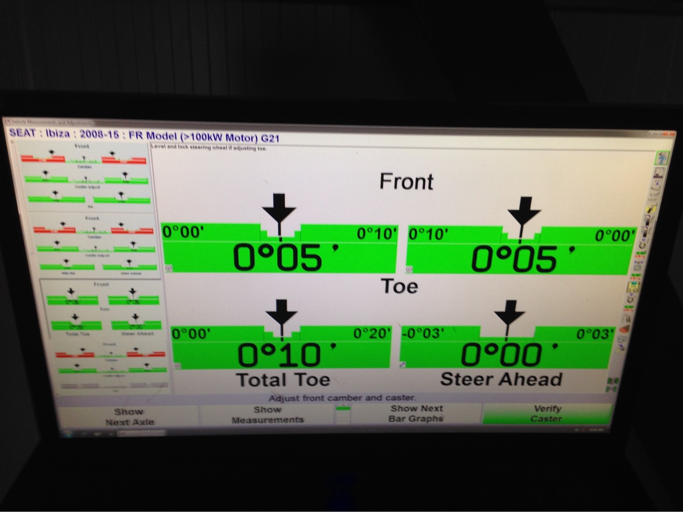

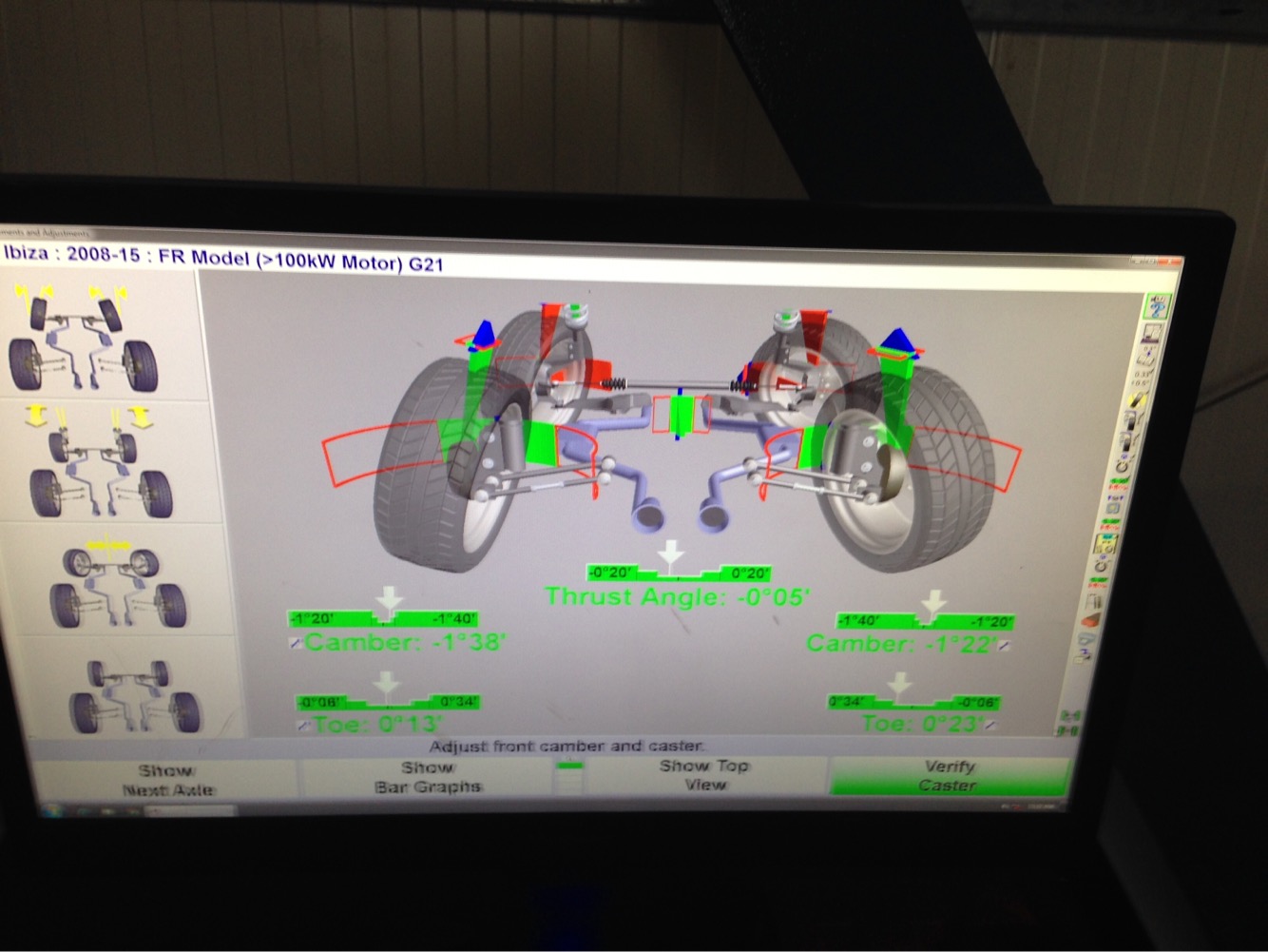

Update from today:

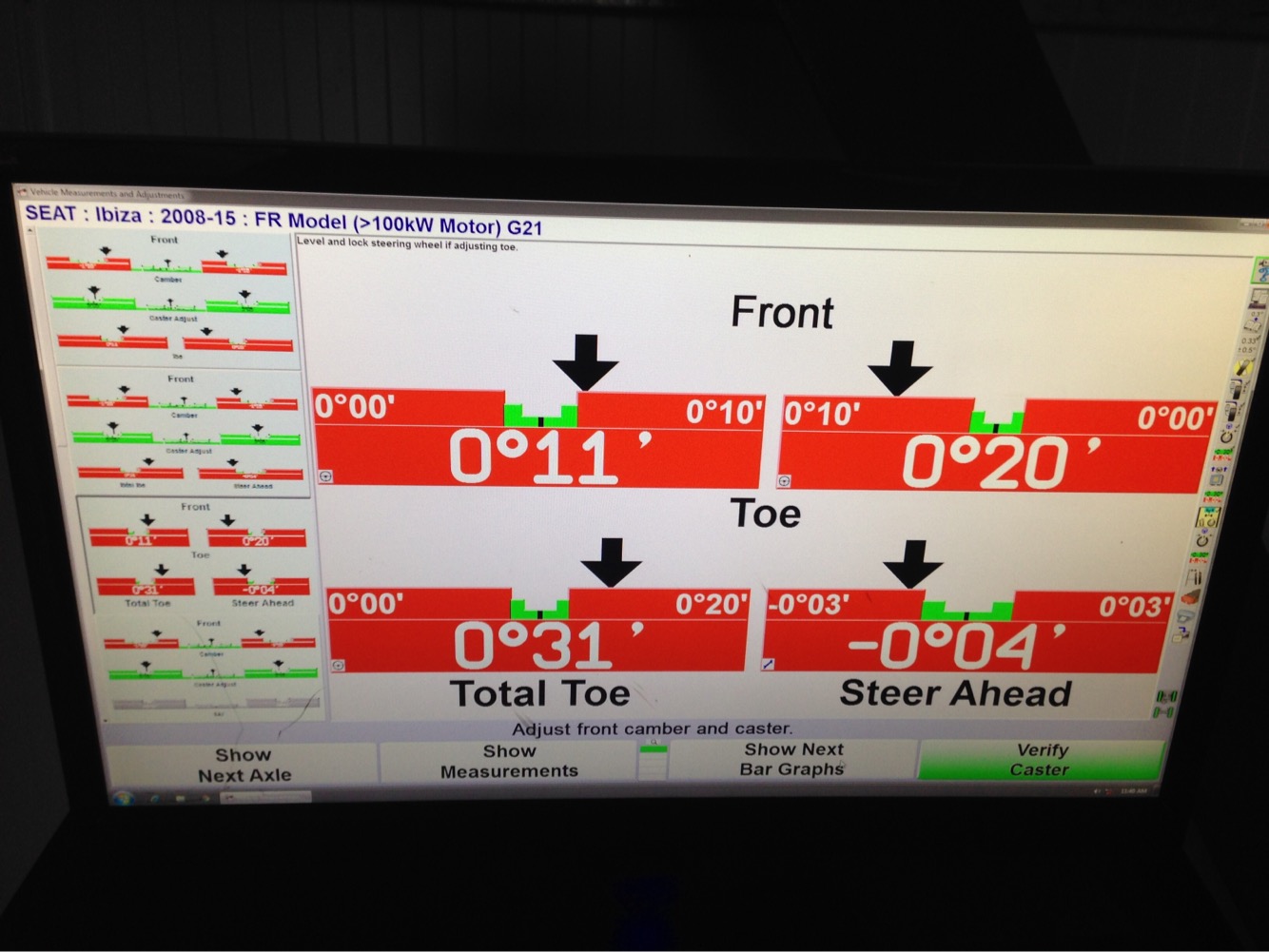

Car went for alignment today, somewhere new to me but really pleased with the work carried out. He tried varying tyre positions, done a steering angle calibration, gave me a road test to ensure I was happy, all using brand new equipment. A lot of confidence in the guy, really knows his stuff.
All green for go!

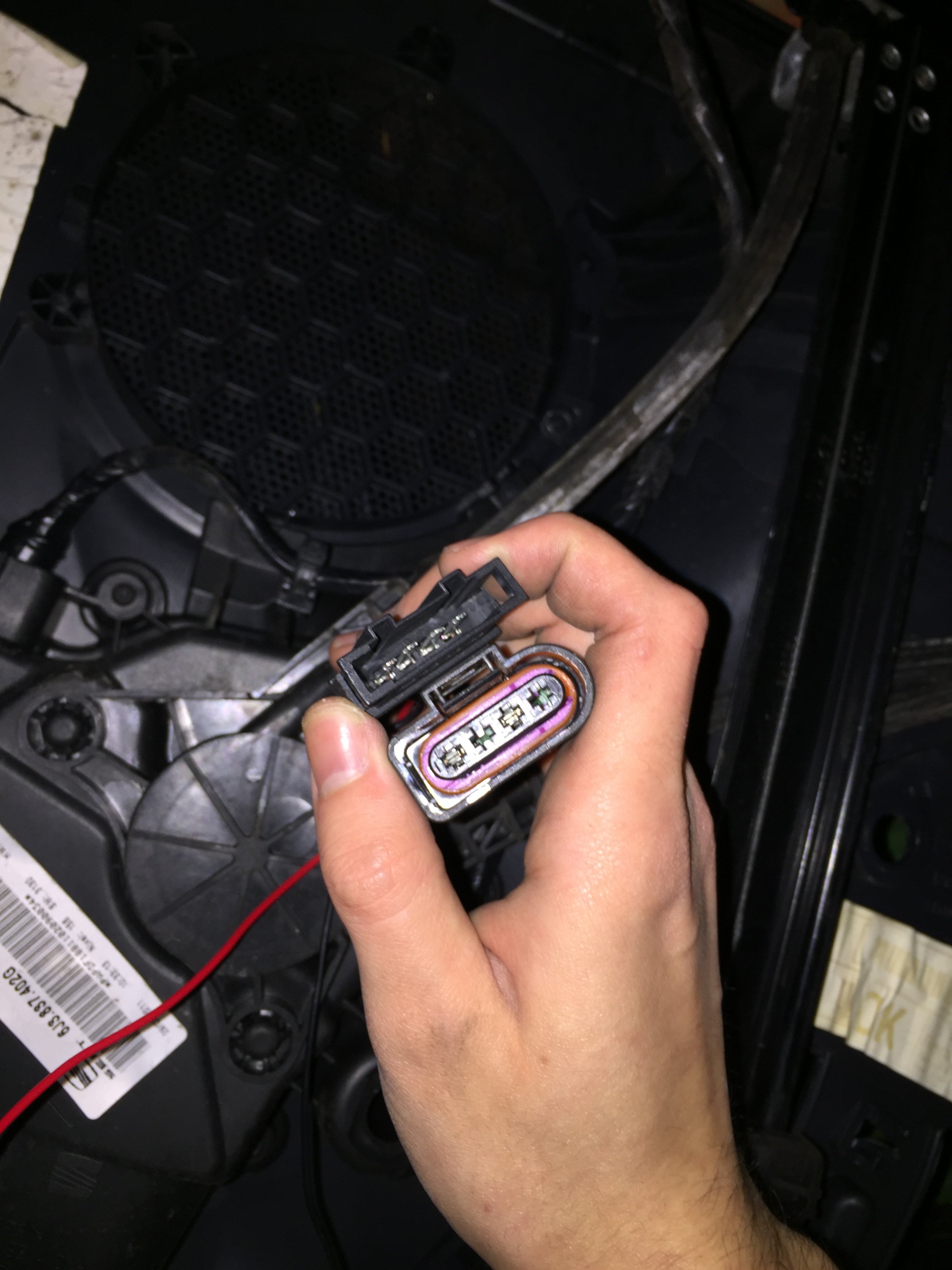

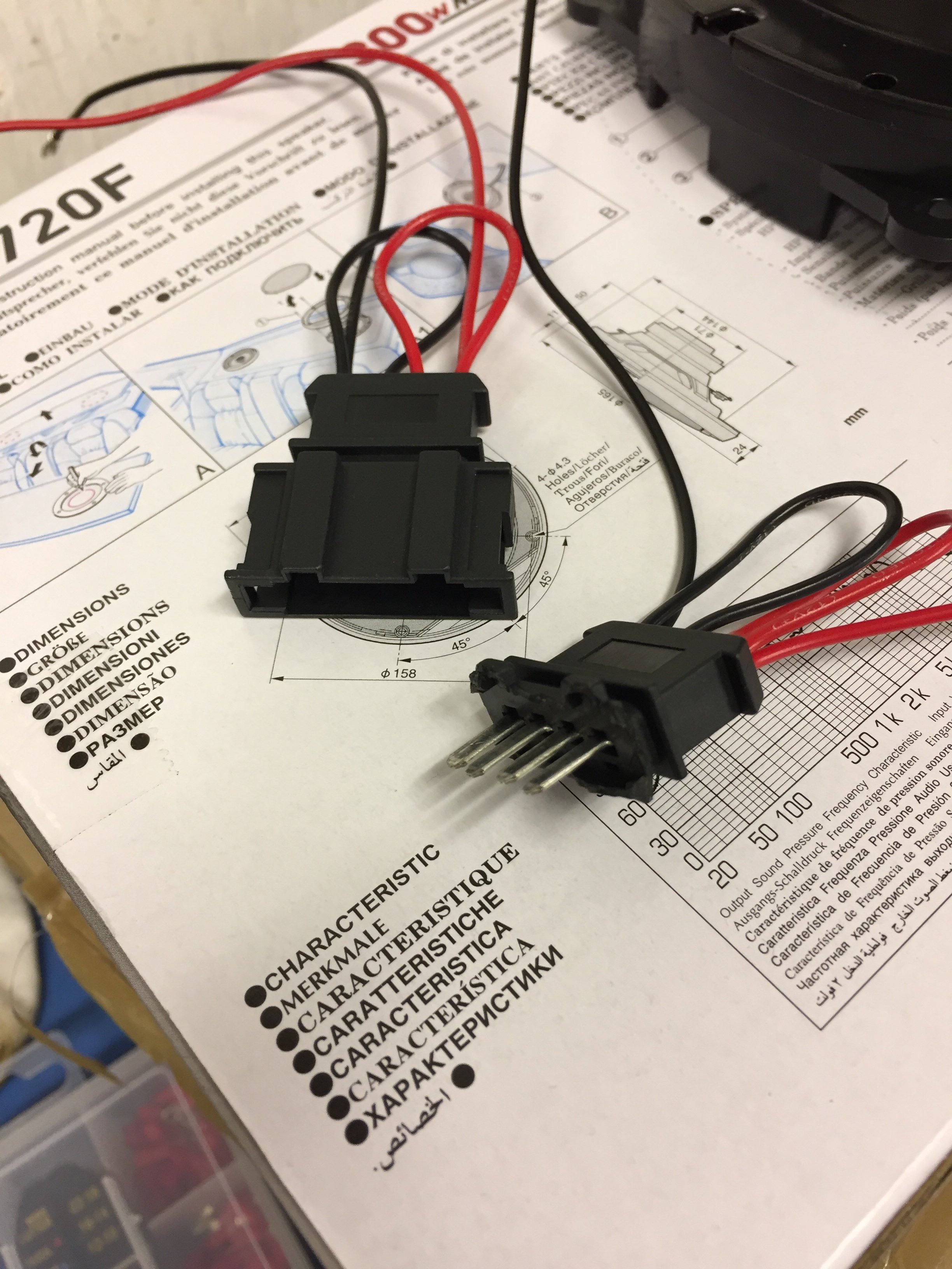

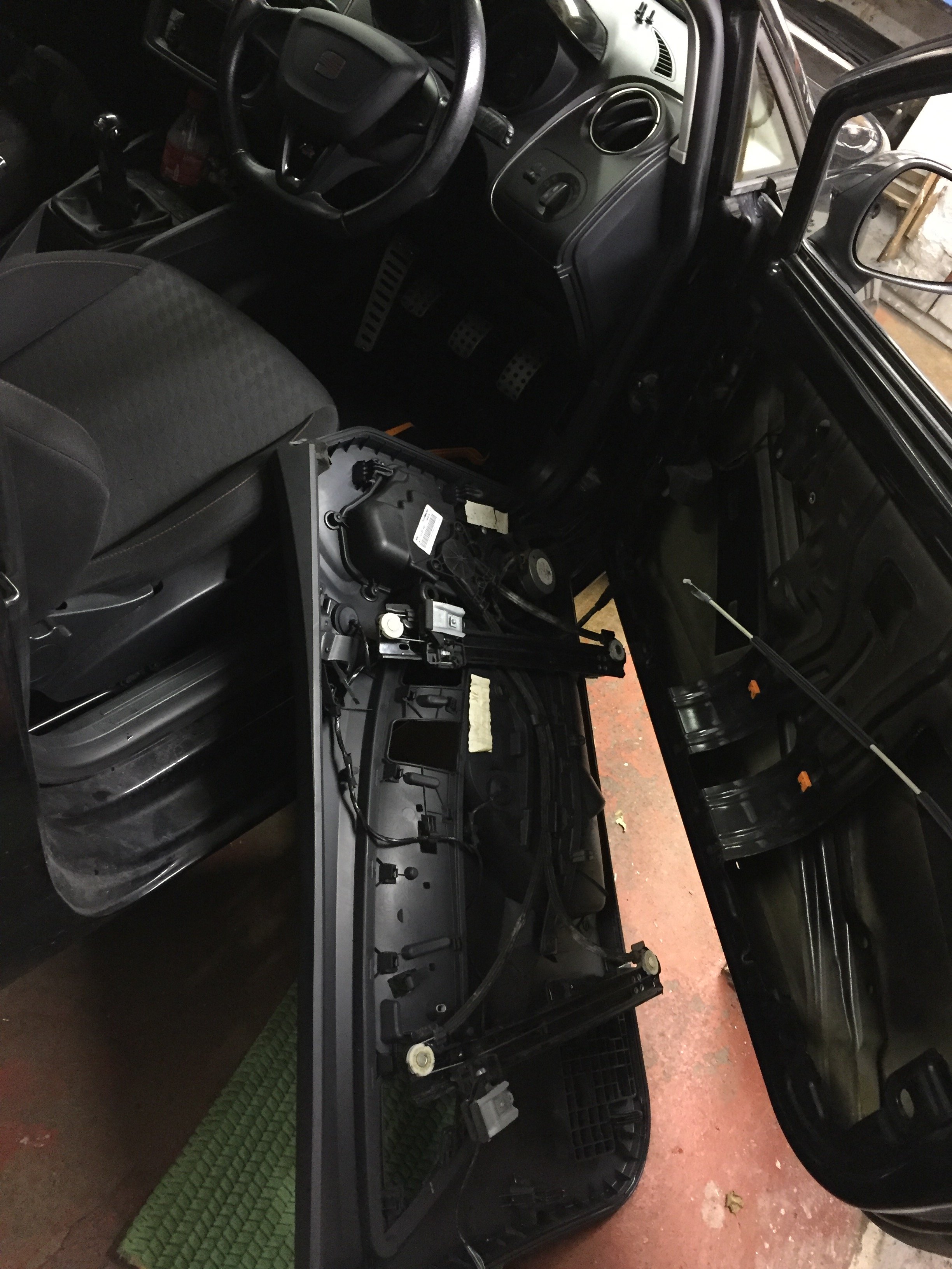

And the drivers doorcard came off! After a few hours of struggling I eventually got it all apart, only to find out the wiring adapters are for a 6L so now I’m completely stumped. Can’t seem to find any correct adapters online and I’m not very clued up on wiring/electronics. Abandoned the car in the garage and came away for dinner as it was getting cold outside. Frustrated as I don’t want to just buy an oem replacement, would rather upgrade.
Don’t want to even think about putting it back together.
Wrong f**king adapter

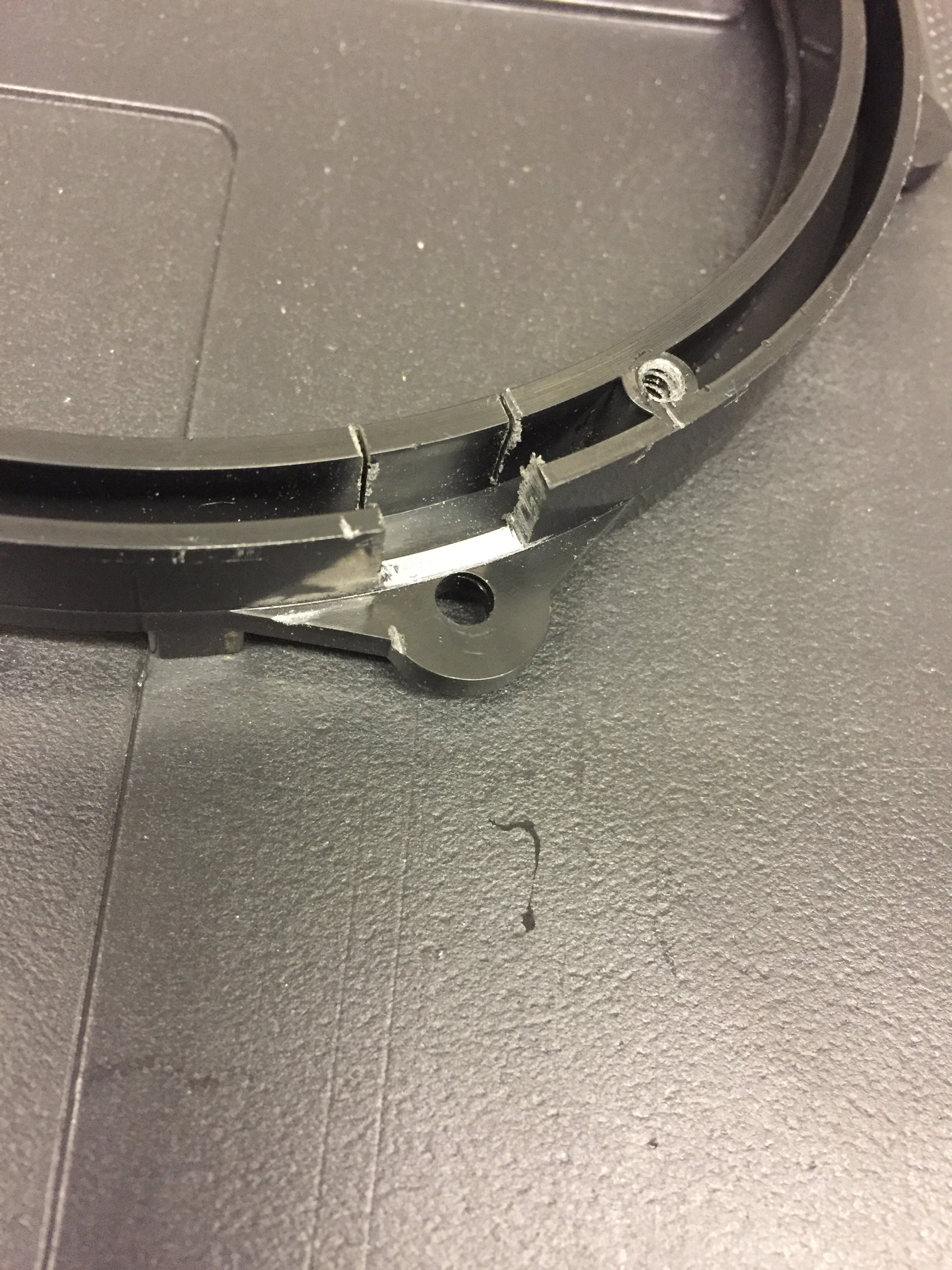

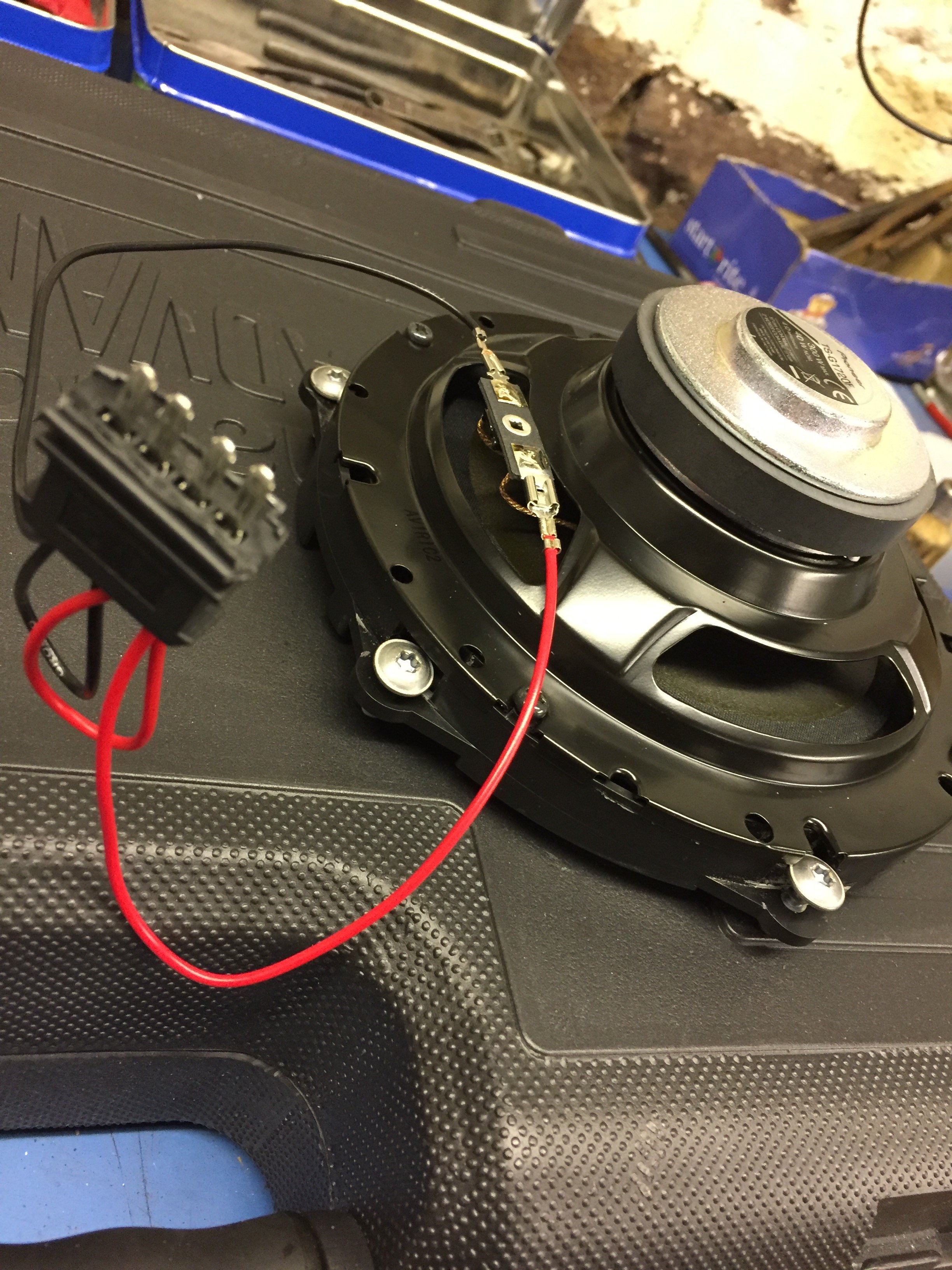

So I conquered my speaker installation problems! Using a bit of problem solving I managed to mod everything to make everything fit.
Speaker Installation Mods:
Firstly I cut the wiring adapter plastics away to expose the pins.

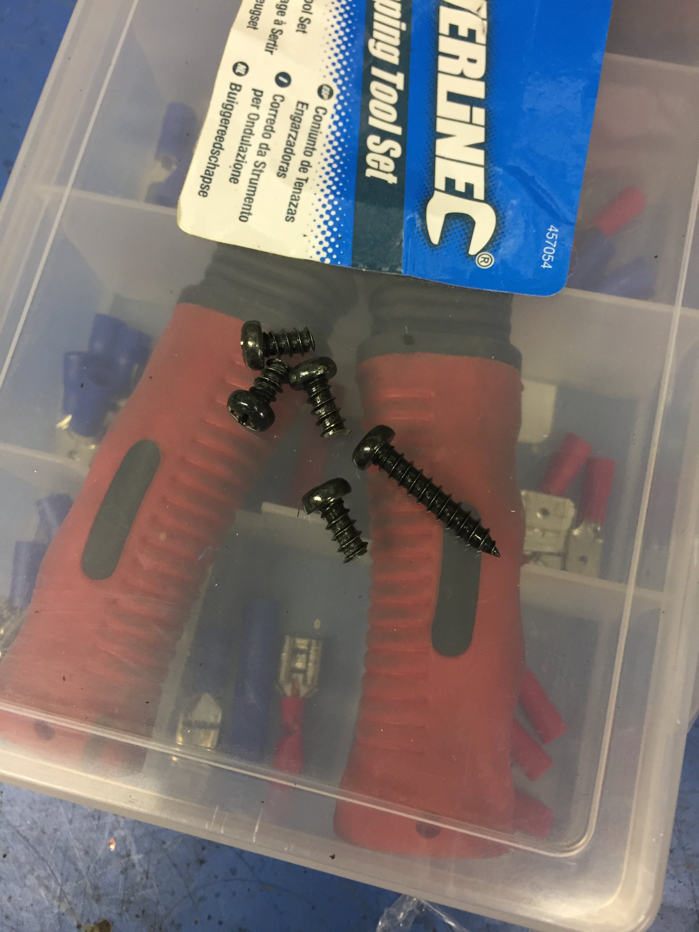

The speakers came with screws for fitting to other applications, but I cut them down and used them to attach the speakers to the plastic speaker adapter bracket. I left one screw full size till the end just to tap each hole with a thread.
The speaker adapters don’t come with enough room to use the oem torx screws to attach back to the doorcard, so had to become creative and make room, using a hacksaw to cut slits in the plastic, then broke away only the front layer of plastic which gave me sufficient room. I couldn’t avoid cutting the back layer but keeping it in place means it holds some rigidity. There are 6 places on each adapter that I had to do this for.
Screw the speaker to the adapter, fitted the torx screws through the adapter beforehand as they are kinda tight for the first few threads. Then attached the wiring adapter.
Plugged the speaker in and ensured it worked. Then screwed the speaker back to the doorcard, used a few cableties to keep everything tight as the last thing you want is an annoying rattle. I also put a cabletie around the connection so it can’t rattle loose too.
Began reassembling the doorcard back to the door using Techie’s guide again. I also put a bit of sound deadening on the door while it was all apart.

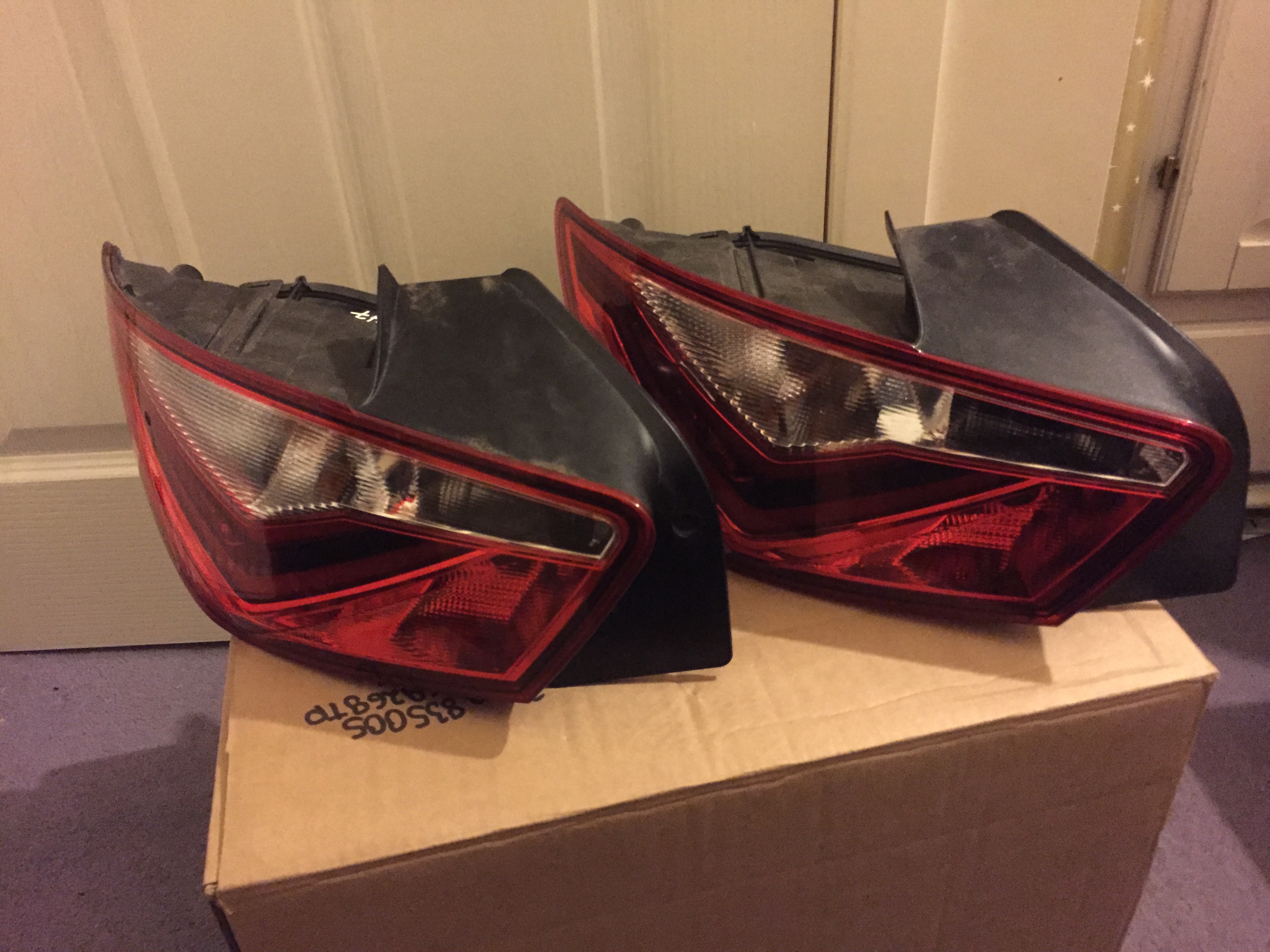

Rear Facelift Led Tailight(s):thumbup:
Now you’re thinking “Why the f:censored:k has he bought 2 left hand lights?”

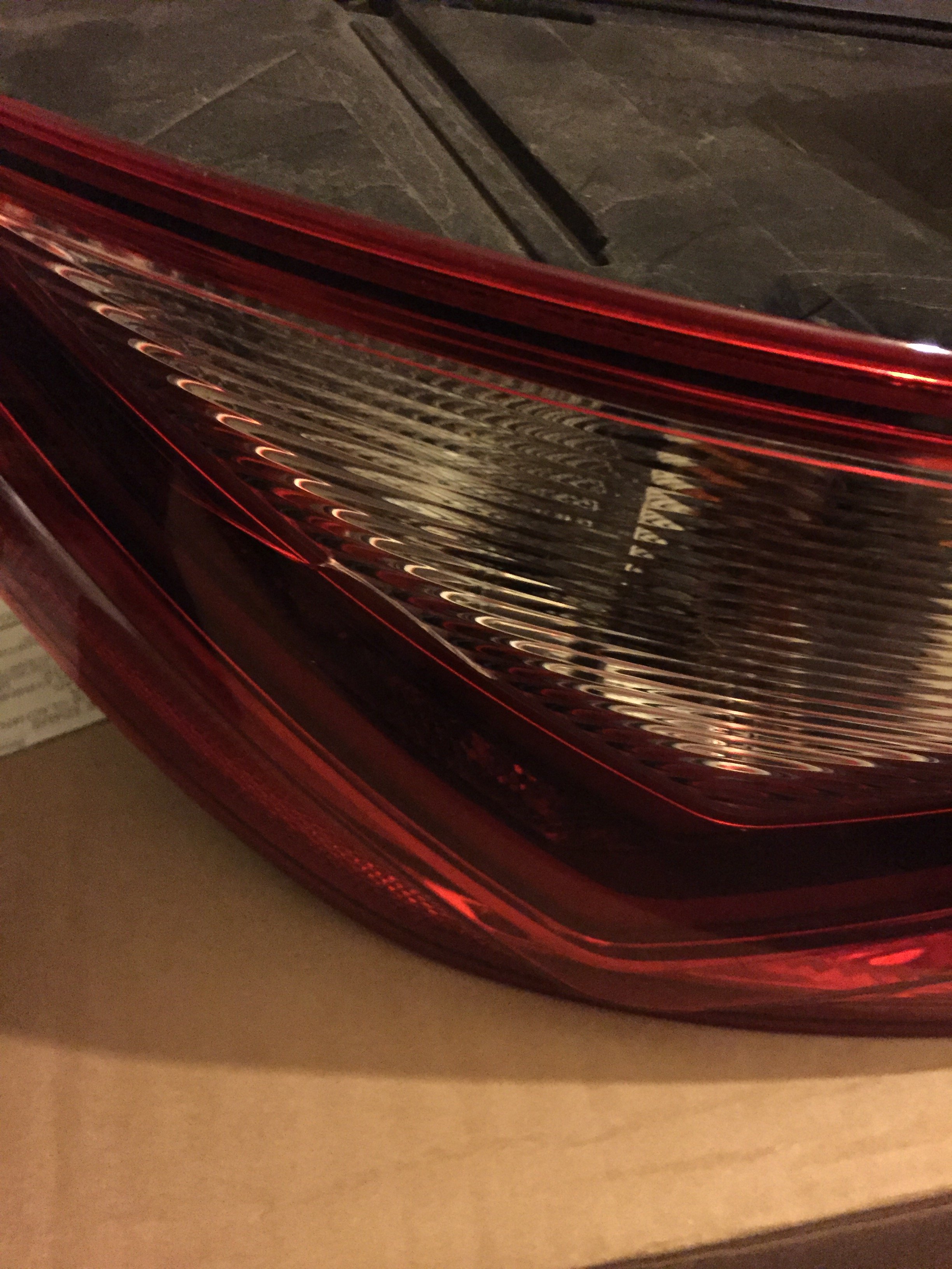

Welllllll, I bought a left hand light as it was listed for a bargain price off a breakers on Ebay, contacted them beforehand to ensure that the light was in perfect condition, they ensured me it was, light arrived in the post, really well packaged and...
It was cracked:banghead2 (not actually that bad but not ideal).
Immediately messaged them with proof of the crack and they said they would send a replacement free of charge! So now I have one in very good condition and one with a crack.
I actually missed the listing for the drivers side one.
I was watching it on Ebay but someone bought it while I was waiting for both sides to be listed. Still not too bothered as the light was at a price I couldn’t refuse.
Now it’s just a waiting game to find a cheap driver’s side!

So this week I managed to grab a second facelift light for another bargain price. Many people sell these for around £180 for a pair... I’ve managed to pay half in total just by being patient:thumbup:
Little Comparison:
Pre-facelift
Facelift
