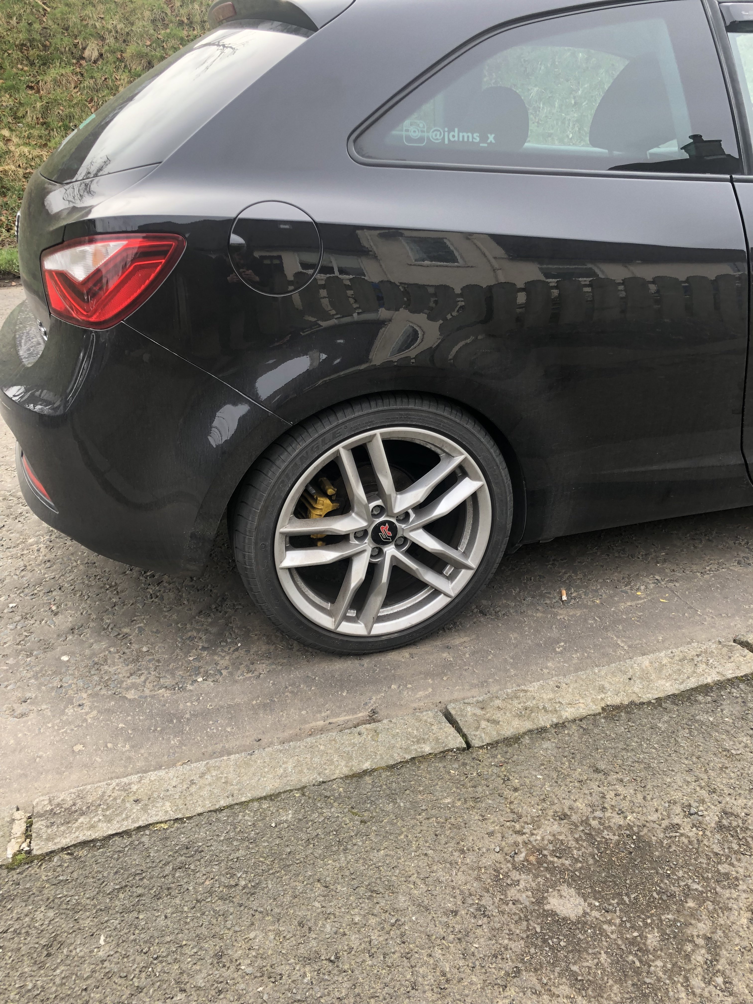

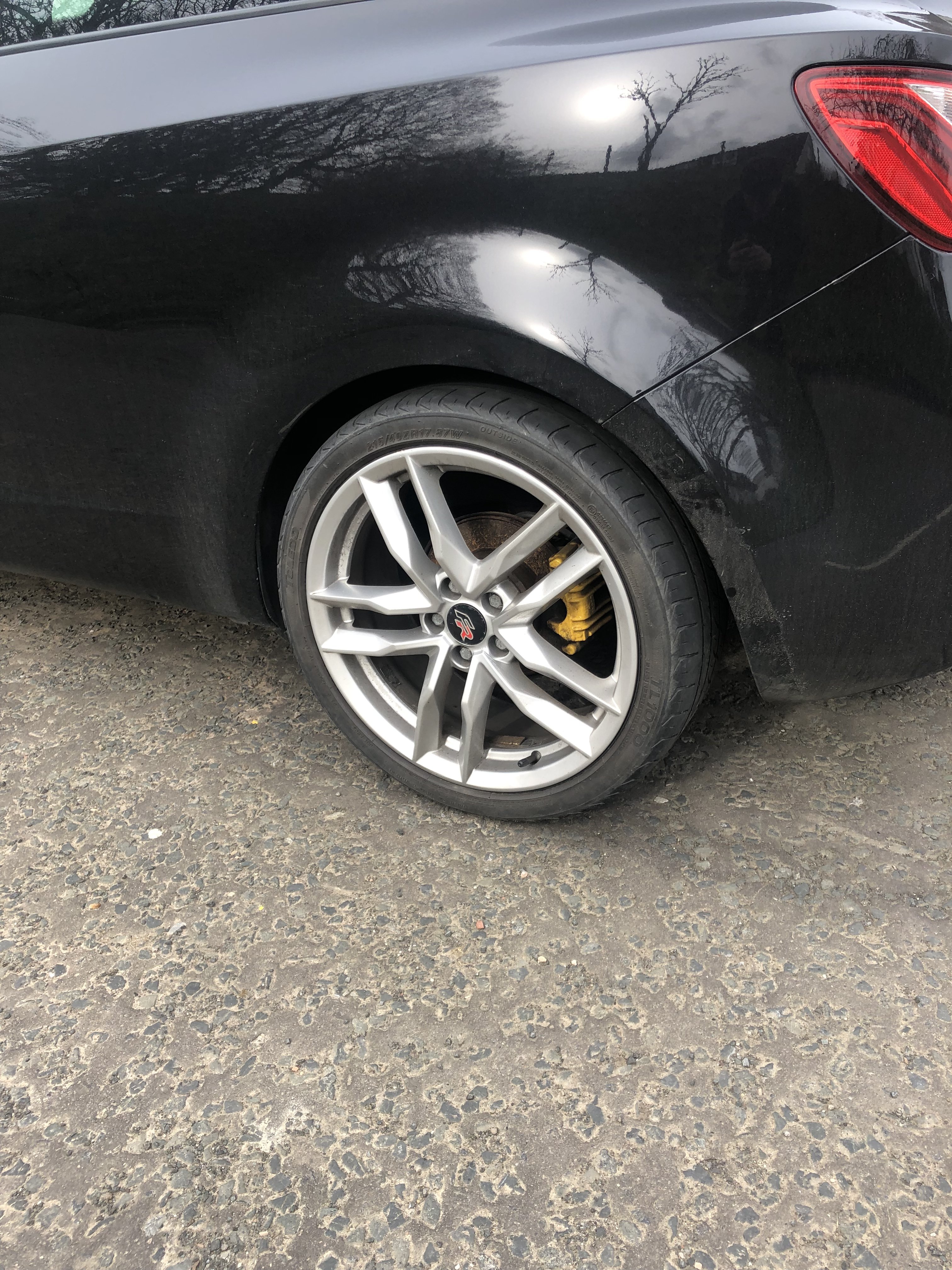

Changed my wheel spacers over from 20mm/25mm to 15mm/20mm as they were slightly too wide for my liking. Been looking over the height of the car and decided it could do with going a little lower so I wound the front coilovers down a touch. I noticed a while ago the rear height differentiates from drivers side to passenger side and it really annoys me as the coilover adjuster cups are both wound down to the bottom. Guessing the weight of the spare wheel and fuel tank affects the height (they both sit over to the drivers side) while only the exhaust sits over to the left. Drives me nuts! Hopefully I’ll have more to update in the near future with the skirts and spoiler on, but got a few busy months ahead. Girlfriend’s birthday this month, then April will be quiet in preparation for Wörthersee in May:cheeky:
Photos of the silly height difference and a few “portrait” mode photos on the new phone:
