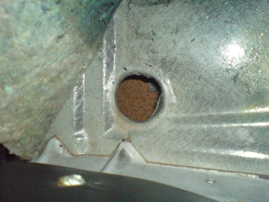

Over the weekend i stripped all the dash, seats and carpets etc out ready to assess the rust situations and its not looking to bad so far...thank god lol there's just abit of rust around 2 of the plug holes but nothing too major!
This is how the cars looking now...
The front seats and steering wheel are back in it now so i can still move it if needed but they'll be back out soon to sort the dreaded rust out!
The first pic looks worse than it is as there was a plug there before but i pushed it abit too hard :rolleyes: lol
The spots in the second pic aren't too bad atall and could get away with flatting them down and treating etc!

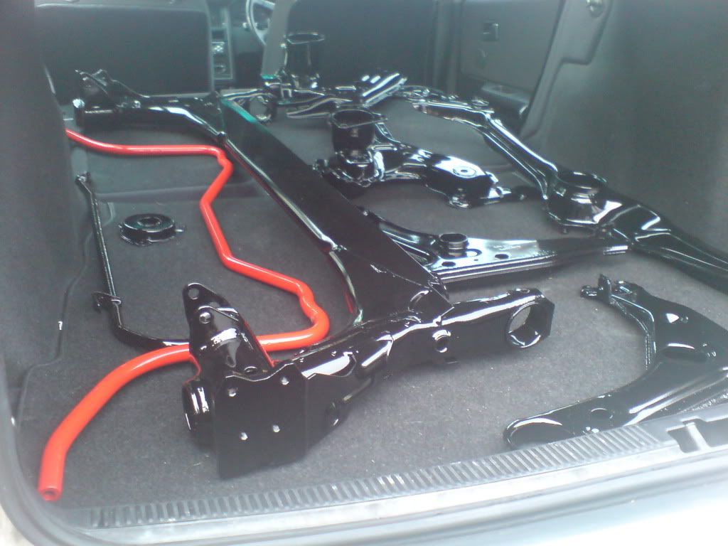

My bits are back from the powdercoaters :D nice to finally touch something without getting covered in dirty oil lol
Here they are in all there glory :p lol
Just need to get a few new bushes and drop links and i can get it all back together!

Thats the Ibiza rear beam I presume?
and ibiza front one + arms too ? what bits did ya join up for the shaft in the end ? 16v shares same size inner joint/box else that might help
i would guess a shaft + inner cv with a vr6 outer to match ya hubs if staying 5 stud

Arms look like VR6 ones to me:shrug:
Currently looking at a VR6 set up for mine, will need - VR6, hub uprights, VR6 wishbones, VR6 bearings, 16v hub flanges, 16v outer CV's, Passat drive shafts and inner CV's and passat tie rods and wider arches etc

As for the answers...I'm using the complete standard VR6 front end:- front and rear crossmembers (which are exactly the same as the Ibiza ones), VR6 wishbones, driveshafts, VR6 5 stud Hubs, ARB and brakes. Reason for this is because it looks stronger, better quality and its slightly wider but will have to roll and pull arches to make it fit lol :p can also use the original ABS unit, sensors and rings so i dont have to buy or modify anything!
At the back i'm using standard Ibiza subframe, VR6 stub axles spaced about 25-30mm between subframe and stub axle, welded up aswel for extra precaution (save fcuking about with hubcentric spacers), VR6 rear brakes (same as Ibiza again) and lots of rolling and pulling to get it to fit!
I want to use standard VAG bushes etc all round at first so when i do change to polybushes i can see/feel and compare the differences they "should" make, same with the suspension and ARBs...will use standard VR6 front struts, standard Ibiza GTI rears and original ARBs see what it handles like, then will probably go for lowering springs because i'll want it low ASAP then eventually coilies or a nice spring/damper combo, along with uprated ARBs!
