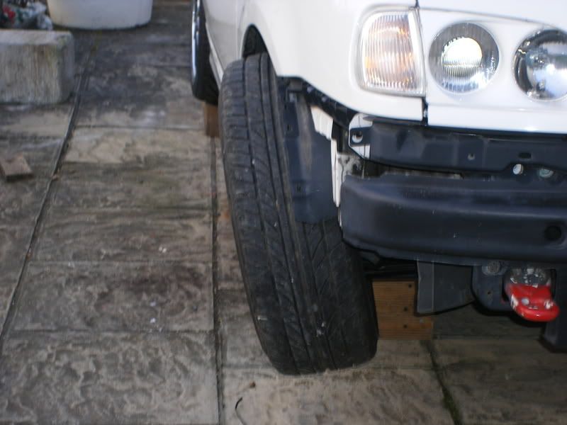

right here goes put the lower arm on the car and ball joint, put the wheel on and this is the angle im faced with, the toe on the wheel is where ive turned the steering its the massive camber now, i've been told i need a new hub, as the casting may be bent
Passenger side Normal
Drivers side Fubared
Any ideas as im begining to lose interest in the car now and im thinking about getting rid
did you bend the hub?? i know its like cast iron but still , have you tried pushing in the the top of the hub closer to the coilover leg and pulling out the bottom one ?? that should level it out
