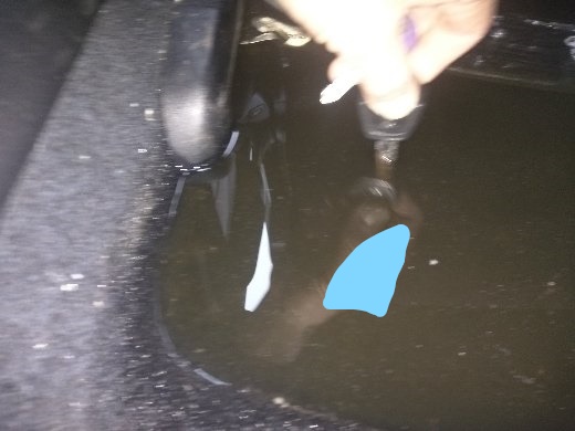

I'll take some pics tomorrow as I'll be doing it to this Leon too. Got it back home and wow....2 inch of water in the rear pass foot well. Door seals are bone dry on pass side, driver side wet....so must be coming through the dash/pollen filter route. Stripping it down tomorrow so I'll take some pics.

About 1 or 2 inch of water. Pass side rear.
Sent from my Nexus 6 using Tapatalk
That's pretty much what mine looked like a couple of years ago. When I could hear the water sloshing around while I was driving, that's probably a sign to sort it out.
When I parked on a hill, I could get a litre jug in there and fill it up a few times over.
