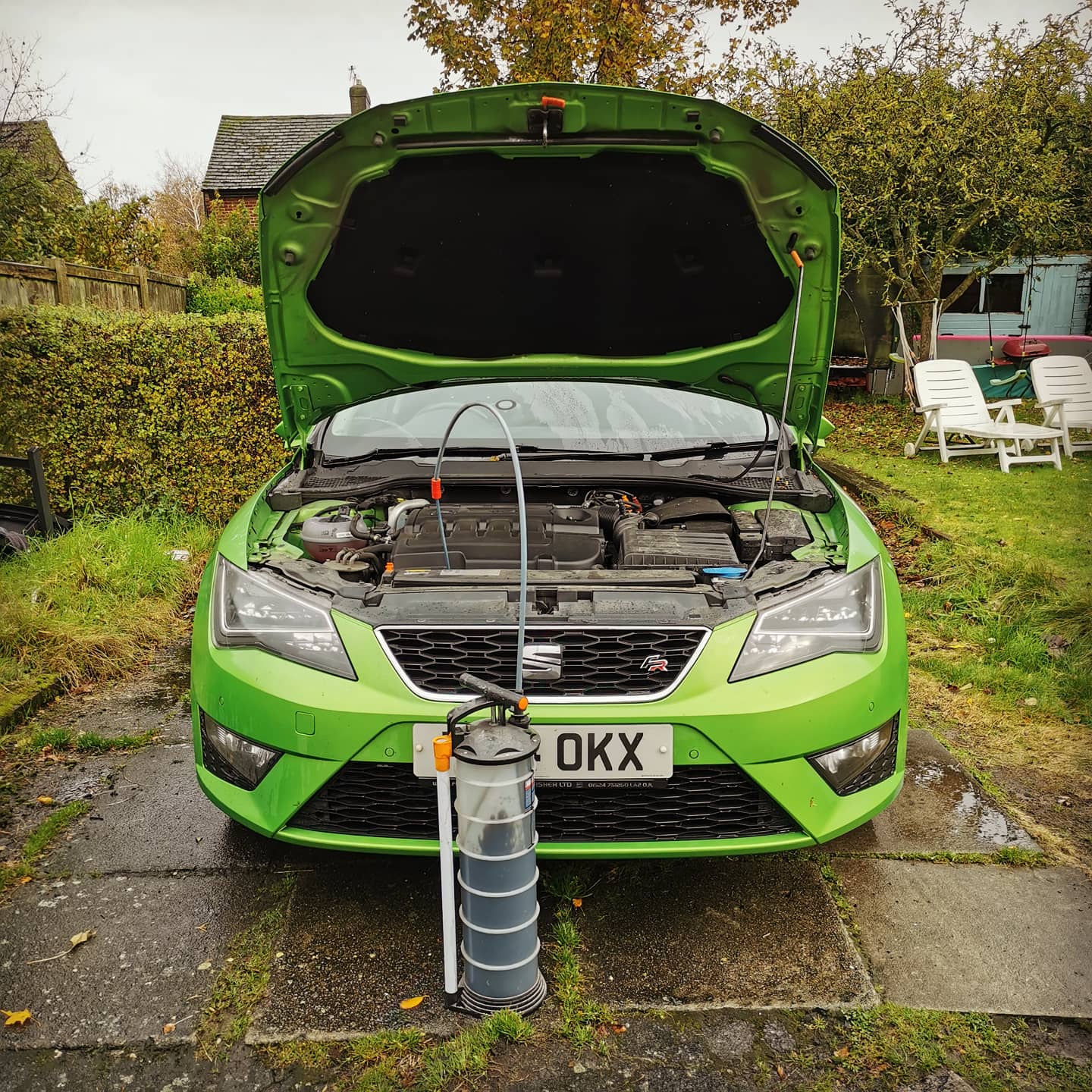

Interim oil change at 6,000 mile interval. The 'other' change gets done properly via the sump and gets all the filters changed. Filled back up with Castrol Edge Professional Titanium (very cheap on Amazon at the moment for the rare 5L bottle).
