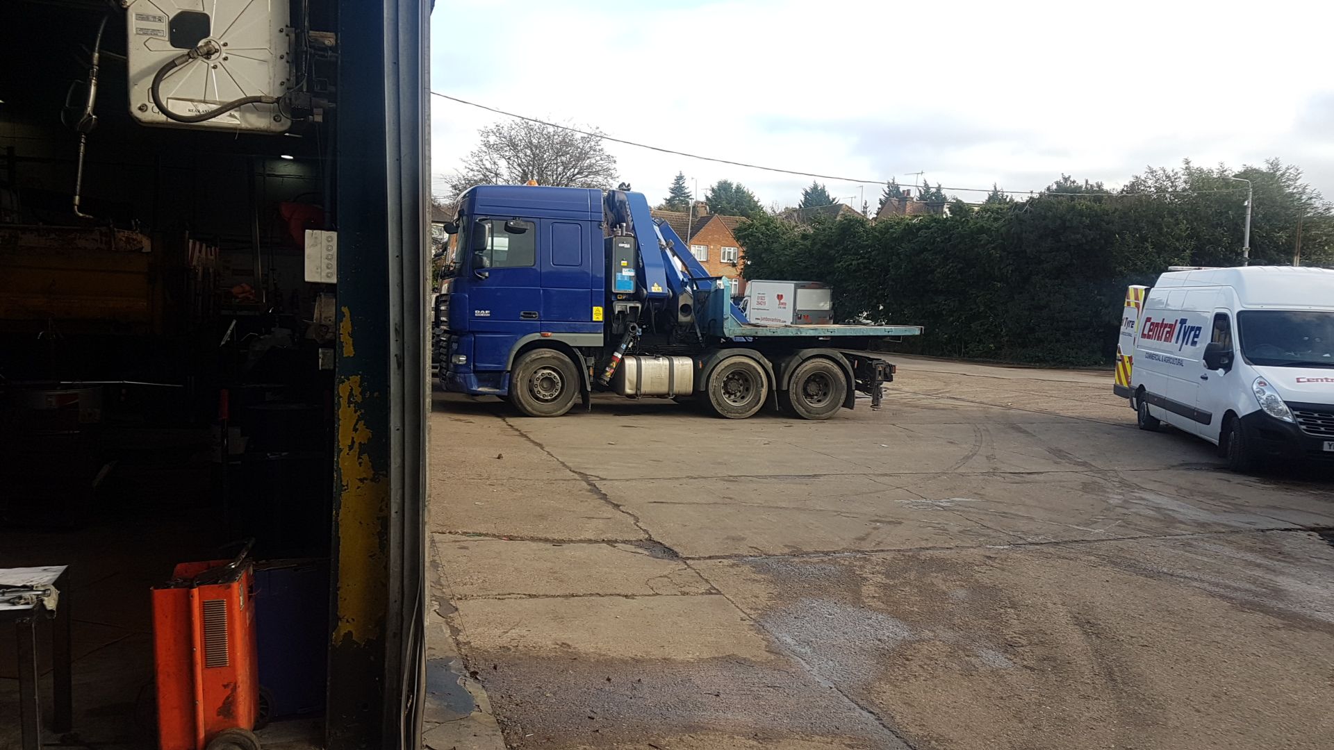

The old and the erm well old but not broken side by side..... about 6 tons of engine and 960bhp lol(together) also the old engine had 994,670km and the replacement he 857,000km haha I just worn in lolView attachment 20029
One under the bonnet, one in the boot. Proper permanent four wheel drive.
It's from a DAF xf 480bhp
