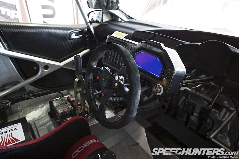

Hopefully look some thing like this

Very nice ?
What happens when the car is finished?
General track days or is there a class that you'll be racing in?
No expense spared by the looks of things.

Very nice ?
Rich
Its being built to be a purpose built racecar There is a few classes it should fit in to. It's now just getting time to carry on. But again when lock down is over all are welcome to come and help lol
