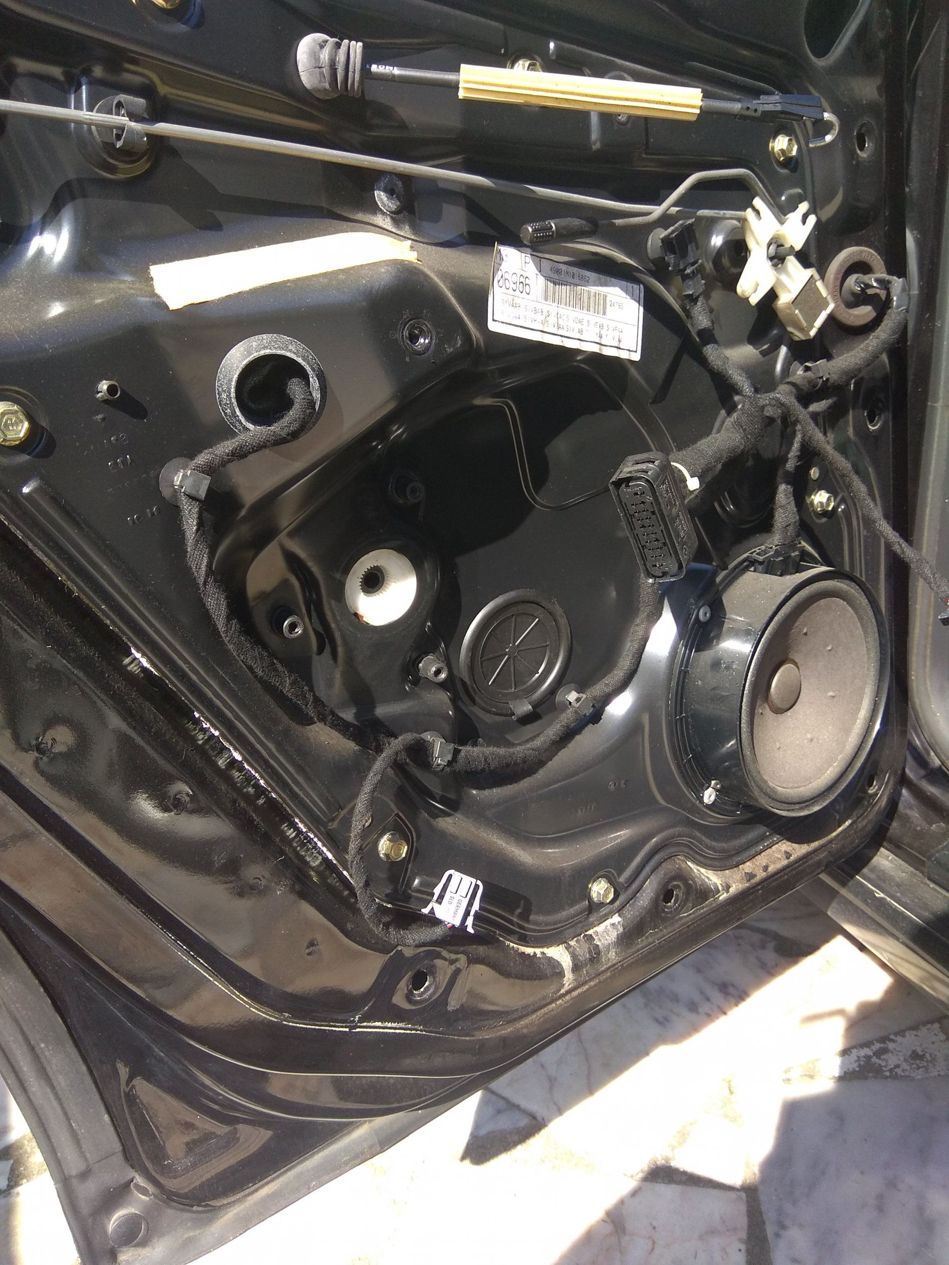

Light at the end of the tunnel….……
So went back to trying to get front doors to open, both still locked shut and not opening with keyfob or buttons inside - had a “moment” and thumped the drivers door handle and guess what, drivers door now opens
Still can’t get passenger door to open tho
