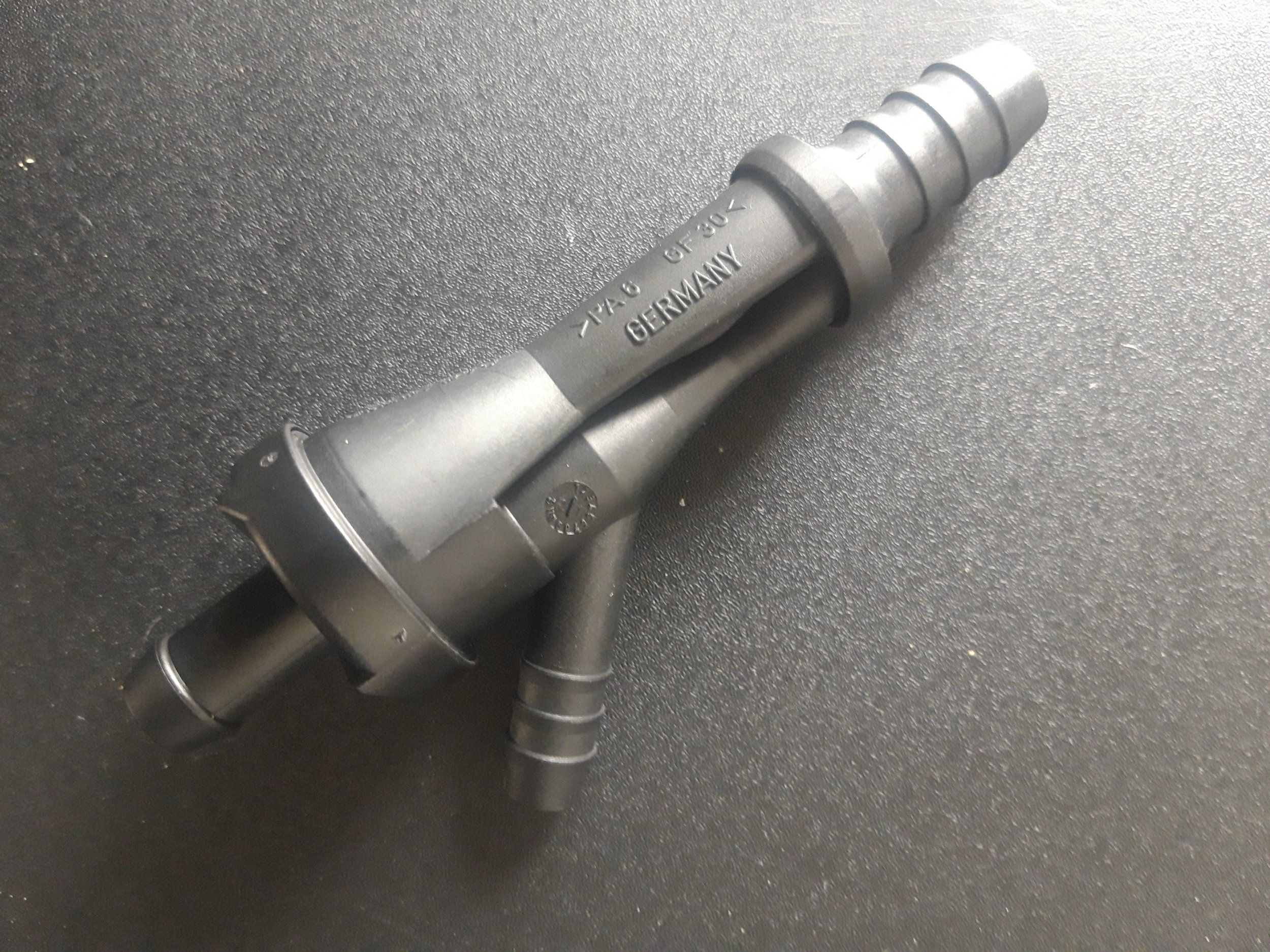

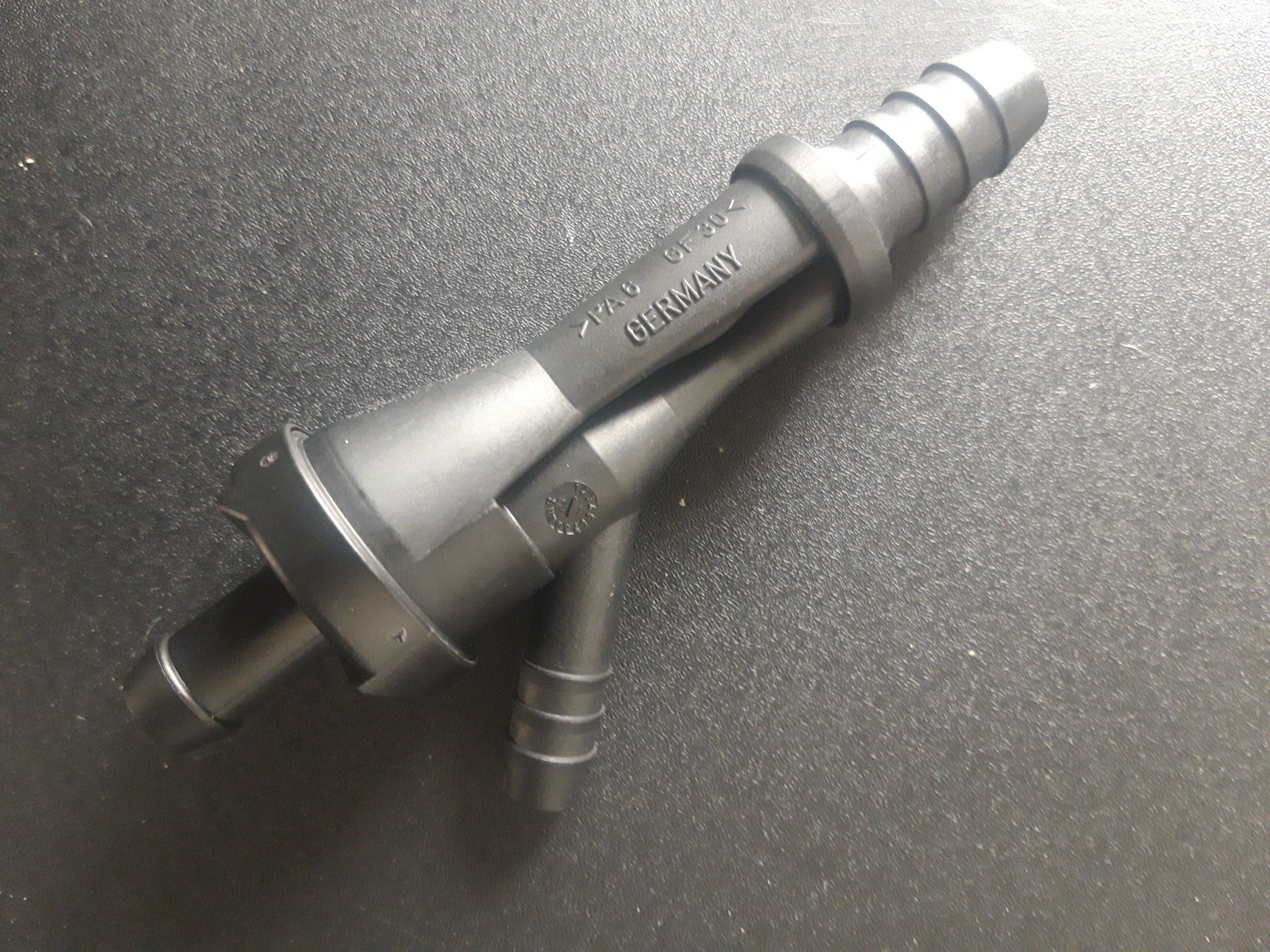

So, the post above relates to a valve fitted into the pcv system that im refitting to my car as i cant get on with the catch tank setup.
Wasnt convinced that when i sucked and blew on one of the pipes that the valve shouldn't fully shut off and ordered a new one from TPS.
Turned up today and gave it the suck/blow test and the new one fully shuts off.
The moral to this story is, if your running a standard system and your not busy spending money on door locks, window regulators and butyl tape you should buy one for peace of mind.
Rich
Rich
