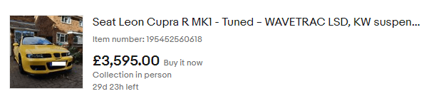

Put my number 1 Cupra R up for sale today :( She cleans up nice, now wondering what I'm doing but she's gotta go (Number 2 Cupra R has emptied the coffers!)....
I'll drop the advert in the For Sale section and no I'm not breaking it :whistle:
Reactions: Nam-uk
Put my number 1 Cupra R up for sale today :( She cleans up nice, now wondering what I'm doing but she's gotta go (Number 2 Cupra R has emptied the coffers!)....View attachment 34331
Good luck with the sale! Looks like money has been spent in the right places and new owner will get a well maintained car.
