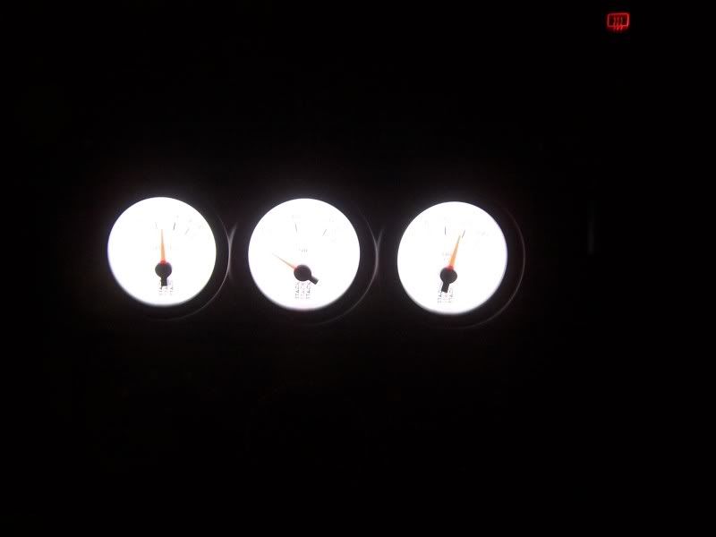

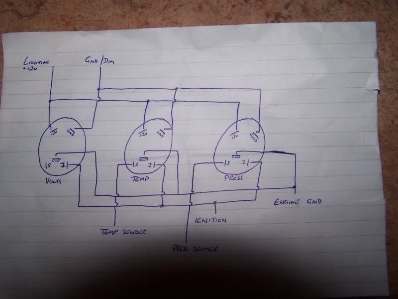

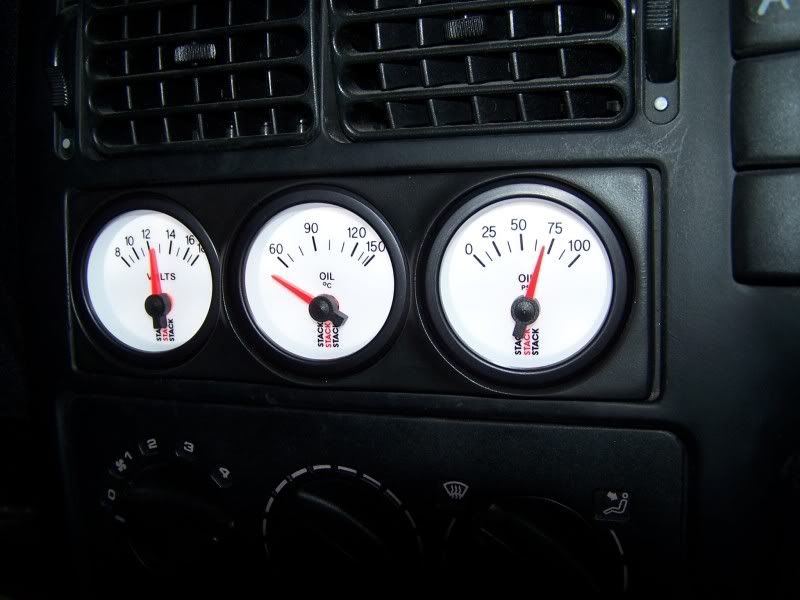

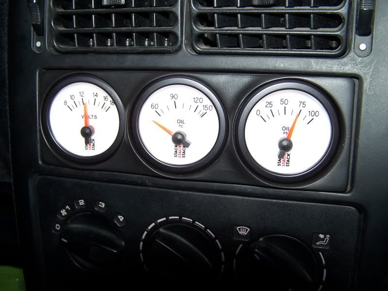

Bit more to update, when the rain stopped I decided to finish what I started with the gauges. Here's a few pics but they were taken in the dark, I will take some better ones in the morning.
The Oil Temp isn't working yet because the sender isn't fitted yet, got a new sump plug wiv a female thread for the sender to go into to. The wire is there but will fit the sender when I do a oil change next week but the Voltage and Oil Pressure is working.
Here's a diagram I drew up quickly in work on my break this morning
No more CD Player... the engine is the best soundtrack you can get :)
Give you an idea when they lit at night
The flash on the camrea doesn't show them lit up but shows them more clear

Is 75psi on start up good or bad? Got to start learning when there should be high pressure and low, when I rev it slightly (up to 4k max) it goes to almost 100 psi
