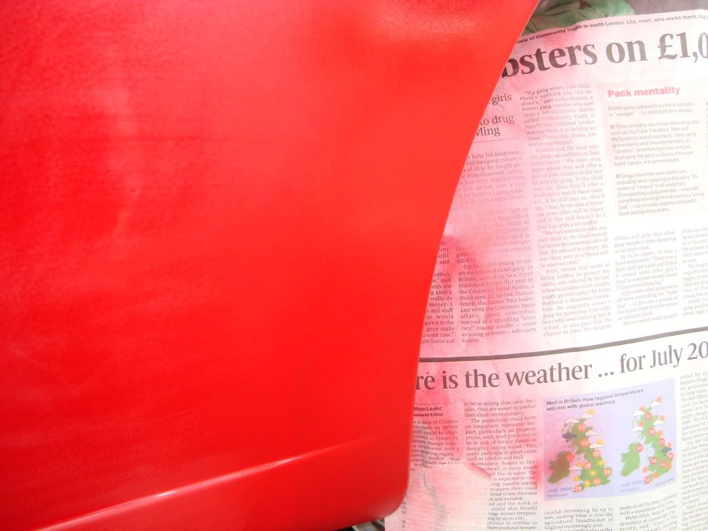

Arun, or anyone else with tips, what do I do to the 3 - 4 coats I've applied? Sand it down to a matt finish with 1500 wet 'n' dry is it? Anything else? Got a little cocky on the last coat earlier - dripped a tiny bit on the line of the wheelarch - will have to sort that out 2morrow.

yeah use 1200-1500 wet and dry, but make sure its wet lol, don't worry about the drip it'll come out after gentle sanding and lacquer....
use plenty of water with the sandpaper and make sure the finish is matt, make sure you dont rub over it to much or the whole paint will come off lol,
wipe it down with a clean cloth, then lacquer, two coats of that.

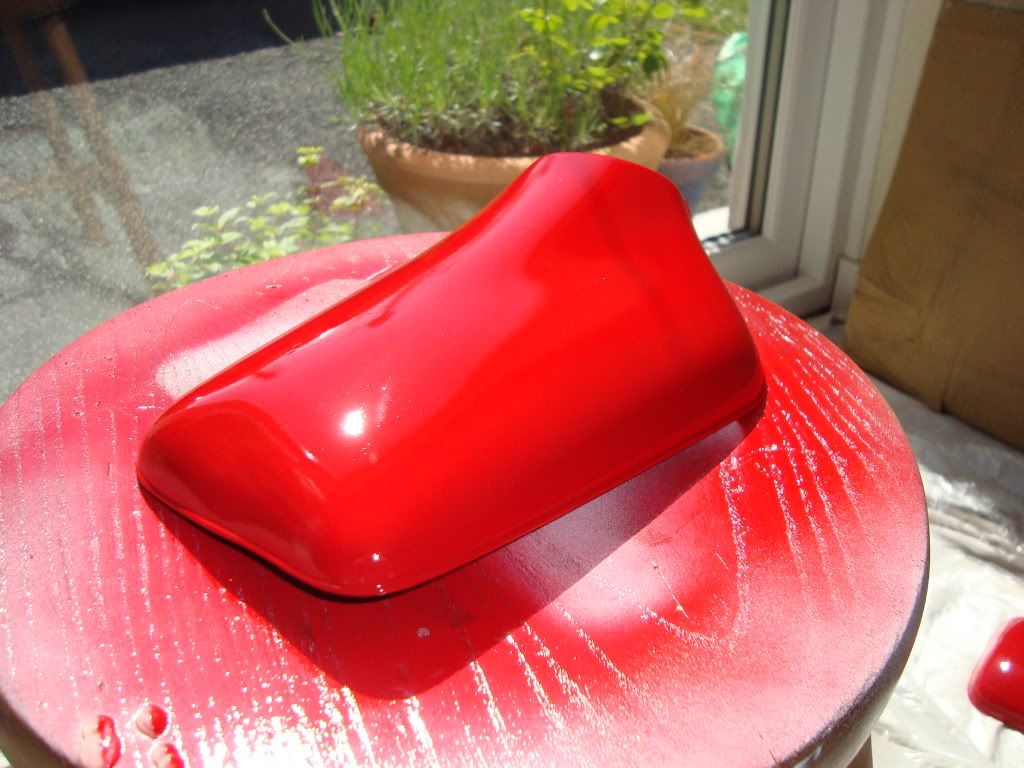

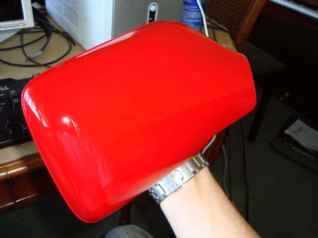

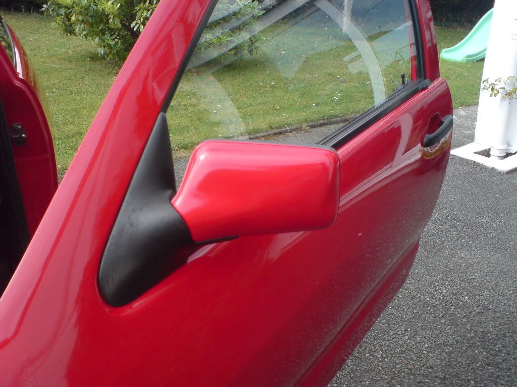

Right - it's a lovely day as hoped, been watching a bit of Wimbledon and rubbed down my wing mirrors. I had painted these about a year ago - but hadn't got around to lacquering them... so 2 wing mirrors were ideal to practise on!... :p
This is them before I lacquered them (a year ago, by the way - car looks rather pinky when I use the Fuji, doesn't do it much justice);
I'm really pleased with the driver's side mirror, and I'm happy with the pass. side too. I will say this though - make sure that when you spray outside - that there isn't any breeze at all lol, a little draft came around the corner where I was spraying and a tiny black bit stuck to the mirror just before I took it in on the stool I was working on... aah well :p
Driver's side;
Let you know how I get on with the rear panel later :)

This is the other (pass. mirror cover);

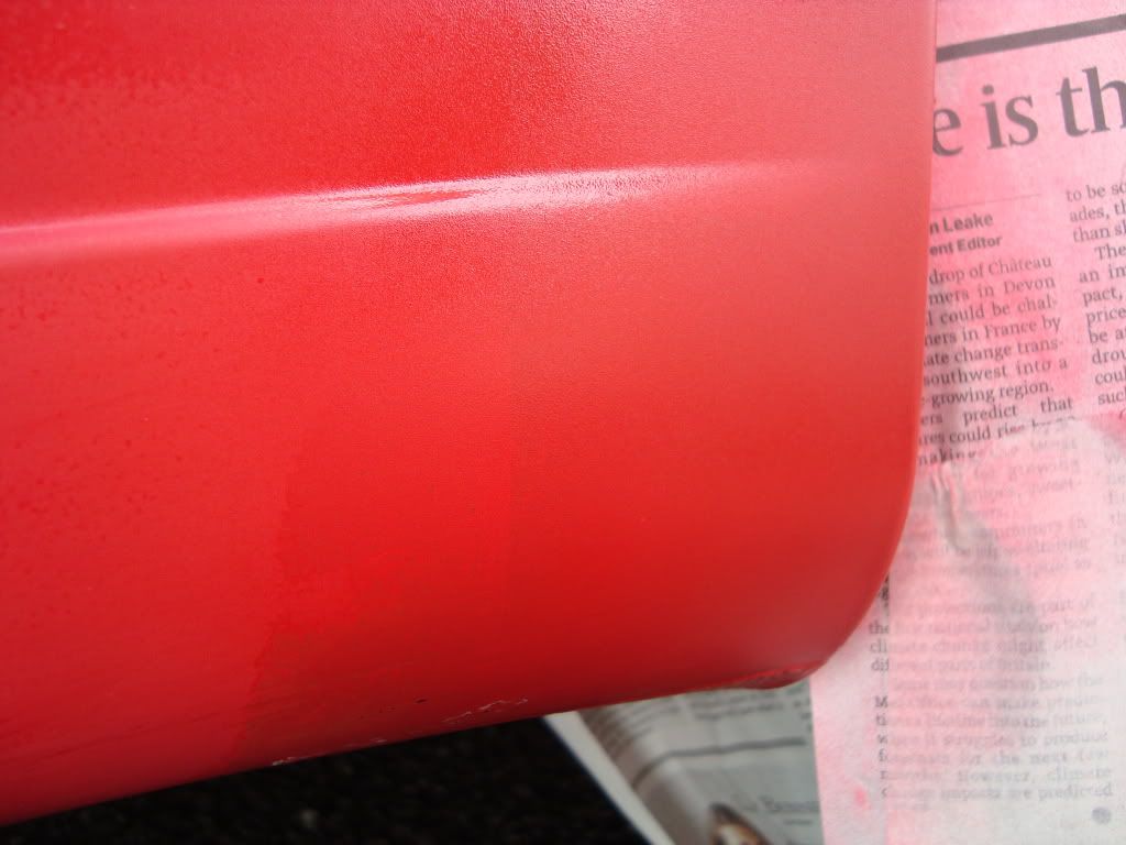

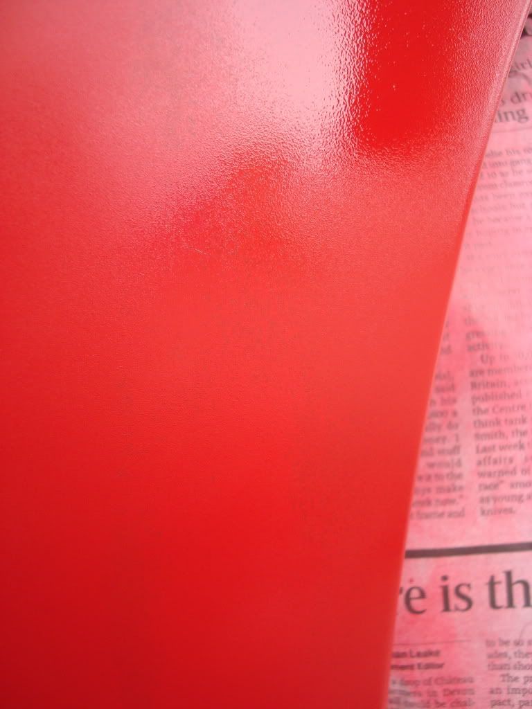

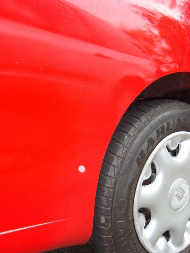

Considering that I'm doing this with no more than a couple of Aerosols, I have to say - I'm pretty impressed. Although - I had a can of Red Primer hanging about in the shed - so I used that on the scratch to cover the filler and bare metal. After 3 - 4 coats of Tornado Red yesterday, I managed to sand it lightly with 1500 earlier, I'm pretty happy with the result, looks smooth and in a matt finish ready for painting!... BUUUT - where there's overspray of primer and Y3D - there's still speckles of red primer showing through where it's primed ontop of OK bodywork...
If I make sure that I don't lacquer it that much, is it possible, when all dry in about 2 weeks, to T-cut all that sh*t off? Just brings to whole restoration down a bit :shrug:
Help!
Some pics; (you have to look pretty closely)
(It looks dirt-like. It's the primer overspray on the Tornado).
Skirt;
lmao, told you lacquers a b*stard.......btw youve done a good job of the mirrors, how did you get them off, i want to do mine tornado red or gloss black
just yank them off carefully. Fold them in - then they come off. 4 catches hold them against the metal diagphram. Yehaa I know :( what now? Rub it down? Lacquer again?
best thing to do would be 1200-1500 wet sand, then lacquer again,
i think it would be better to get it thicker than thinner, because when its thick it still shines although be careful of drips, when its to thin it looks rough, which is probably worse
definate! You know why it did drip though... cause there was a bit of a breeze! I shouldn't have done it, I knew even before I started! Need to do it in a garage, it was spraying unevenly over the bodywork. Sometimes too little, sometimes too much. All in all - there's 3 minor drips... It's not THAT bad though after all.

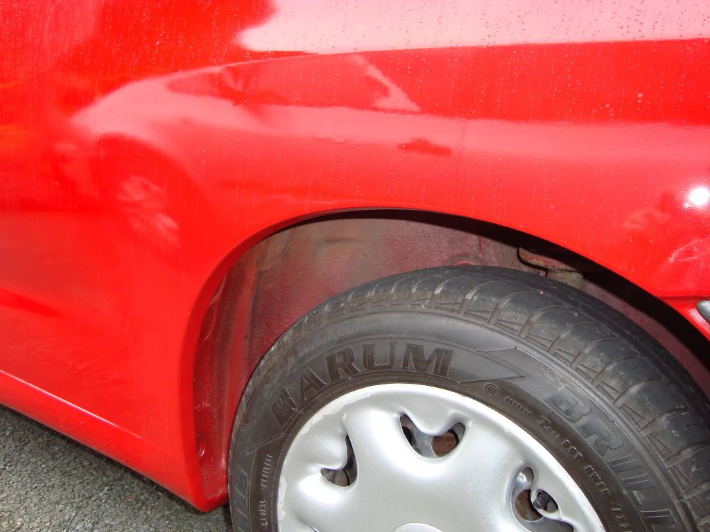

Riiight - been some time now. Thought I'd bump my thread up with pics of the finished repair. I managed to correct the lacquer - and it looks pretty good I must say :)
Need to T-Cut it in lightly into the rest of the bodywork in about 2 - 3 weeks time :) but nah - it looks acceptable until then imo...
