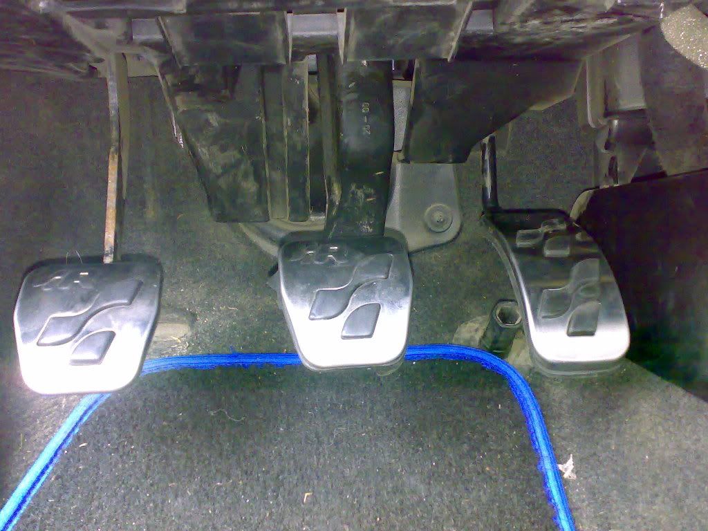

R32 pedals

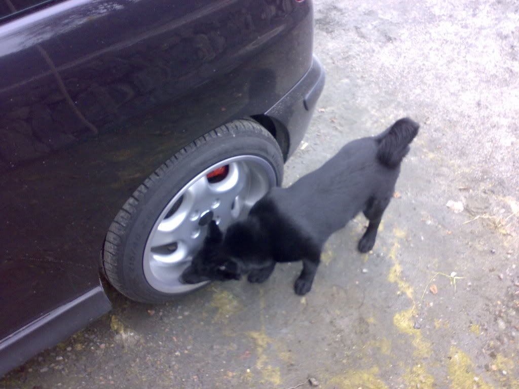

litle help from the dog
cleaning my wheels!
attacking me :S playfull ;)

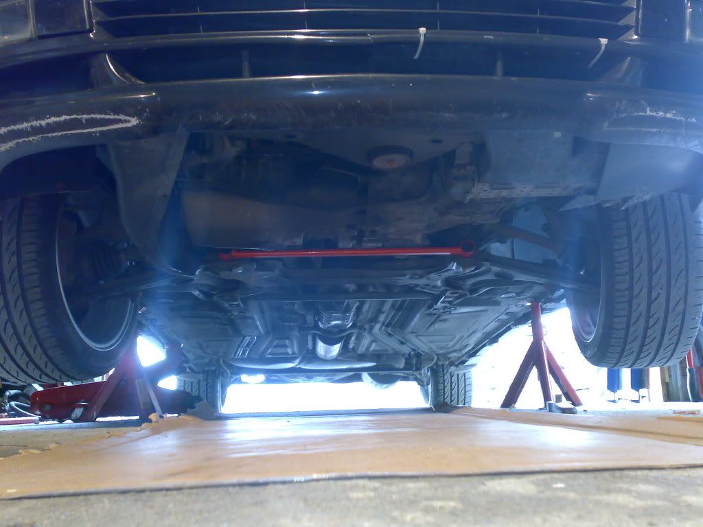

OMP Rear strutbrace golf mk1
OMP front lower strutbrace golf mk2
