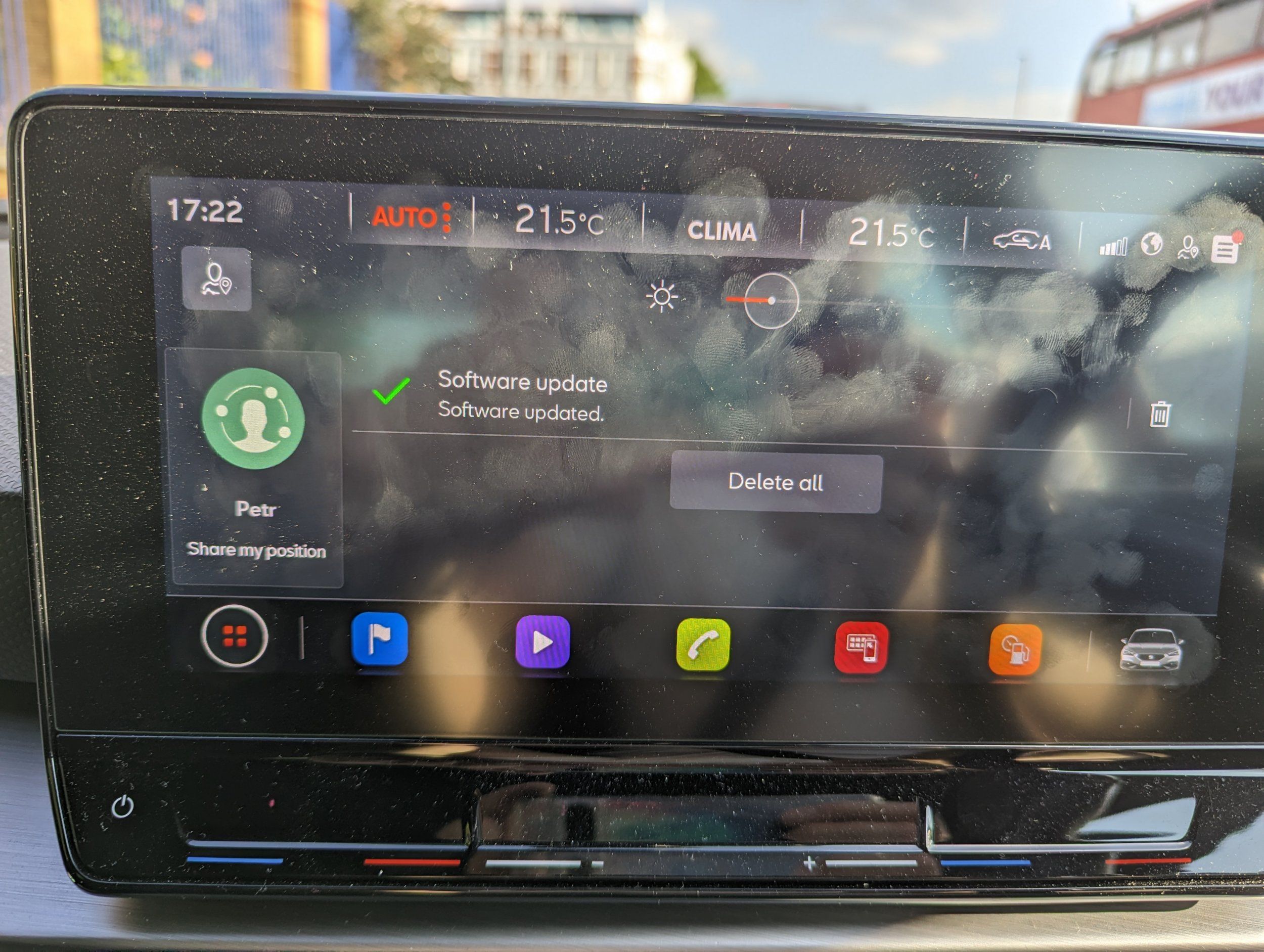

After confirming huge update which was downloading for two days i thought i will have finally some further updates from 1896 to 1900? but unfortunately after clicking the successful update nothing has changed version still sitting at 1896? possibly just the online store has major update
Might fix the rebooting issue! Argh who am I kidding ??
Haha seems to me introduced the reboot issue ?
I’ve not had any updates since end of January so had this rebooting issue since then. Nice to see vw sorting out the issues for their customers!! ??‍♂️
