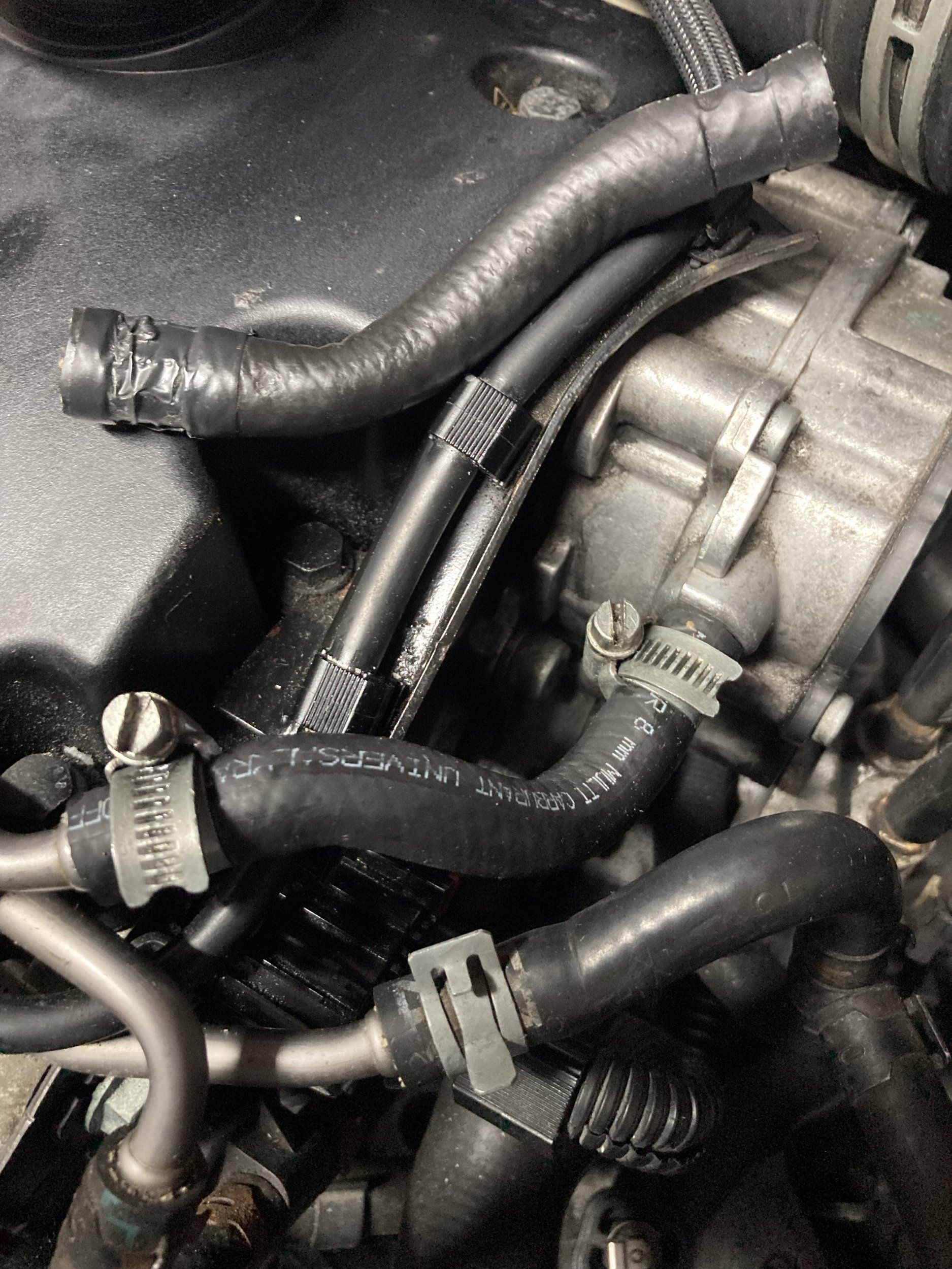

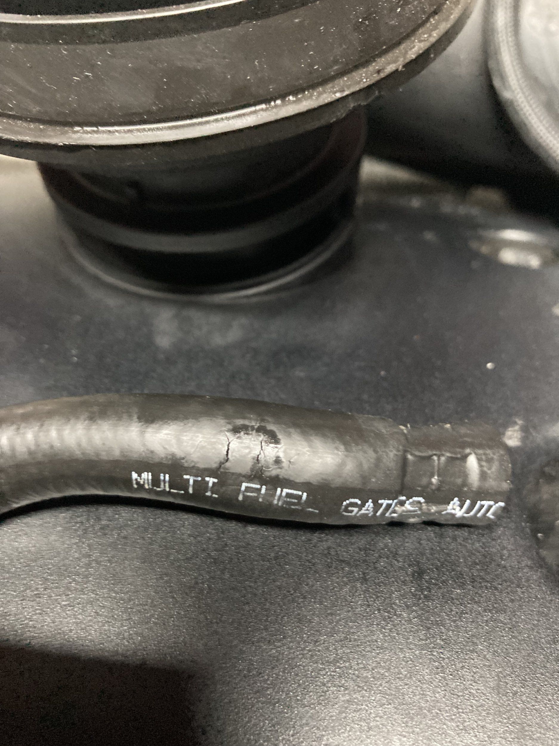

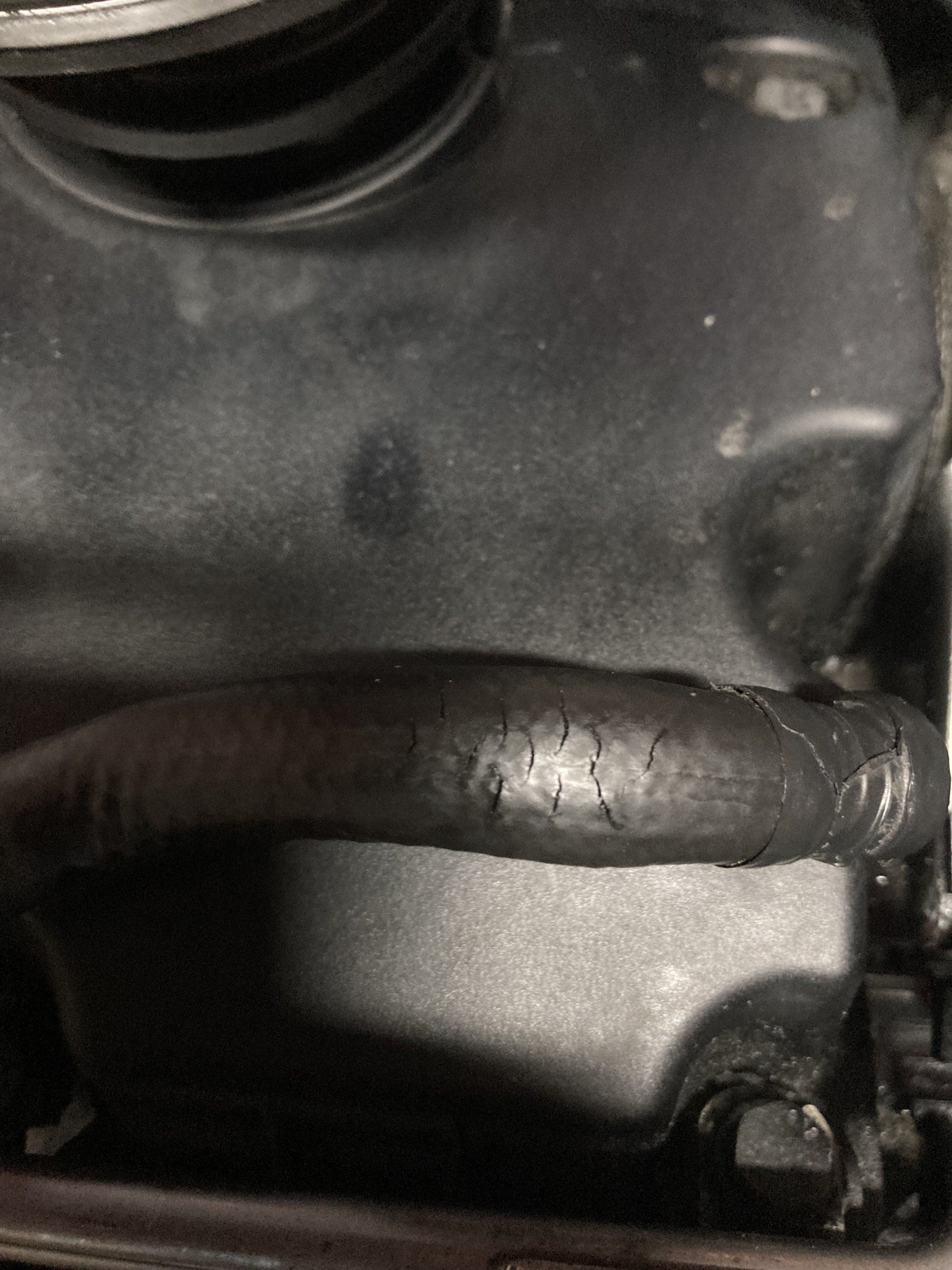

Changed this fuel pipe again I did it years ago, odd that it cracks and others are ok.. it’s also not a part you have to buy the pump.. and that’s silly money so just buy some fuel line this is gates gear, this time I warmed the fuel pipe up once on so it won’t kink slightly
