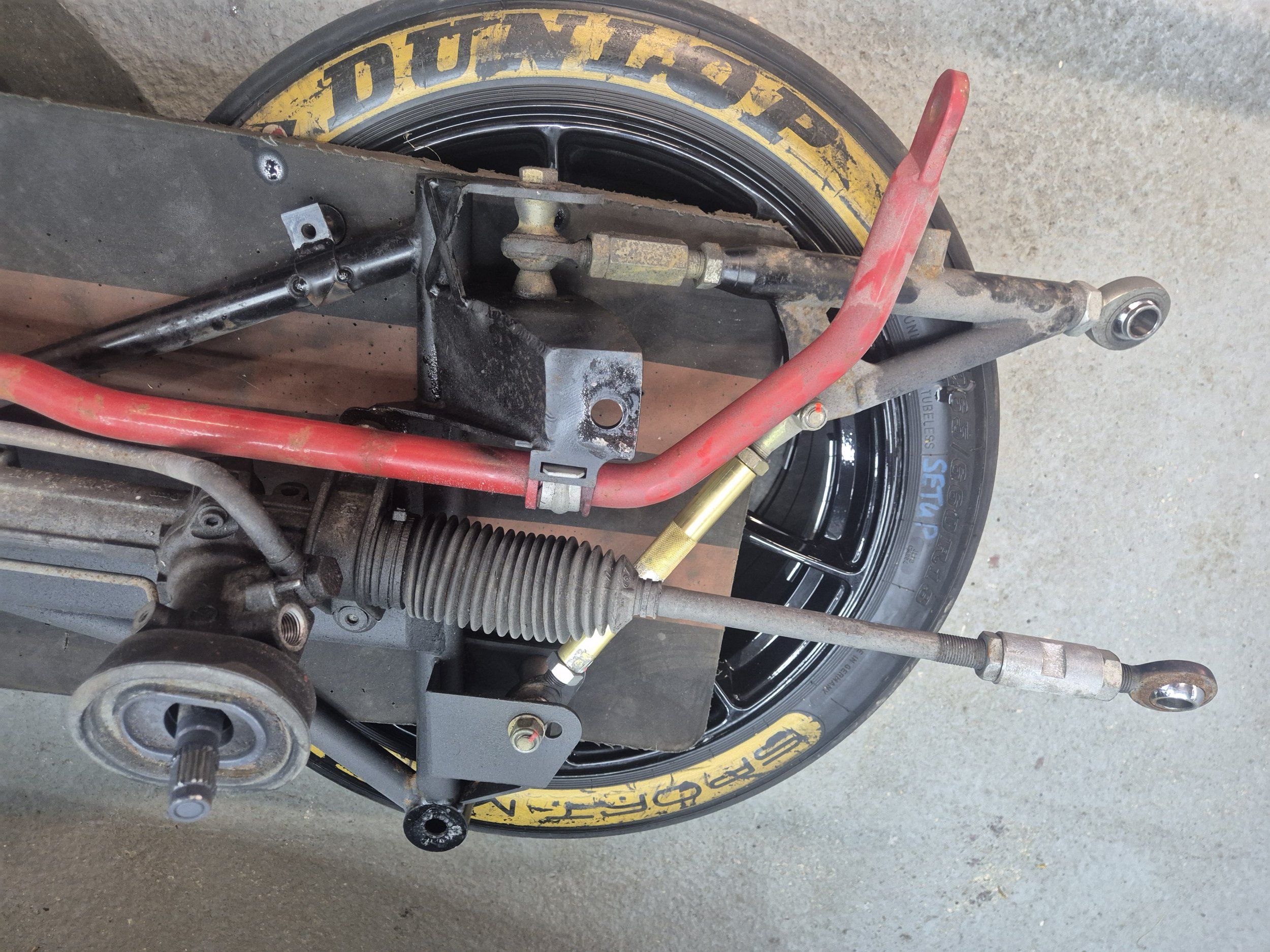

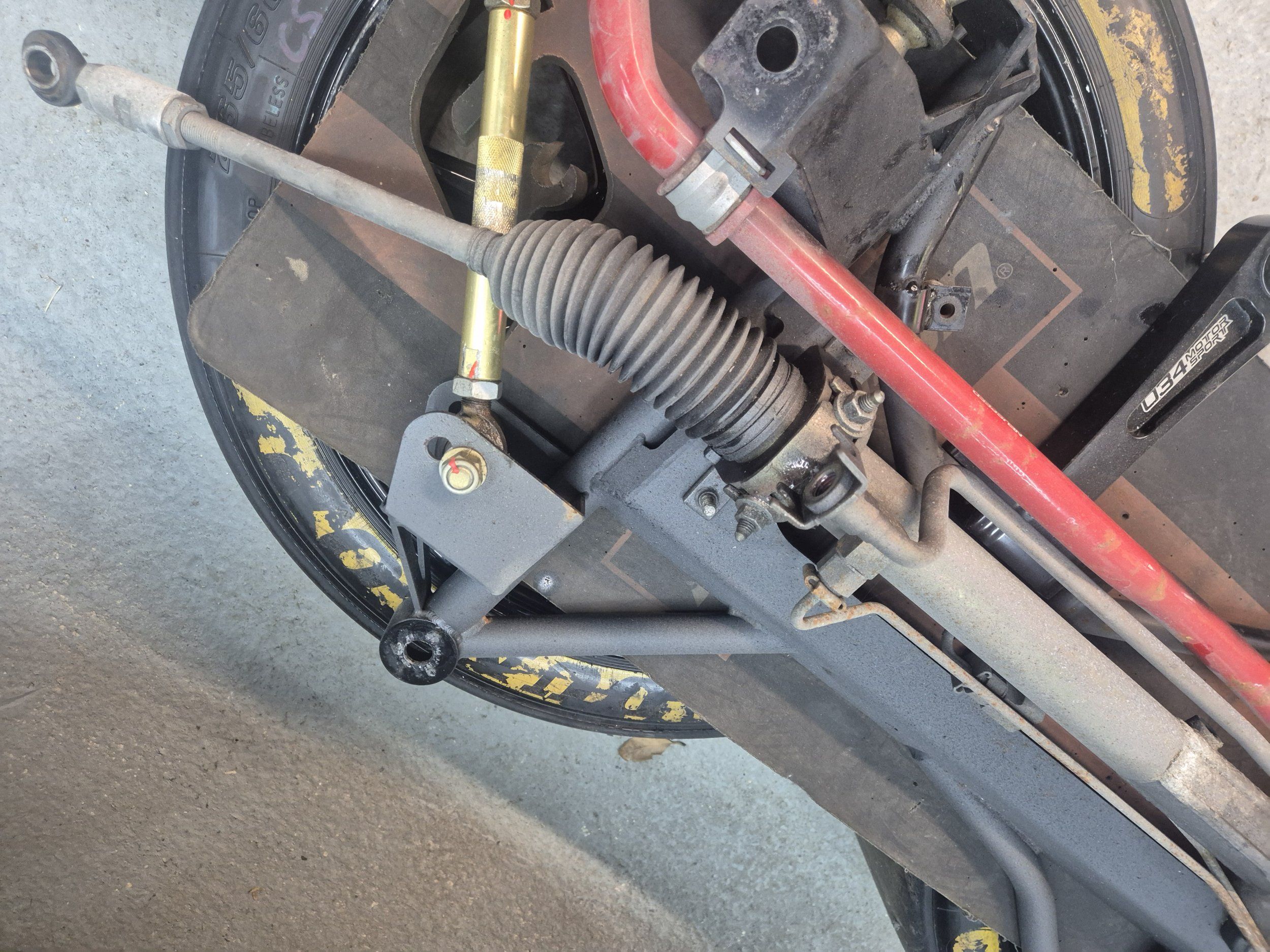

When i was getting the car ready for brands hatch. I noticed the subfram was going rusty. Only surface rust. View attachment 49566 So I pulled it out. Going to strip the arms View attachment 49568. And sand blast the lot and repaint it. Even the antiroll bar has a bit of rust spots.View attachment 49567
Considering it's never been on the road this subframe. Its a few years old but "never used" if you know what I mean. Think I just going to do it black.. unless you lot other ideas

Can't believe you're getting rust already, especially without any use. Bad show for the company providing this expensive stuff. It's annoying for you that you effectively have to do more work to something which should have been adequately prepared & treated to give it a good life span. Fks me off that nearly everything is expensive but shoddy in someway. Black sounds perfect to me btw ?

Spray them with a anti rust paint or a underseal spray

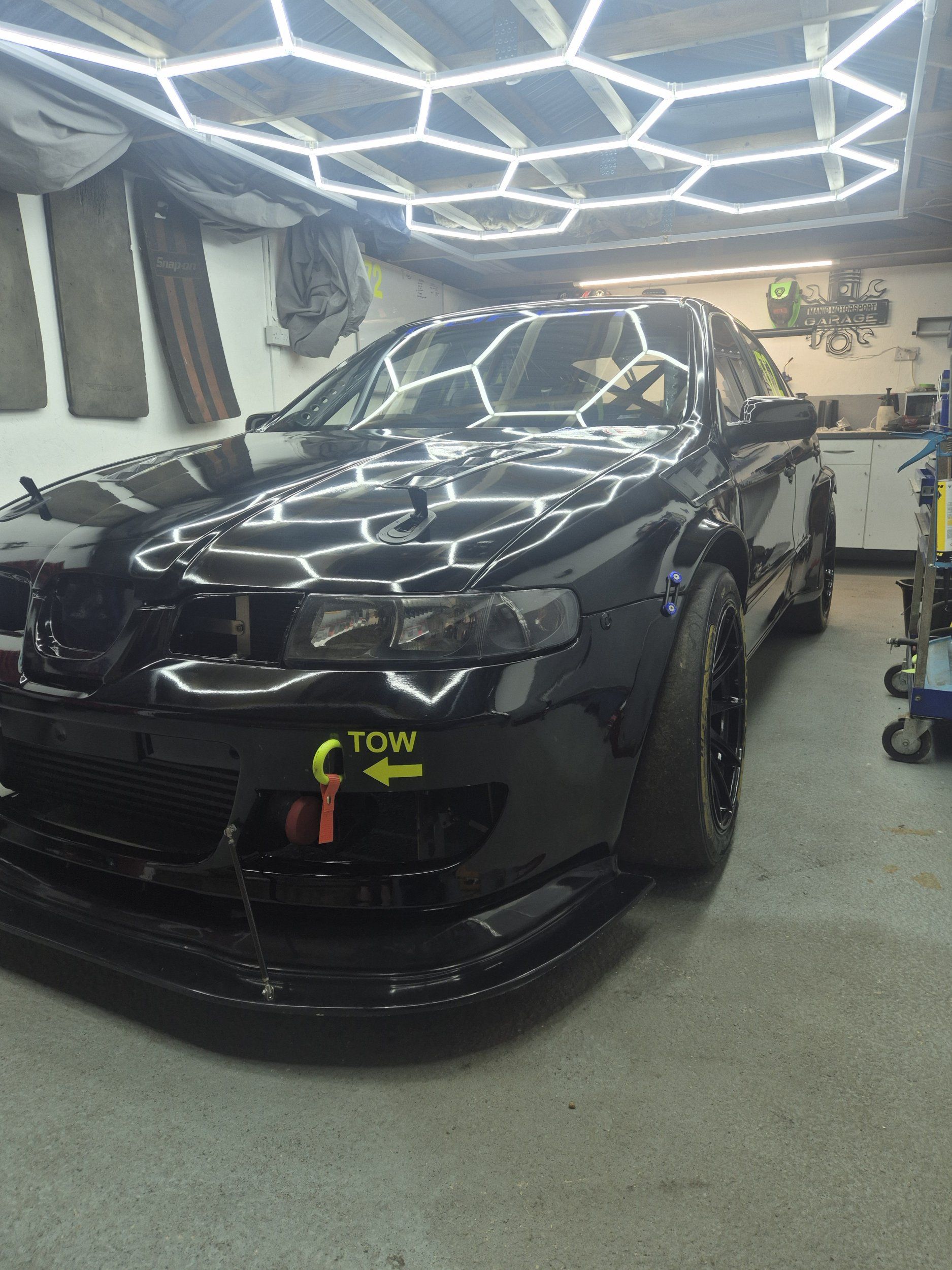

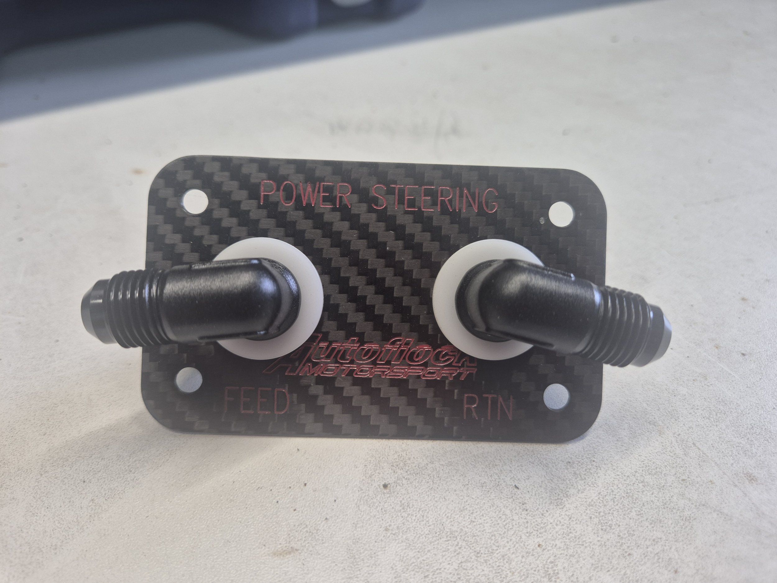

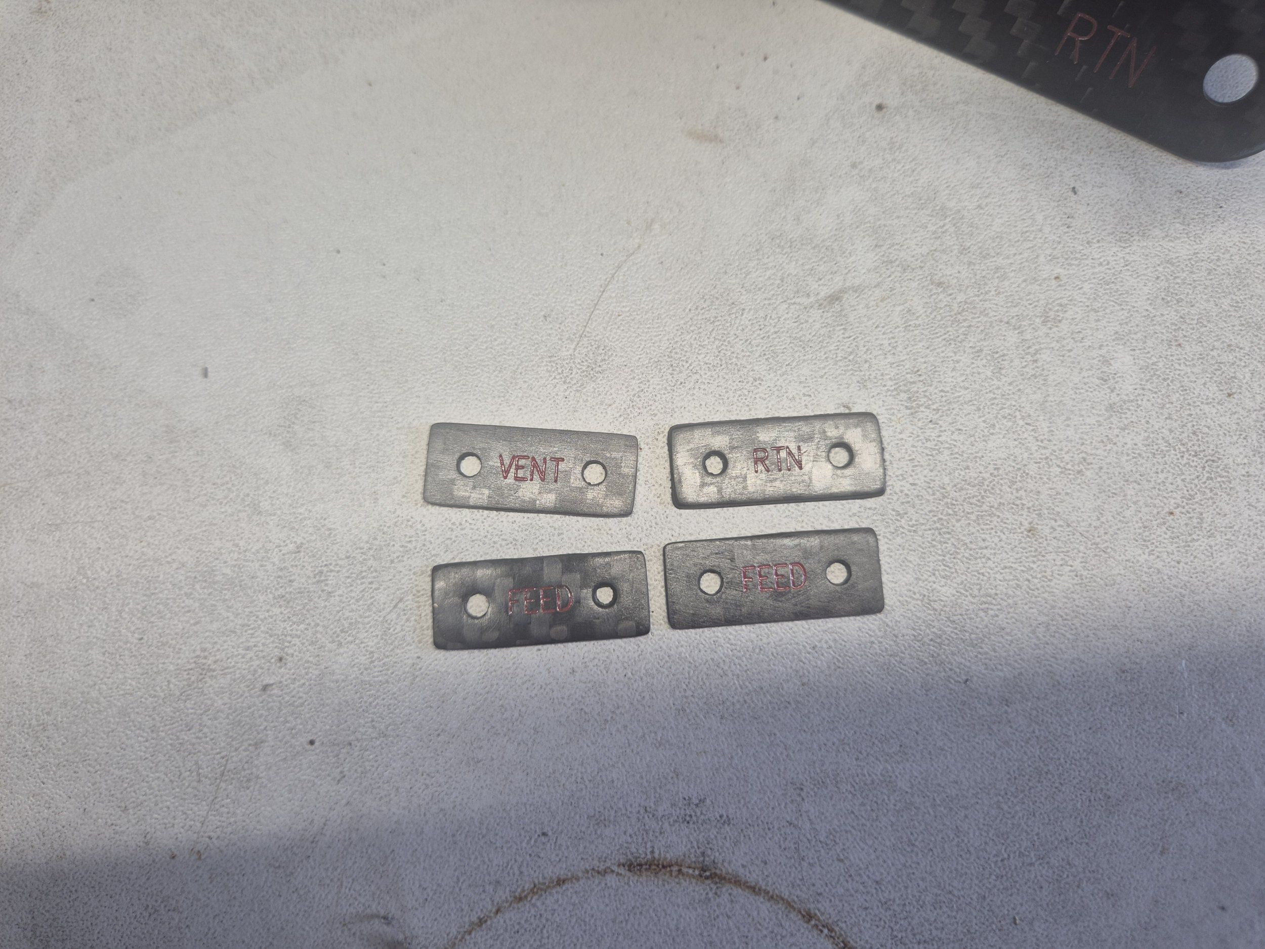

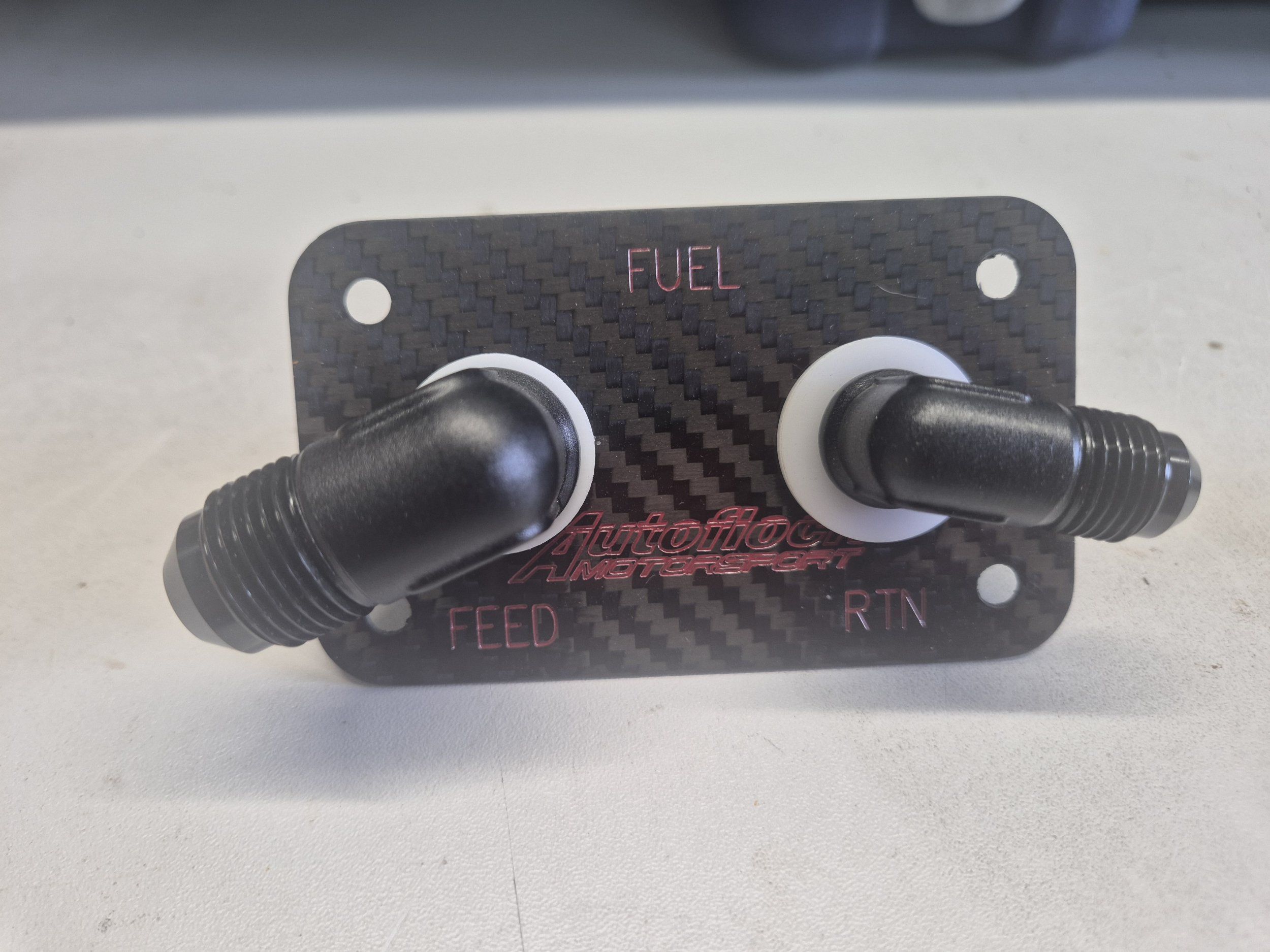

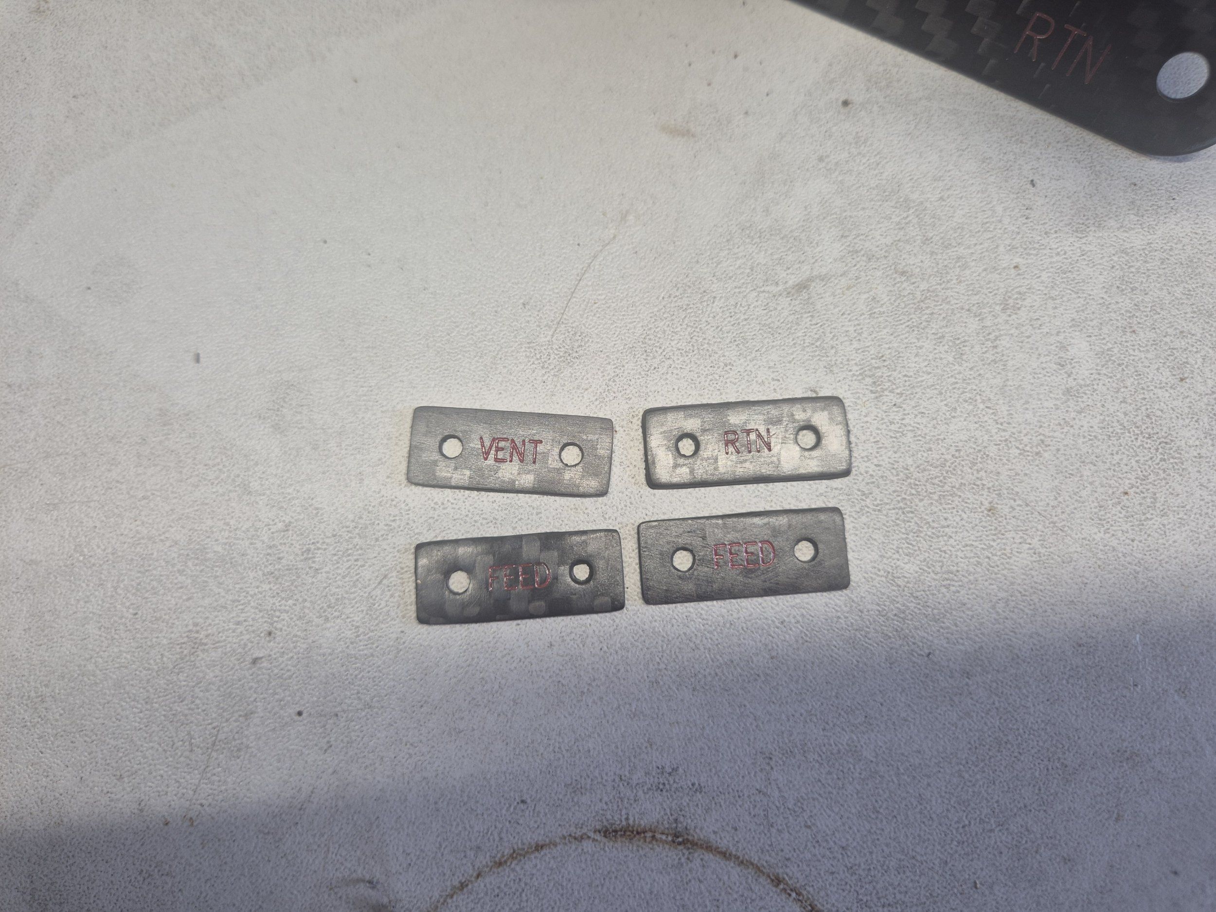

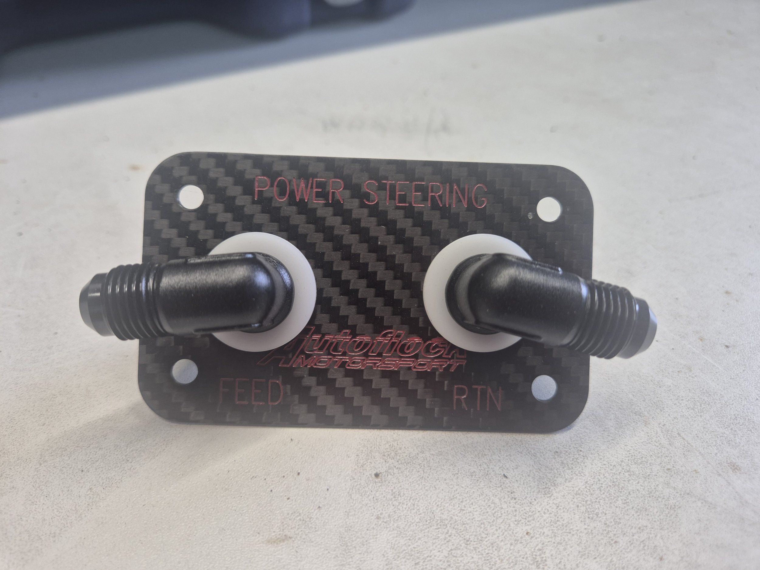

Will just leave these here and explane later...?
Car booked in for braided brake hoses next week ?
Of course this is an excuse to give it some love before Autumn & finally do the jobs that I was meant to do at the beginning of summer ?

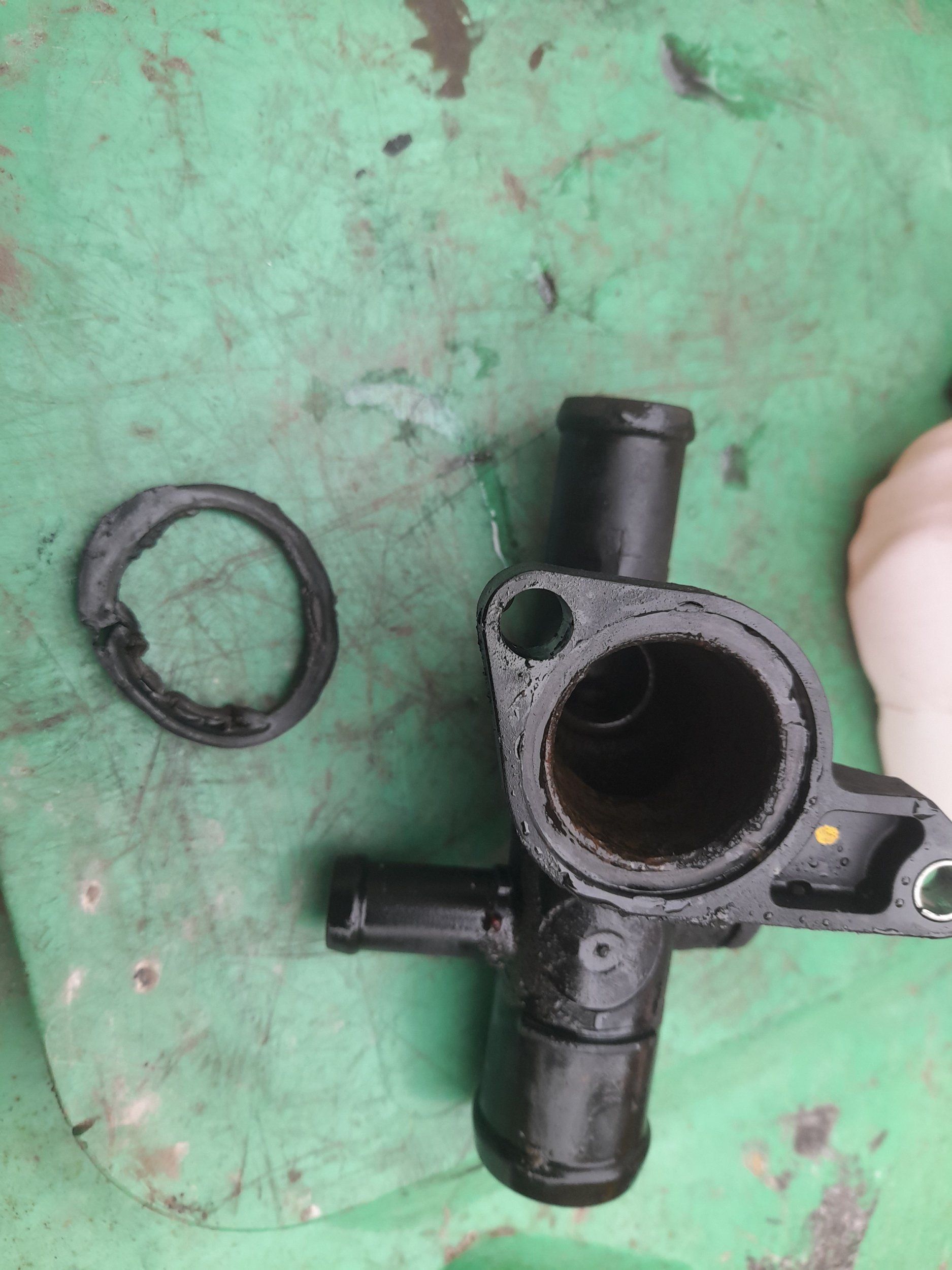

found a long standing hesitation problem yesterday, 3 exhaust manifold bolts finger tight, cranked them up and the car feels so much better, fuel trims are amazing after 50 miles on it today fluctuating between 0.7-1.5%, felt so smooth, i was over the moon, its took a year to get to the bottom of that problem and cost me around a grand in the parts cannon....... then on the way home the wife saw dripping from the front passenger footwell.....you guessed it, heater matrix leaking arghhhhhh f*** my life. started stripping it all out and got bored so will start again tomorrow, new matrix should come thursday.

looks like you did that in anger lol ... it does start to get to you though.. how many miles you on now? you should post the part number of that for future for us all
