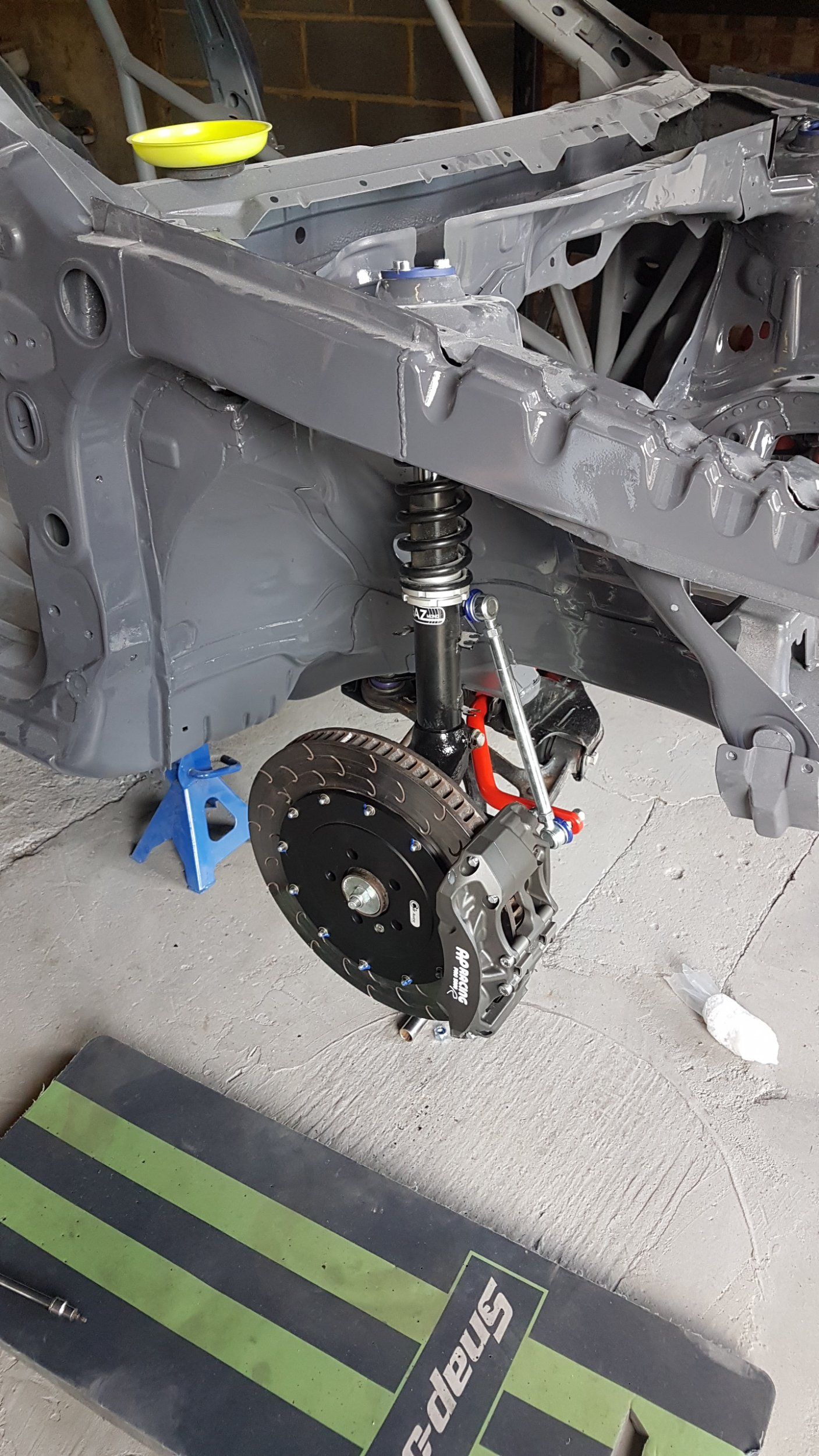

Spent hours fiddling with this lot
Still yet to find a decent way of mounting the cooler, does anyone have any pictures up close or any advice on the best way?
I’m trying to mount it directly on the bottom of the crash bar and not use any of the brackets. Is this sound? I did search high and low for some good pics but nada
