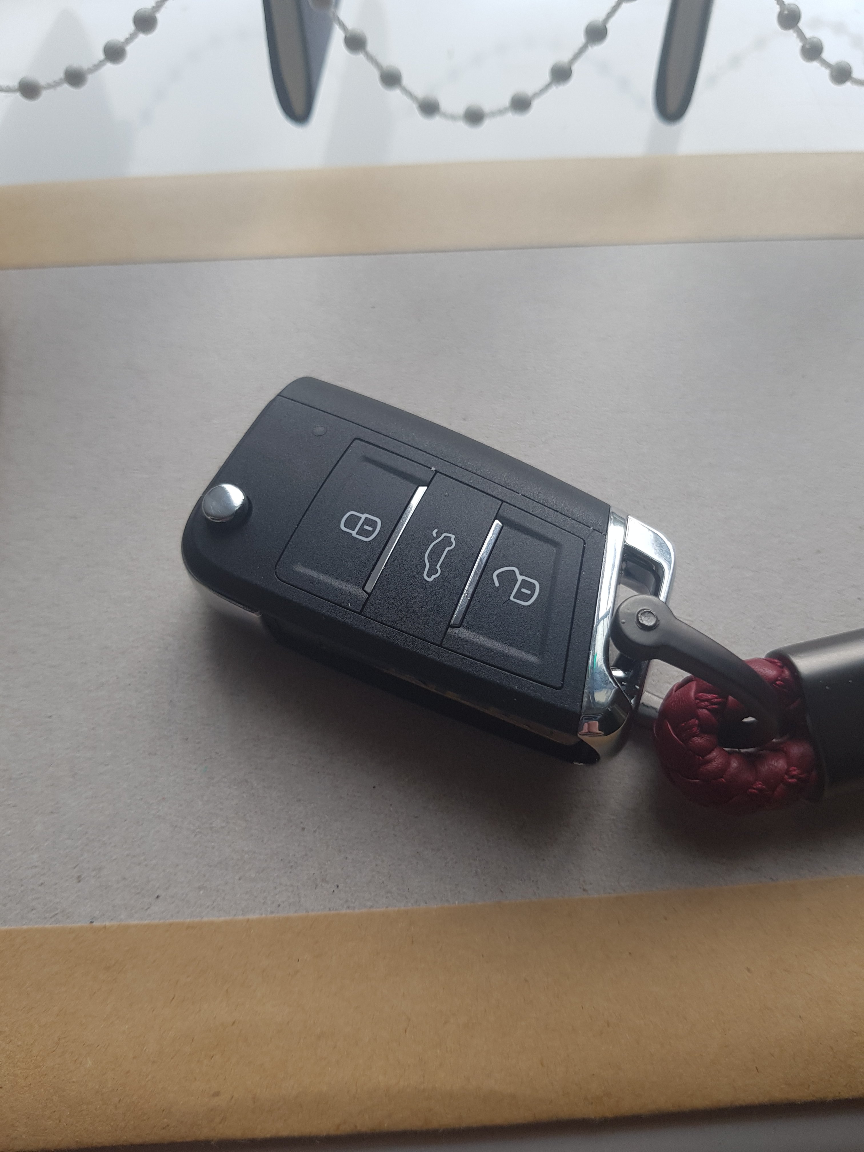

Well I treated myself and the car to a new key, done by graig nettleton, very happy I can now open boot with a button wished it popped slightly but not going down boot popper route.
