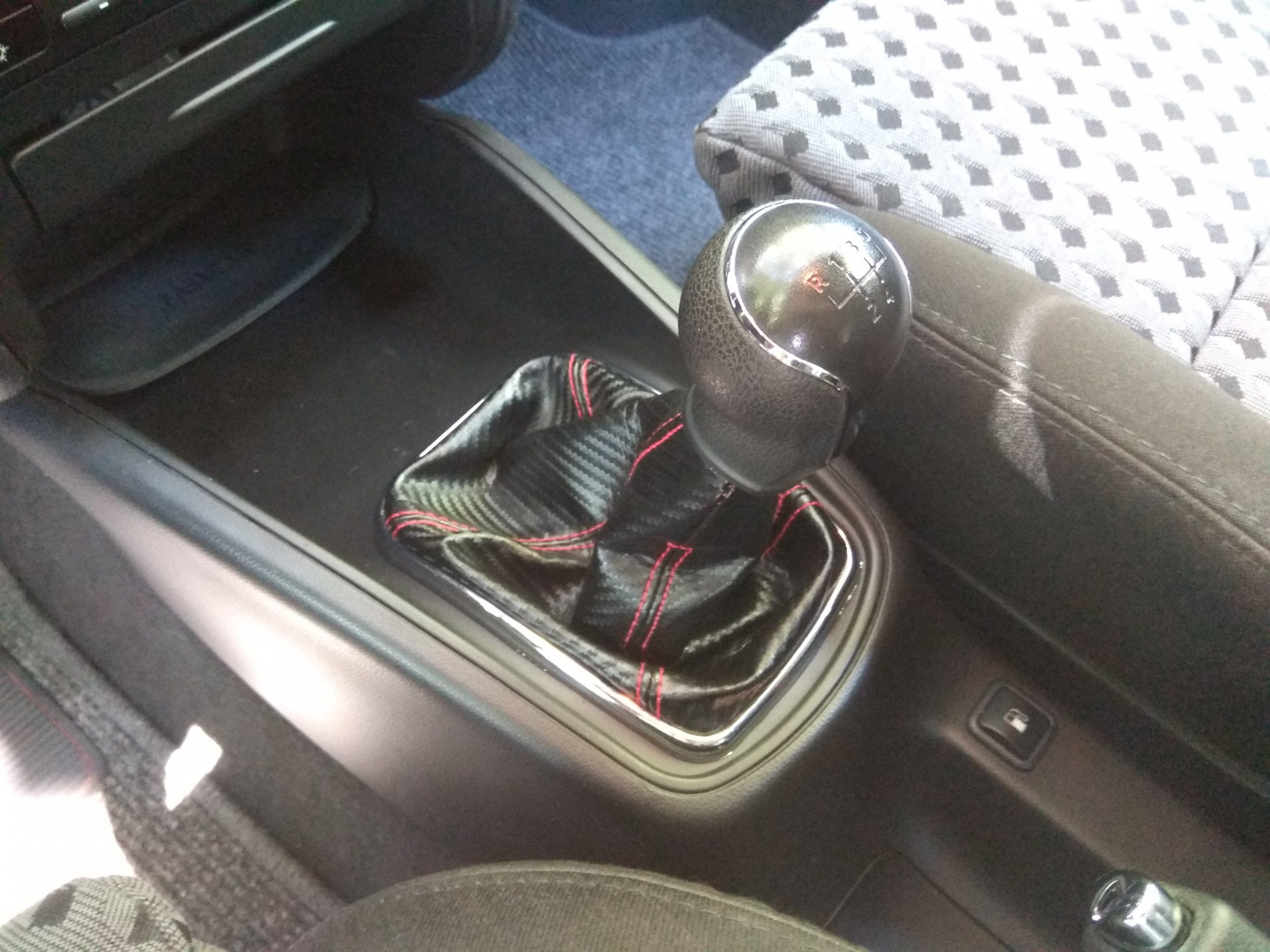

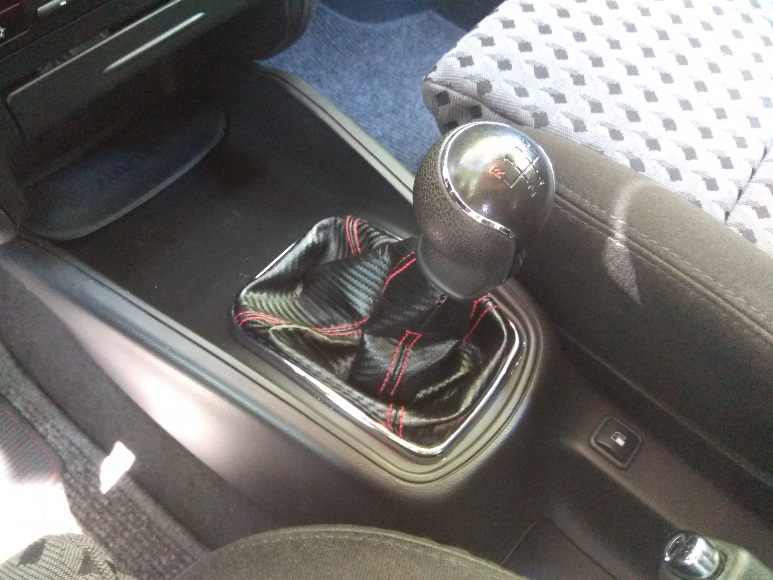

Got a fancy Seat Sport Carbon shift knob and a nice little shifter boot haha . Don’t like the blue though
love your knob mate :p
