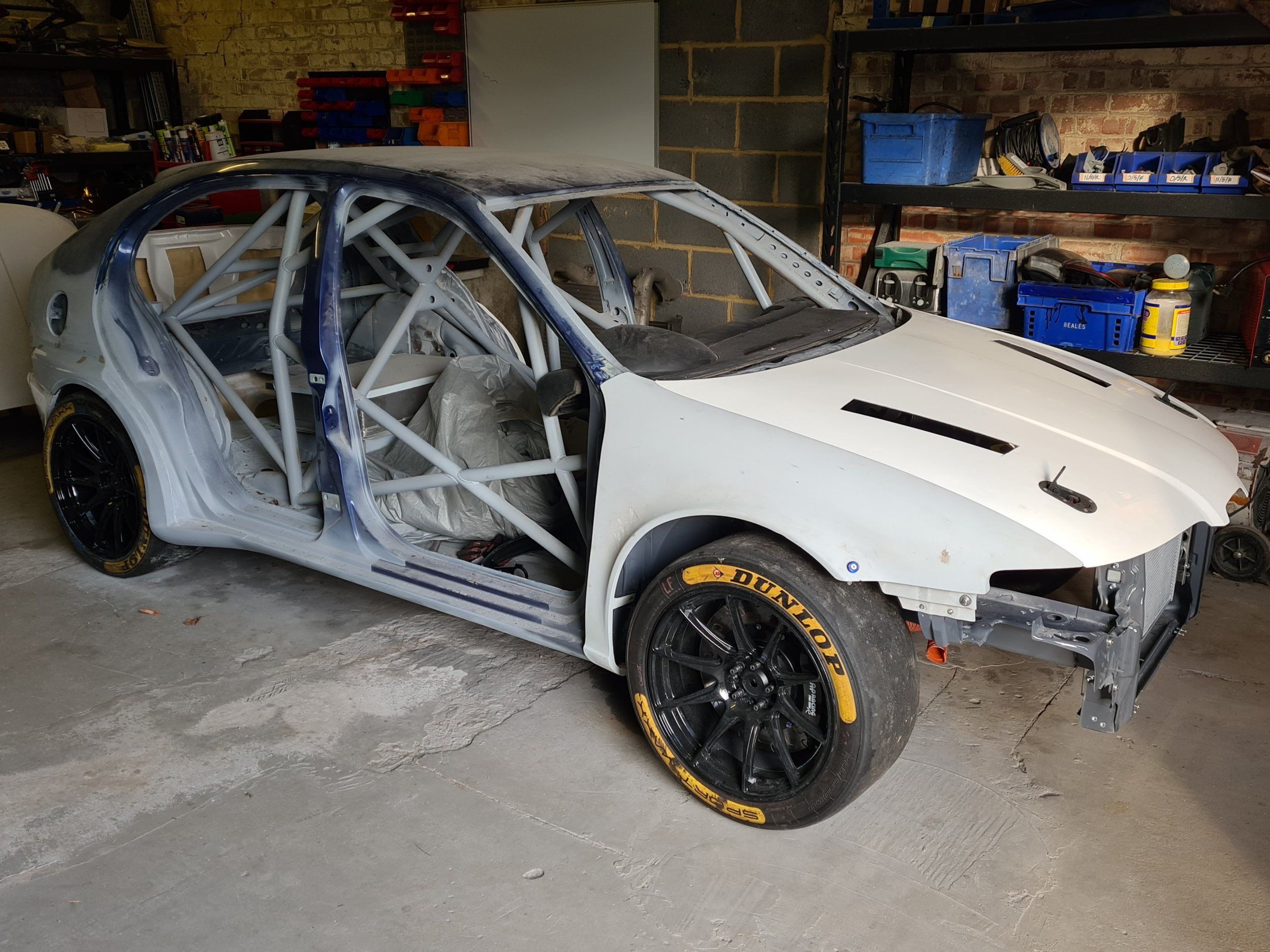

Had a tidy up and a move about . Had to put the wheels on . Oh she looks nice...

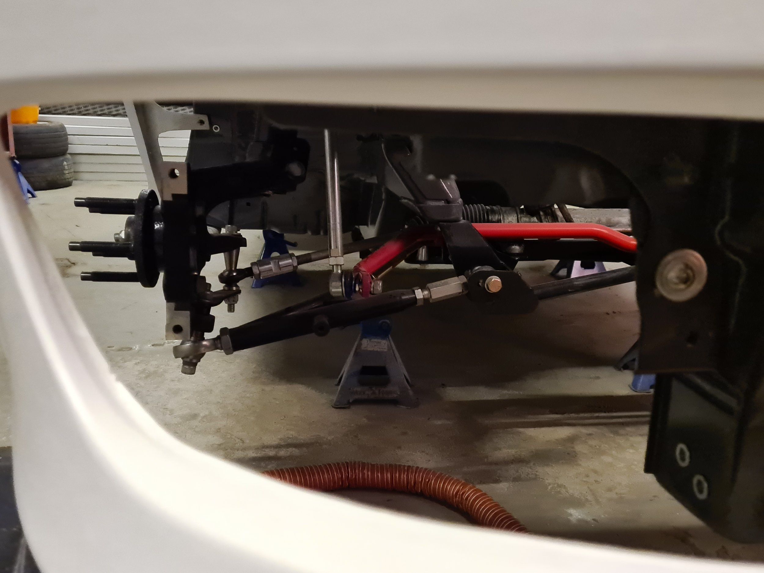

Had a nightmare with the coolers as the bumper curves. So having to have a rethink on the lay out and the positioning. . But nice view threw the old fog light hole.

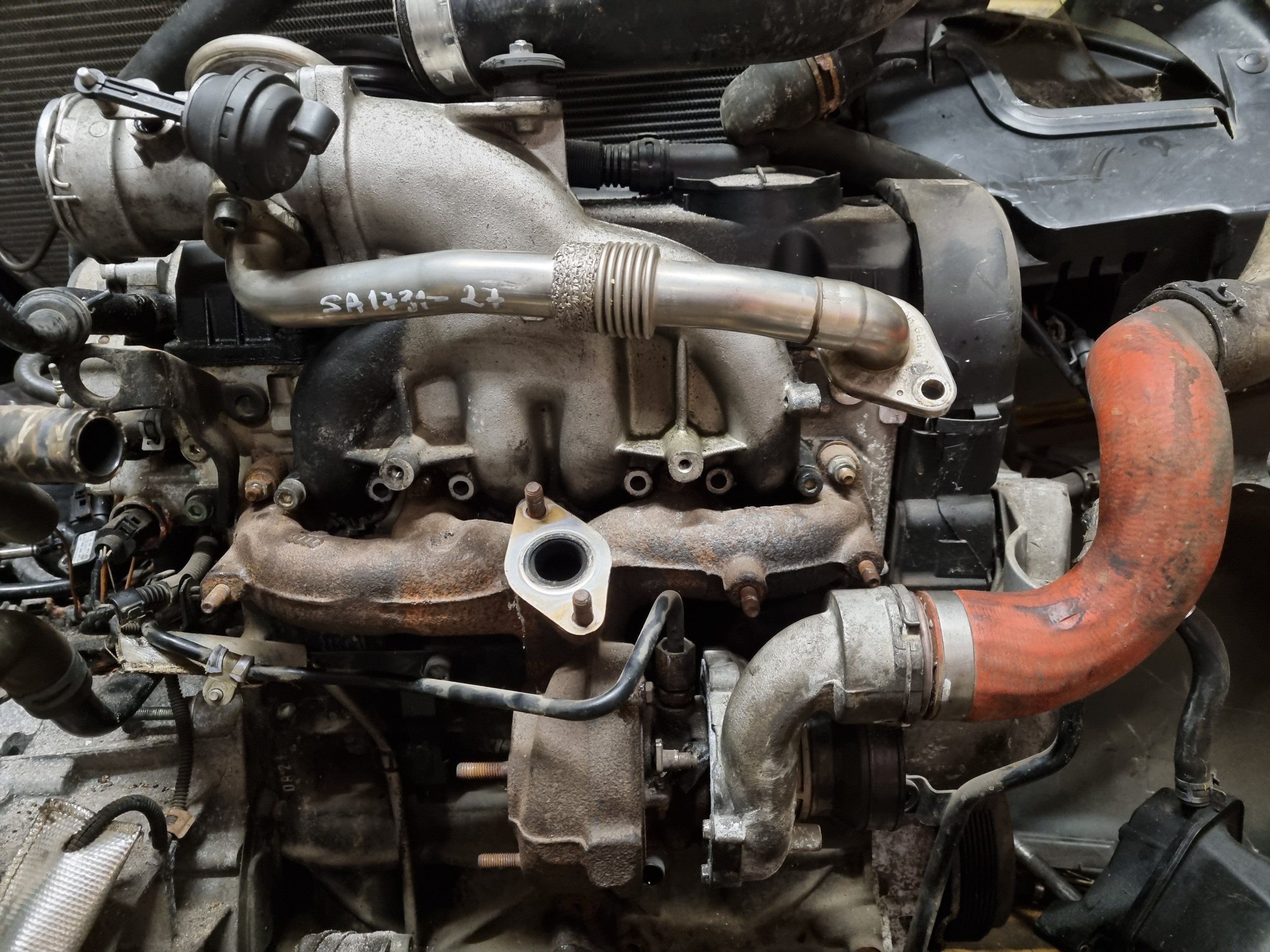

Joys of having spares to experiment with

Is that intake on back to front or is this a different engine from the normal PD150???
That messed with my head too. Turbo is in the right place but would imagine the intake pipe to EGR valve would be facing to the right if we're looking at it from the bulkhead side.
So, my post caused some confusion... my evil plan worked! Muahahaha!
Anyway, taking the bolts out of the inlet manifold was an absolute doddle, access is an issue, but a 6mm allen bit worked beautifully.
Yes, it's a gearbox facing inlet manifold rather than the standard one. Also, the turbo inlet has been clocked.
Some re-plumbing going on in the future then?
