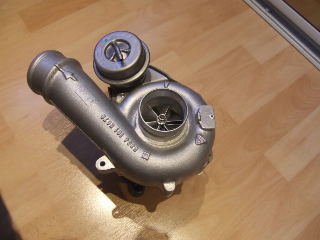

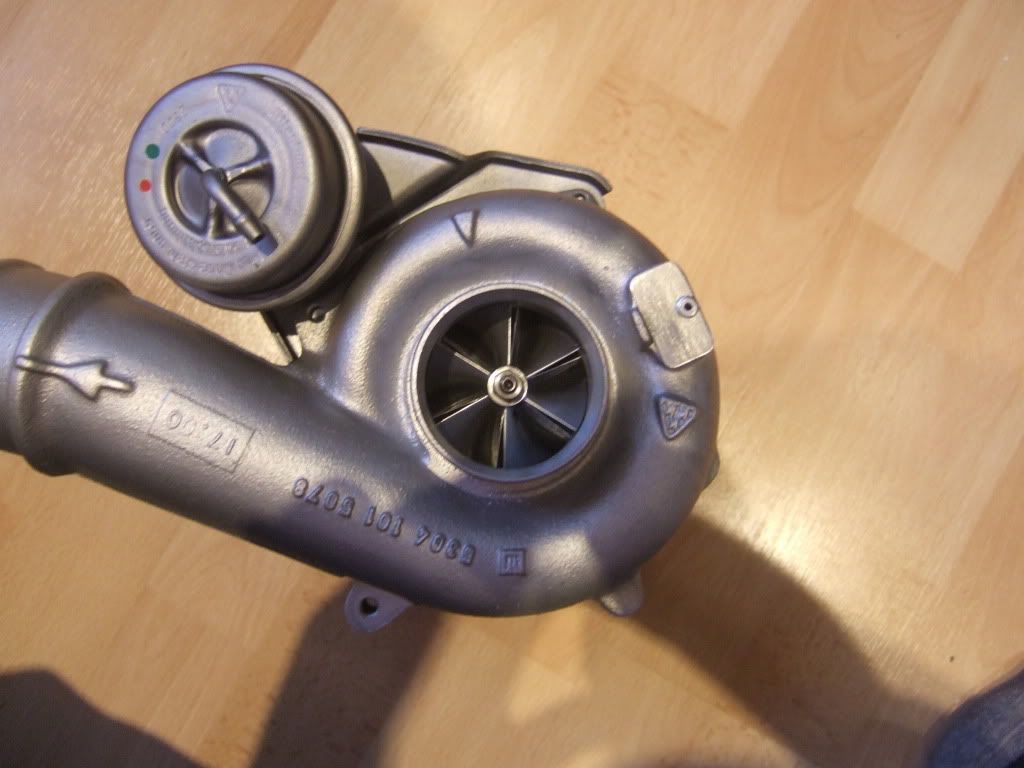

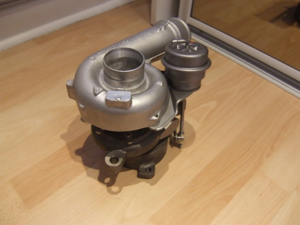

Had a bit of a suprise today when my turbo arrived. Must say CRT have done an amazing job looks brand spanking new!
The suprise was I think its a hybrid...
EDIT:
After contacting CRT to get my full spec turns out I have-
. New turbine housing with enlarged & ported wastegate
. New Standard Turbine wheel
. Uprated thrust bearing & stepped gap seals
. Billet K06 compressor wheel with coldside machined to suit
. New KKK actuator

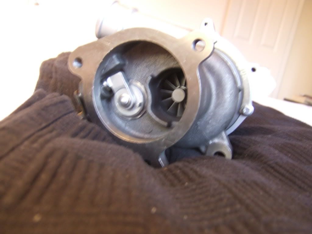

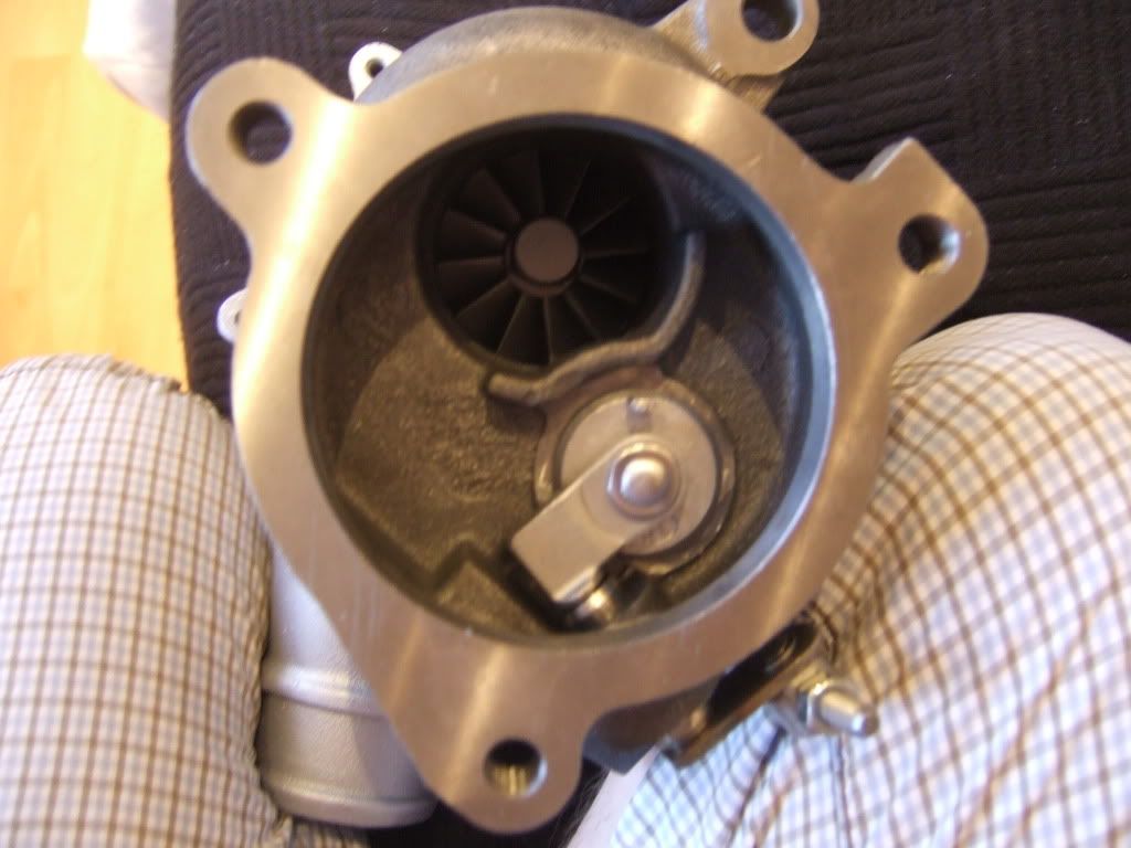

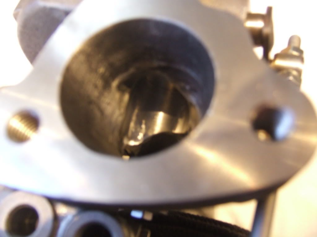

Machined coldside with what looks like an rs6 compressor wheel
Machined wastegate port with a new wastegate and actuator
Machined hotside with what looks like a bigger turbine wheel..
Be a bit of luck if it is!

Bang on if its a hybrid and you didnt pay for hybrid lol
I cant tell by looking at it myself but at least you can get the ball rolling now!

Progress ko4 hybrid seat Ibiza is that a first? remember bill saying about a ko4 hybrid s3. Running silly power. Let's hope you get this up and running ok mate.
Im not sure actually mate I think there may be one already, Im going to have to put a very tame map on it untill I get rods I think.
Should be interesting though!
. New KKK actuator

mate fair play thats a hell of a job im not brave enough to do that myself! safty first good idea changing the rods so is it a k04 hybrid or not???
Jul 4, 2010
2,170
Cambs
Yeah it is mate got the spec from crt the other day, K06 billet compwheel & enlarged coldside housing too fit, ported and enlarged wastegate uprated seals thrust bearing ect.
. New KKK actuator
Chinese turbine housing.
*check the threads are full depth vs the bolts which will go into them*
*check what pressure the actuator arm start to open at* - with std KKK actuator it would be 5psi, which will not be sufficient to cope with the "overported" wastegate. It will blow open.
Inconsistent as ever!
