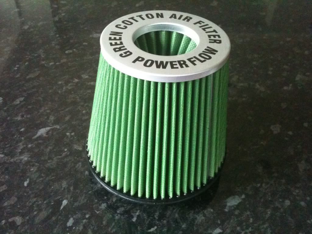

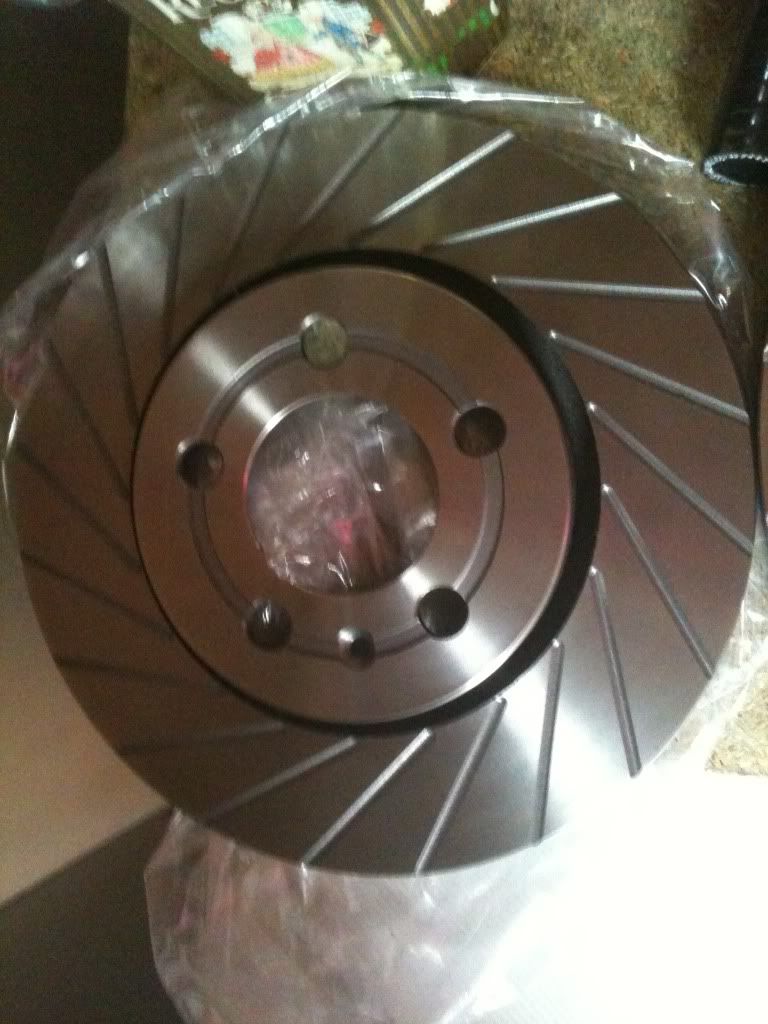

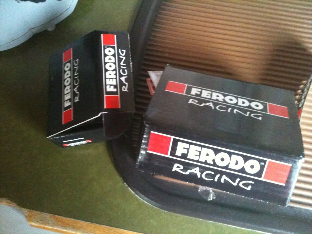

Well i got back off holiday this morning, had a lovely time in tenerife apart from the 3 hour delay. But im home safe now. I came home and was greeted by a few new goodies. All my new brakes had turned up, CRN grooved disks with ferrodo DS2500 race pads all round and my new green cotton filter :)

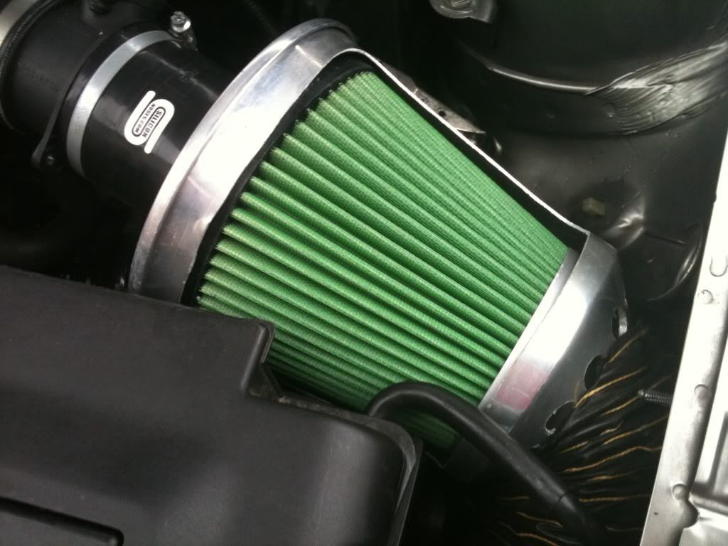

Ive already fitted the new filter, perfect fit, just got to do the brakes in a bit as i cant drive the car atm as the brakes are grinding. Here are a few pics ;)
New filter
New brakes
There gunna eat those pads for breakfast mate lol how much were the disks
Haha, hopefully not lol. But i have been told that these discs are very good and have had very good feedback on them. Discs and pads all round were £350 delivered mate :)
i use to live in tenerife brad las amercias. and ive got them disc from crn they been on well over a year and there bang on.

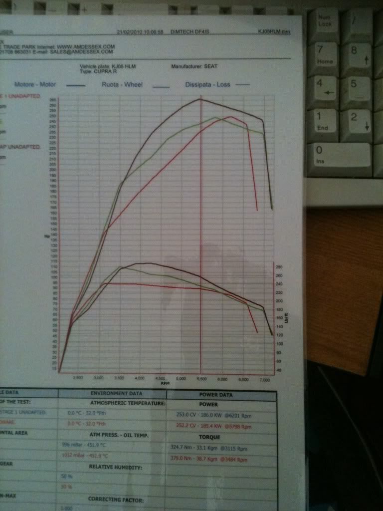

Stage 2 remap
Well yesterday i had the stage 2 map done on my car aswell as new spark plugs and 4 bar FPR. In the graph below you can see the red line is the stage 1 map when i got it done back in june, the green line is from yesterday with all the mods ready for stage 2 still running the stage 1 remap. Then the brown line is the stage 2 remap. From just adding mods like fmic and decat exhaust when running a stage 1 map, i gained 40ftlb torque and it holds it a little bit better towards the red line. Well the stage 2 map has totally transformed the car, it holds boost loads better through out the rev range and when up in the higher rev in each gear there is just so much more pull, it just wants to keep going. The torque holds much better aswell and you can really feel it. On the dyno it made 268bhp and 291ftlb. Ben said the LCR's dont seem to dyno that well for some reason, but its a totally different car now with stage 2. I also did a couple of logs when i got home and got a reading of 212.9g's on a few runs which is equivalent to 276.7bhp :)
