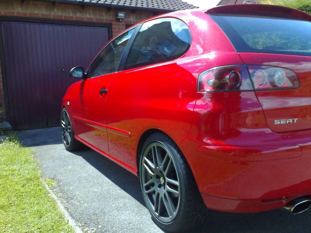

lol proper, yeh by meet time will have it fitted as soon as I can fine a decent exhaust centre and rear ARB will try and fit this myselfhopefully!
Wheels darker sounds like a plan yeh get some pics up![]()
