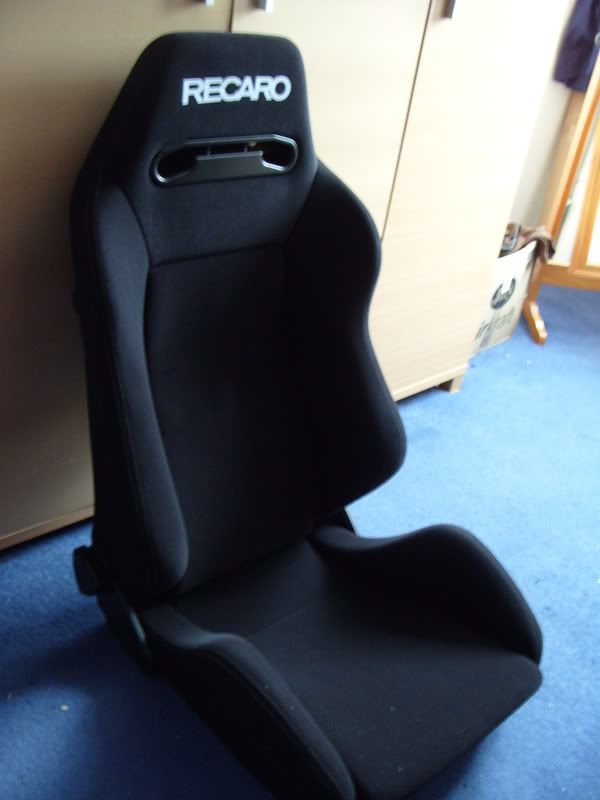

My seats arrived this morning.
They're already back in the box as they won't be fitted for a few months yet.
I've also sold my Odyssey battery to be replaced with a bigger one at some point.
Hell yeah! I checked some trainers on and ran down the drive!
Just got them sitting in my room now, along with the harnesses and the rear bench seat! Haha.

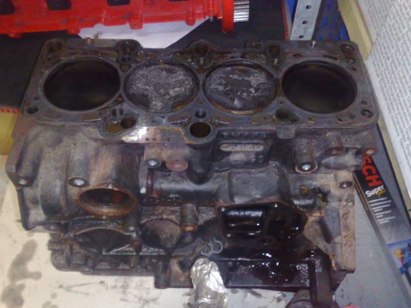

Thought i'd add a quick pic of the current state of play with Martin's car, i've been at work today pulling the bottom end apart (this is all new to me so i'm learning again and having fun whilst doing it)
No1 and no4 bores are slightly scored but apart from that everything else looks okay, it's going off monday to be inspected by a proper machine shop so will hopefully know what we're into by the end of the week
how longs it going to take to rebuild then?is everything going to new when it gose back in?
All depends on what needs replacing, it's getting uprated rods at minimum but depends what they come back with once engines been inspected, if it needs pistons it's probably going to be a while.
Once all the parts are together i would hope a couple of weekends would see it running again
