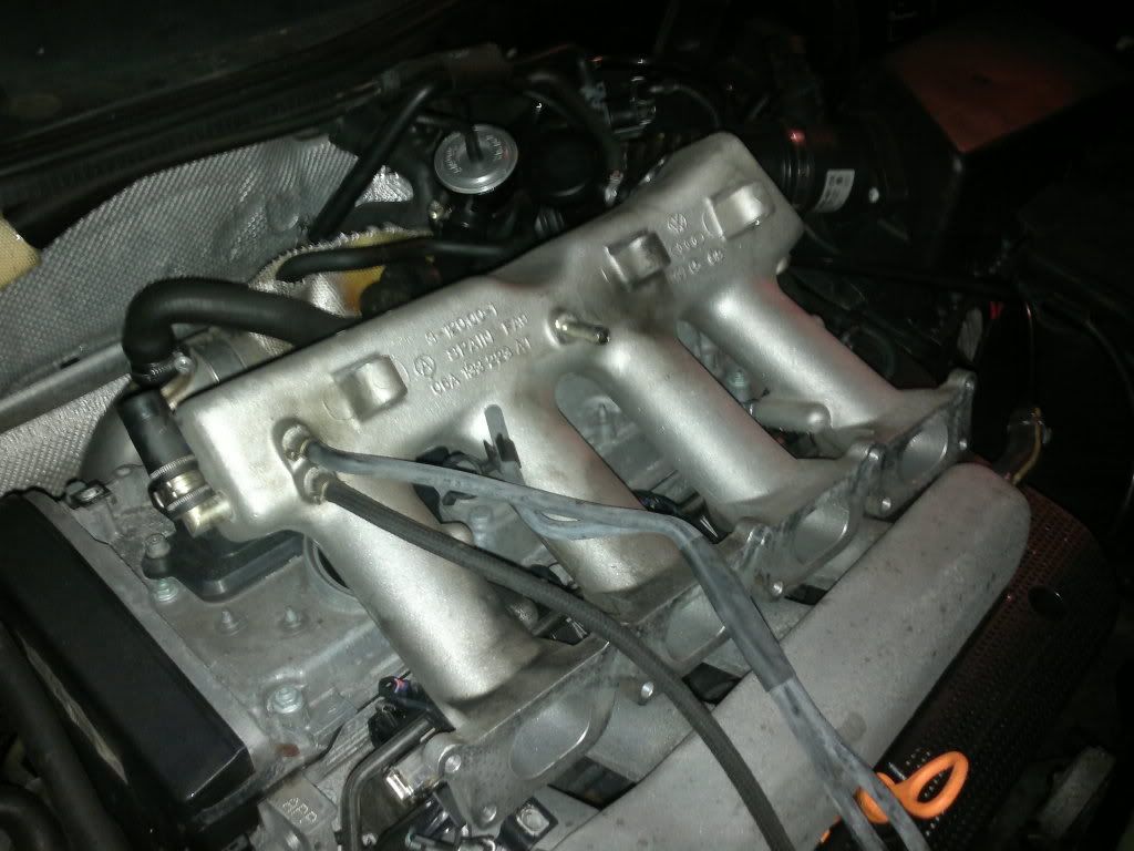

this is the underside of a spare LCR manifold on the picture, this way i get better picture. you can see the 2 small hoses on the left. i have one of those hoses running to my recirculating diverter valve (the other hose is on my car running to the FPR).

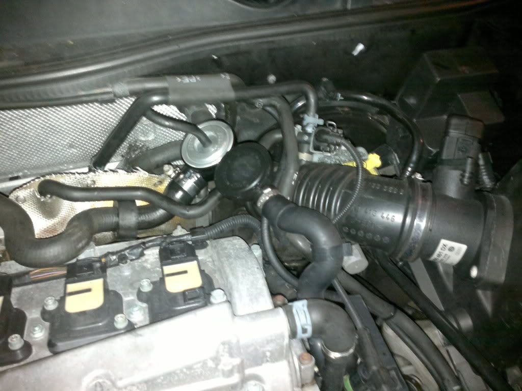

here you can see my APR R1 recirculating diverter valve with hose coming from the manifold
and it is one hose without any other connections, from the manifold all the way to the diverter valve. i just used small black cable ties to fit the hose around the engine bay.
if it is any help i also did the N112 delete (SAI pump and SAI combi valve), and removed all the hoses and small metal vacuum pipes.
